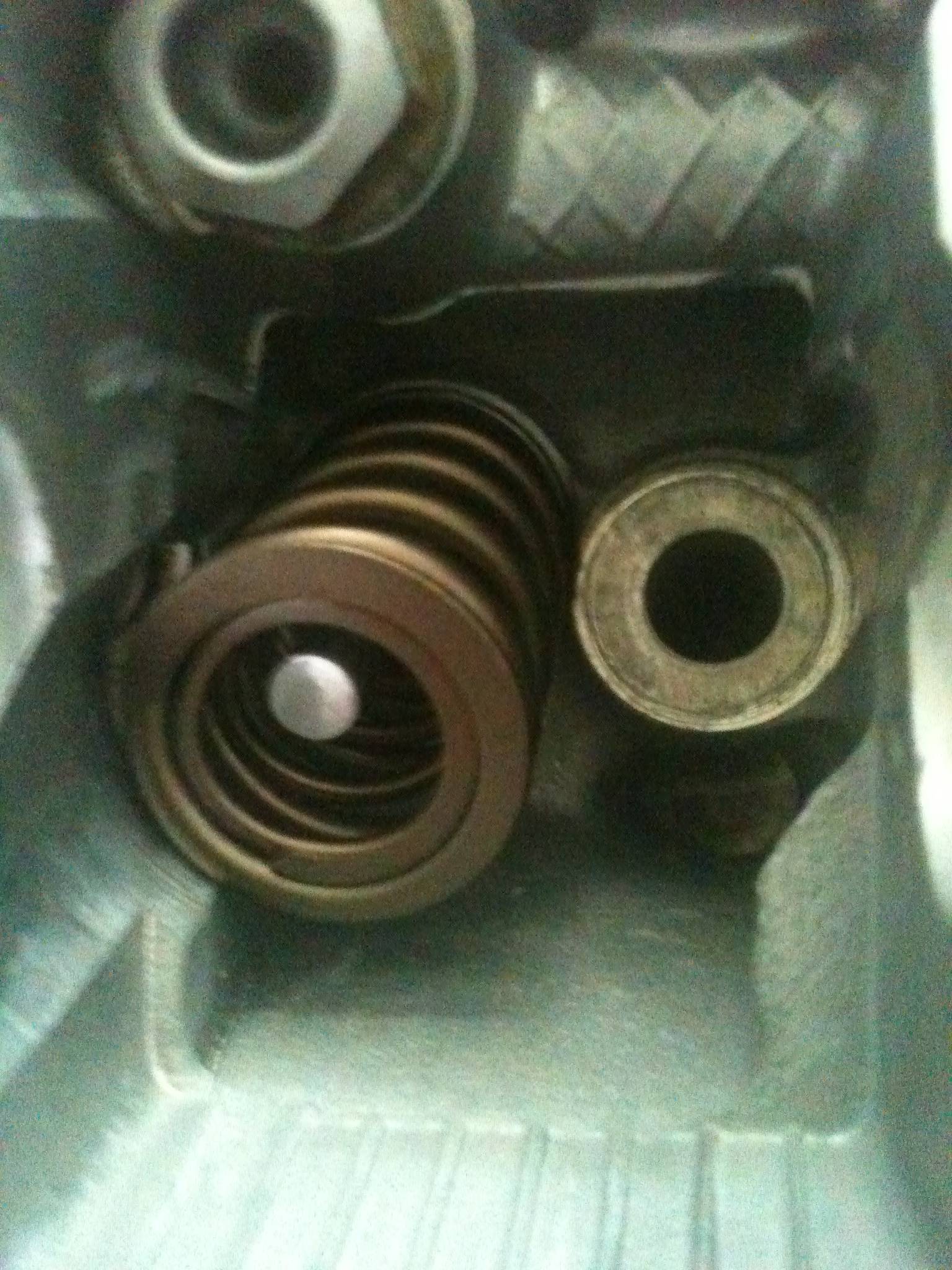

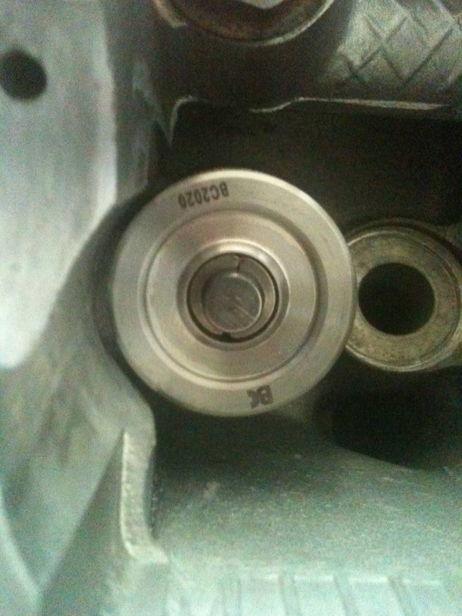

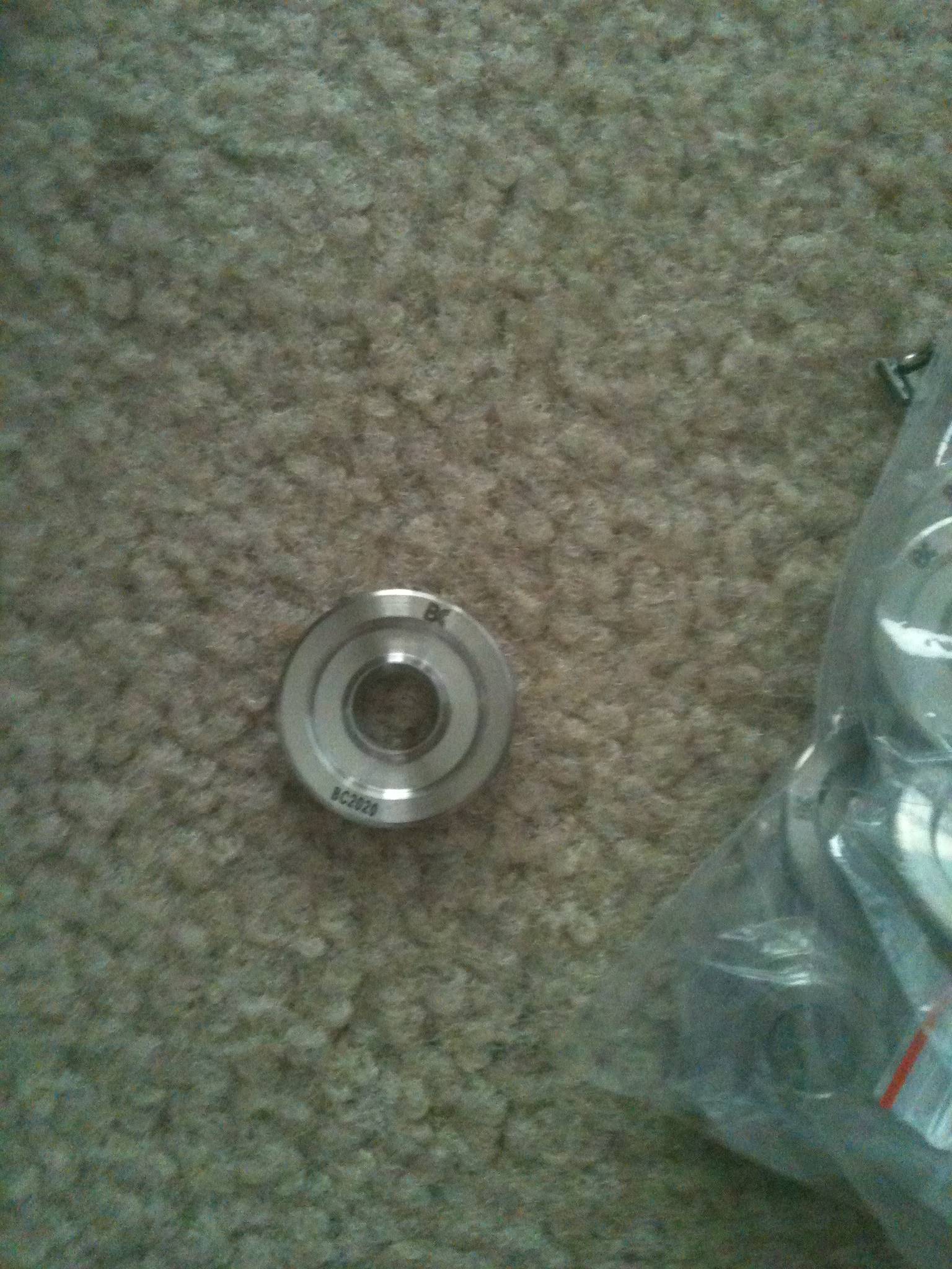

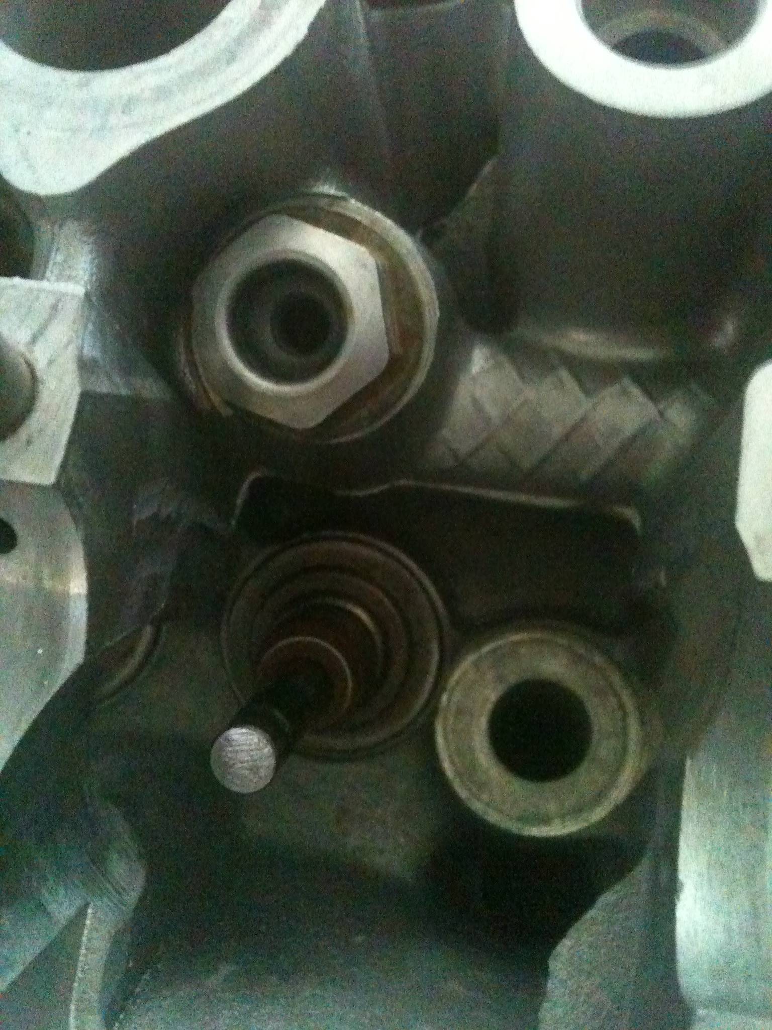

Now for the installation of the valves, valve springs, and retainers.
Brian Crower Titanium retainers
Viton valve seals
Lisle valve spring remover/installer Brian Crower dual valve springs
Starting the install
Brian Crower is in the head :beer:

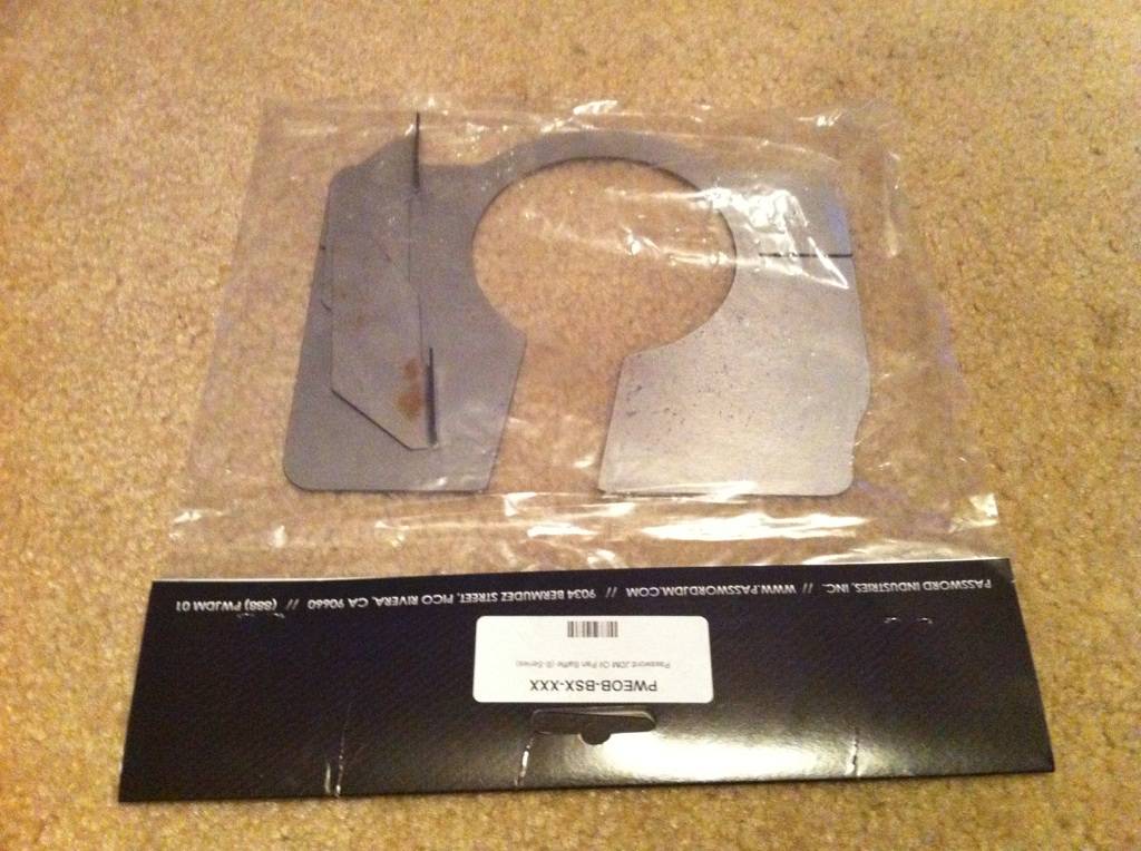

Anyway I promsied a picture!
It has rained all day so I didnt want to spray the gasket sealant in this humidity so the head still isnt on but I did get this.
Password JDM weld in oil pan baffle kit lol
Not a big deal but another piece to the puzzle. I will be dropping this off with my friend to get welded in this weekend.
