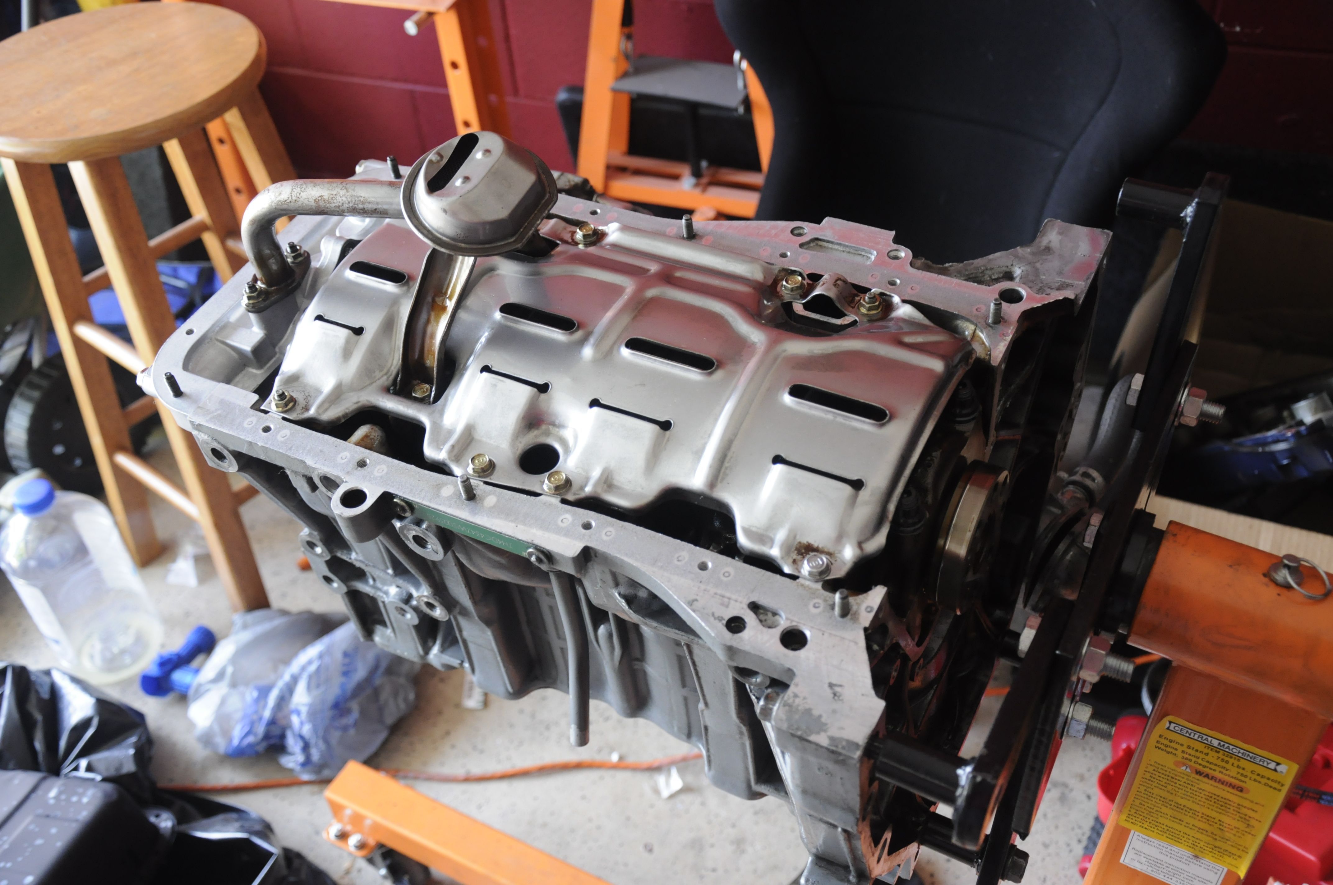

Updates as promised.

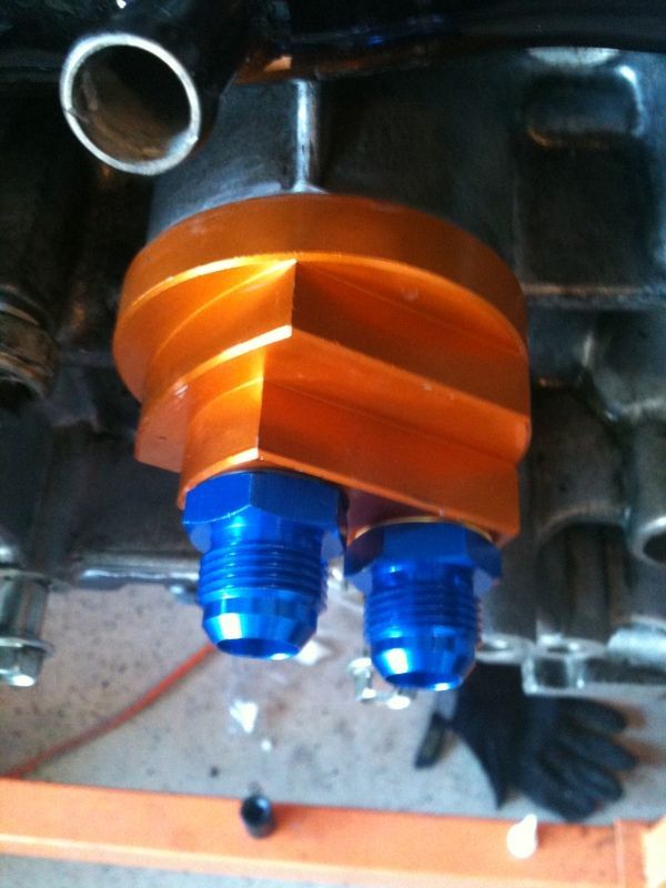

Yellow thread seal tape (gas and oil)..this stuff is thick!
I used it on the fiittings for my chinese oil cooler kit.

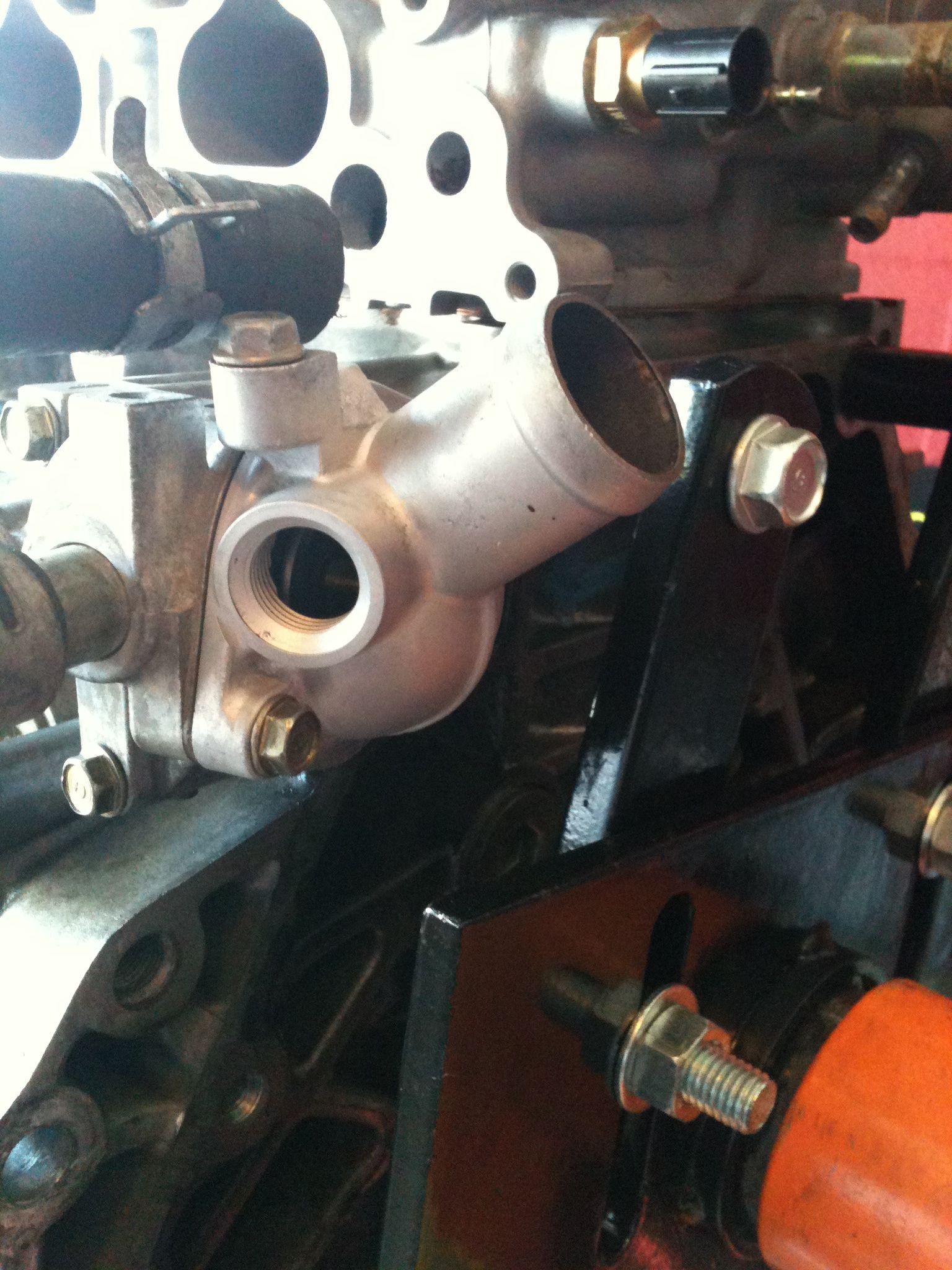

New thermostat
I bead blasted the coolant neck

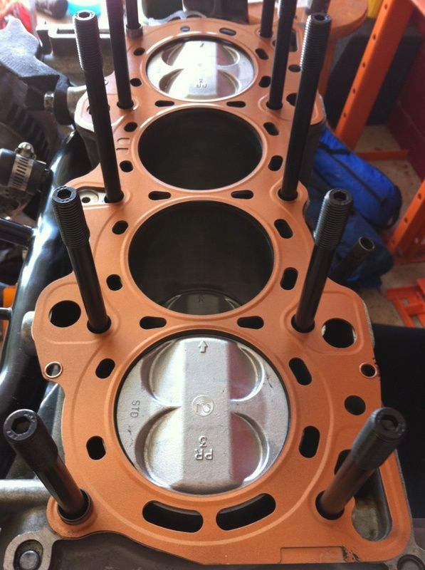

I always use copper spray gasket for all of my builds.

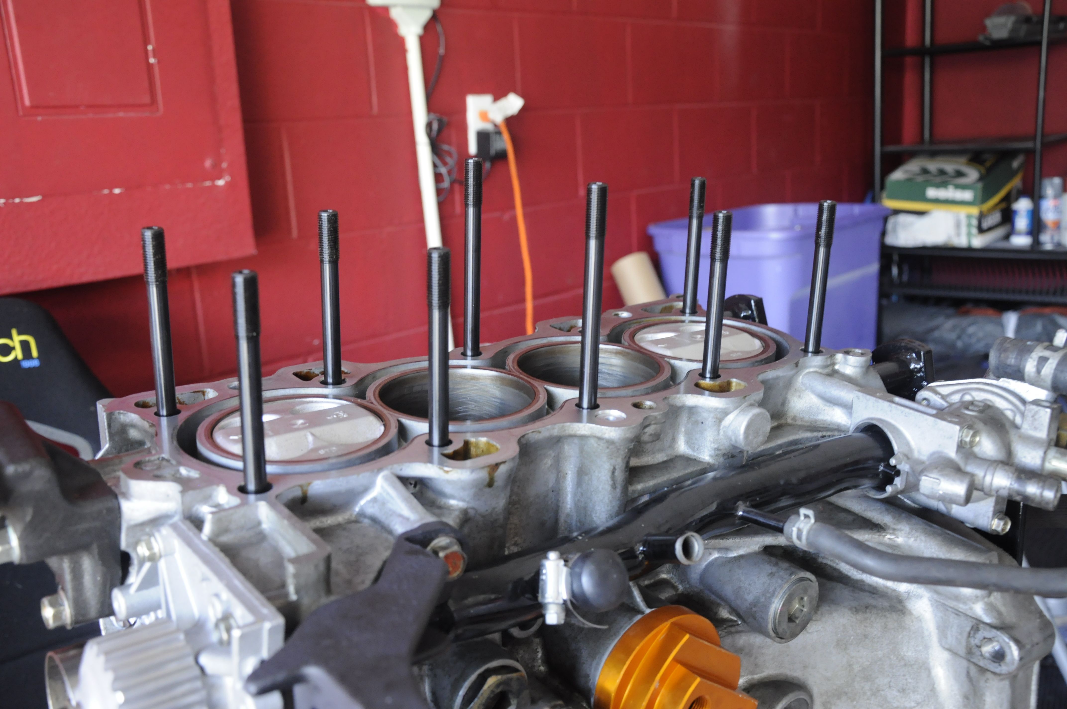

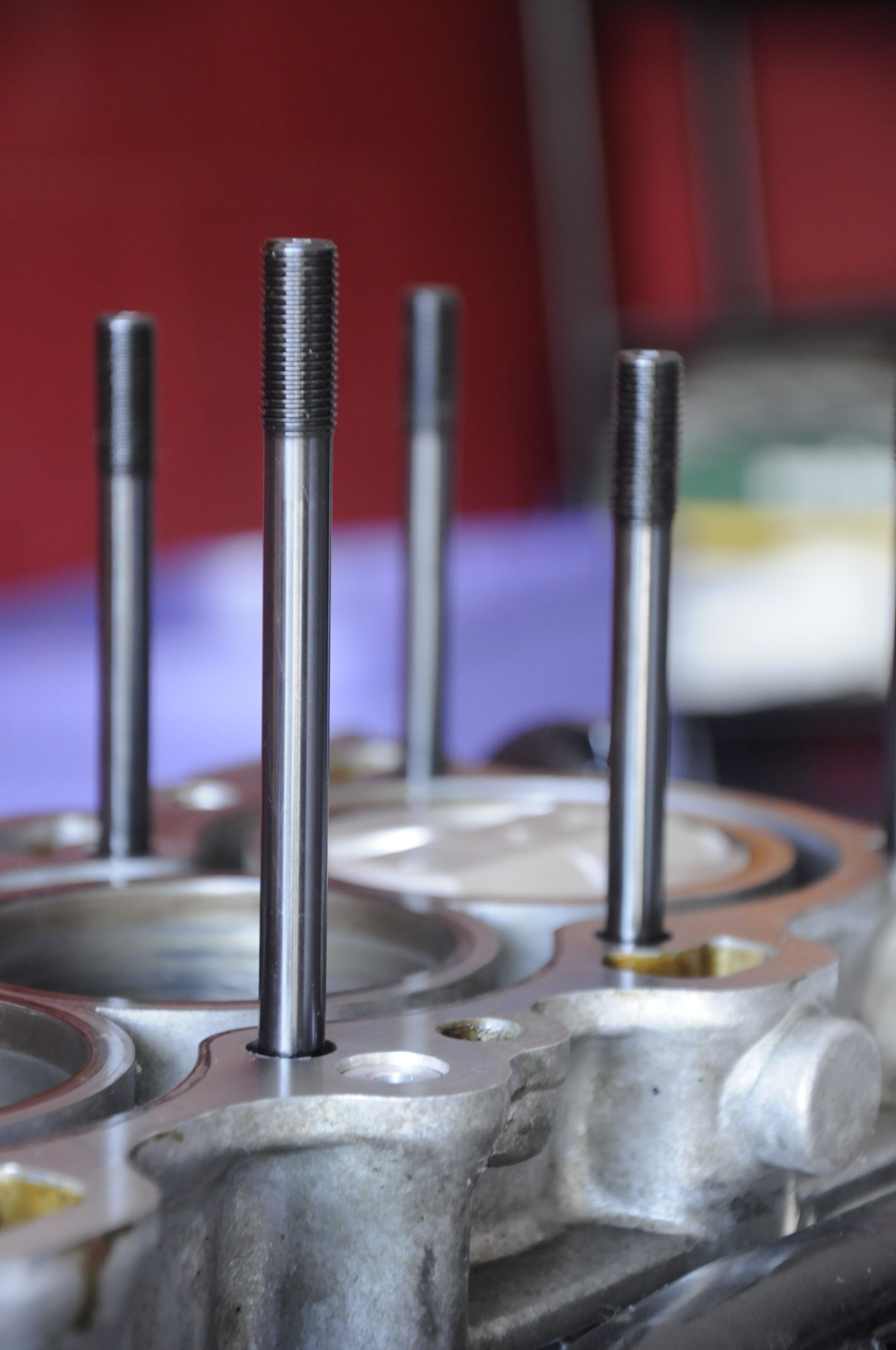

Head dropped on
Bolted down using arp studs in this sequence per Honda.

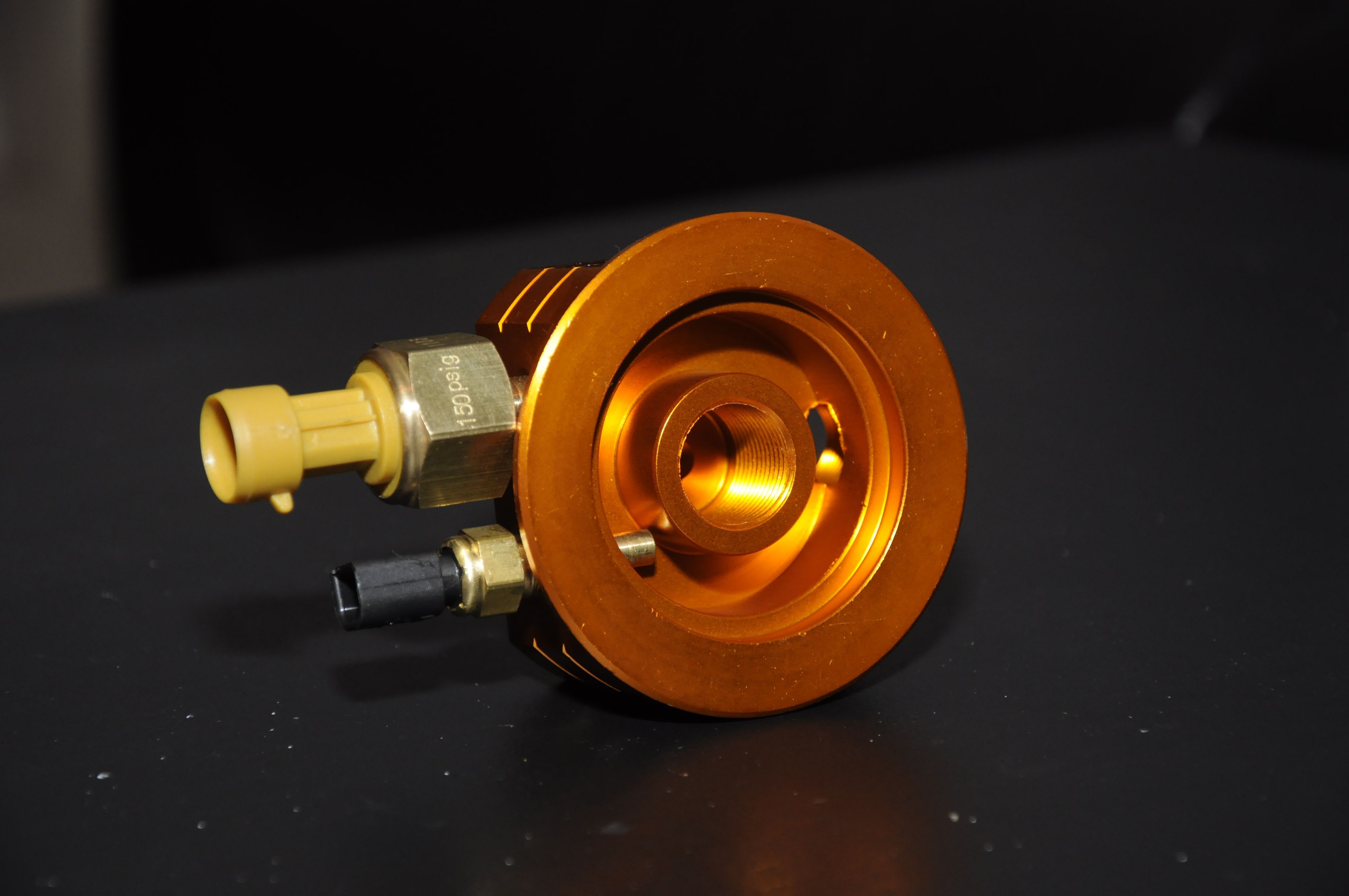

I just picked these up to go with my AEM wideband. My wife took these with her nice camera for me instead of uing my iphone.
Nice fittings from AEM for the oil psi and oil temp gauges mounted in my remote oil filter thingy.

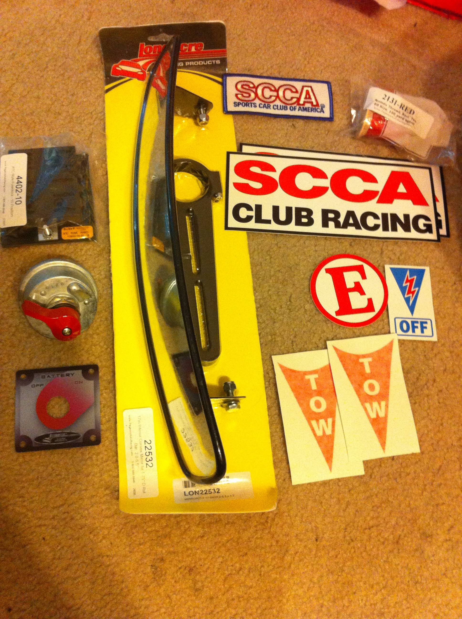

Some other parts came in.
Battery cutoff, mirror with cagemounts, scca club racing stickers, scca patch with nomex thread, and a fuse block for my gauges wiring.

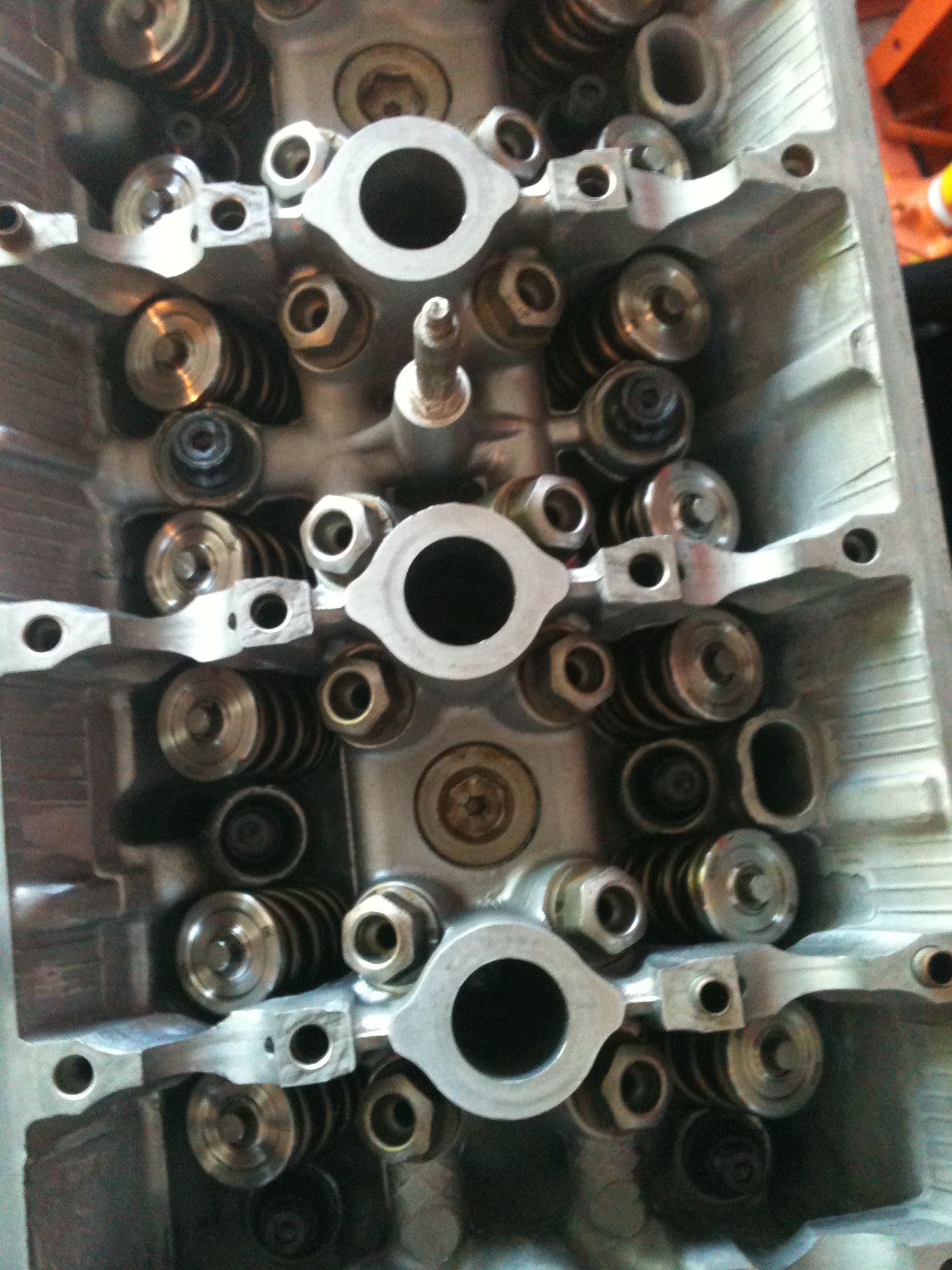

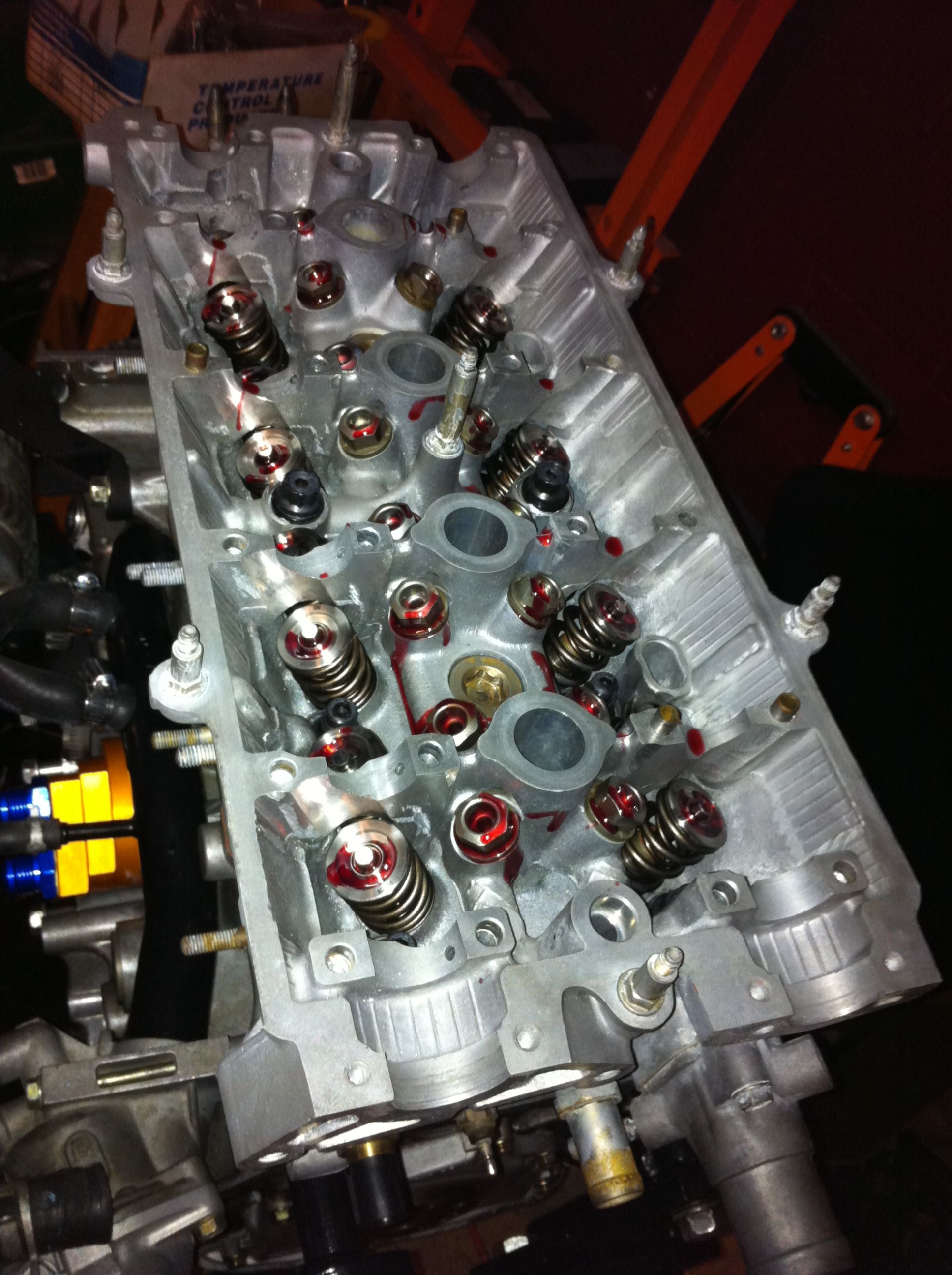

I also finished the head so now I just need to put the timing belt on.

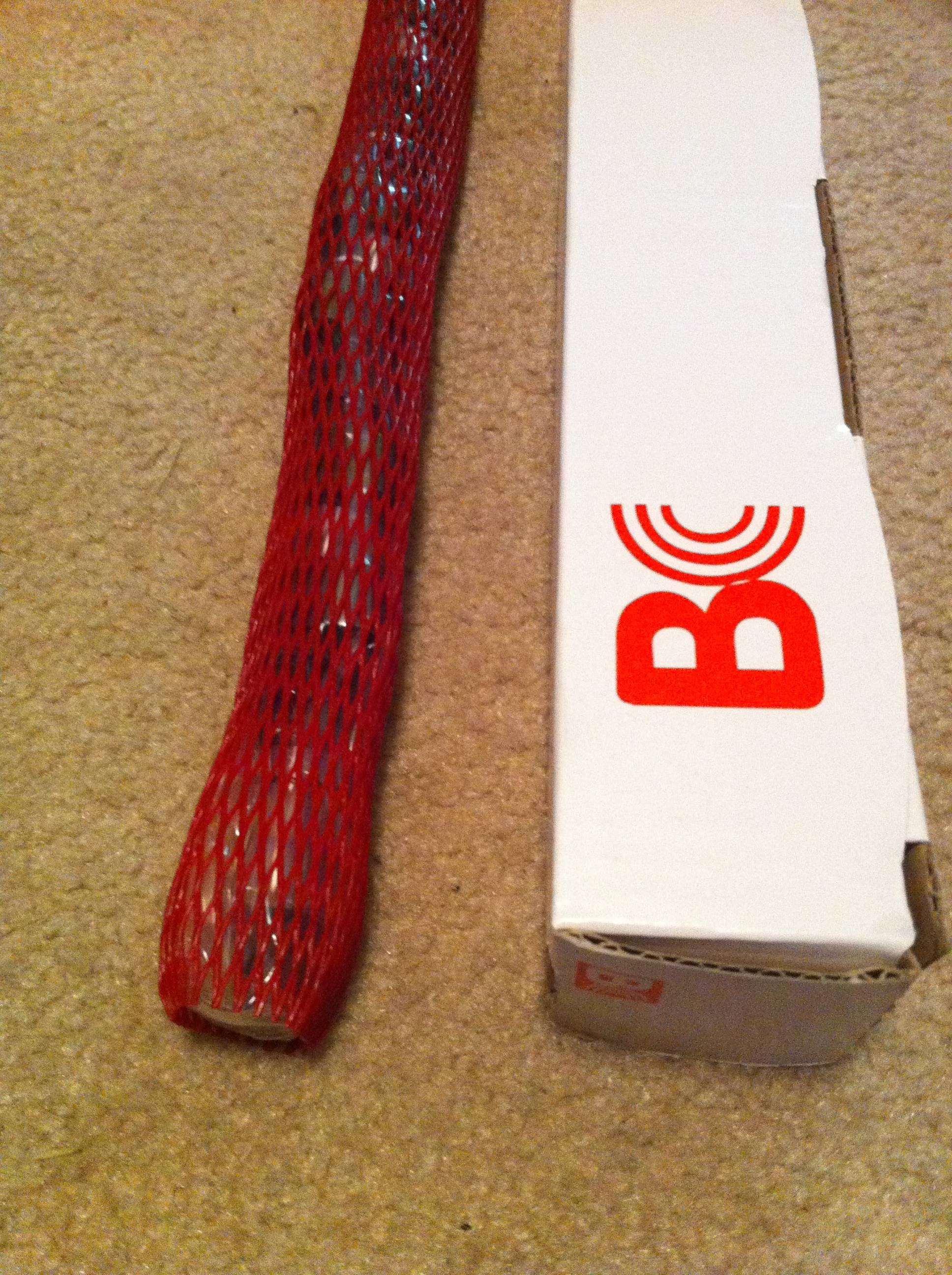

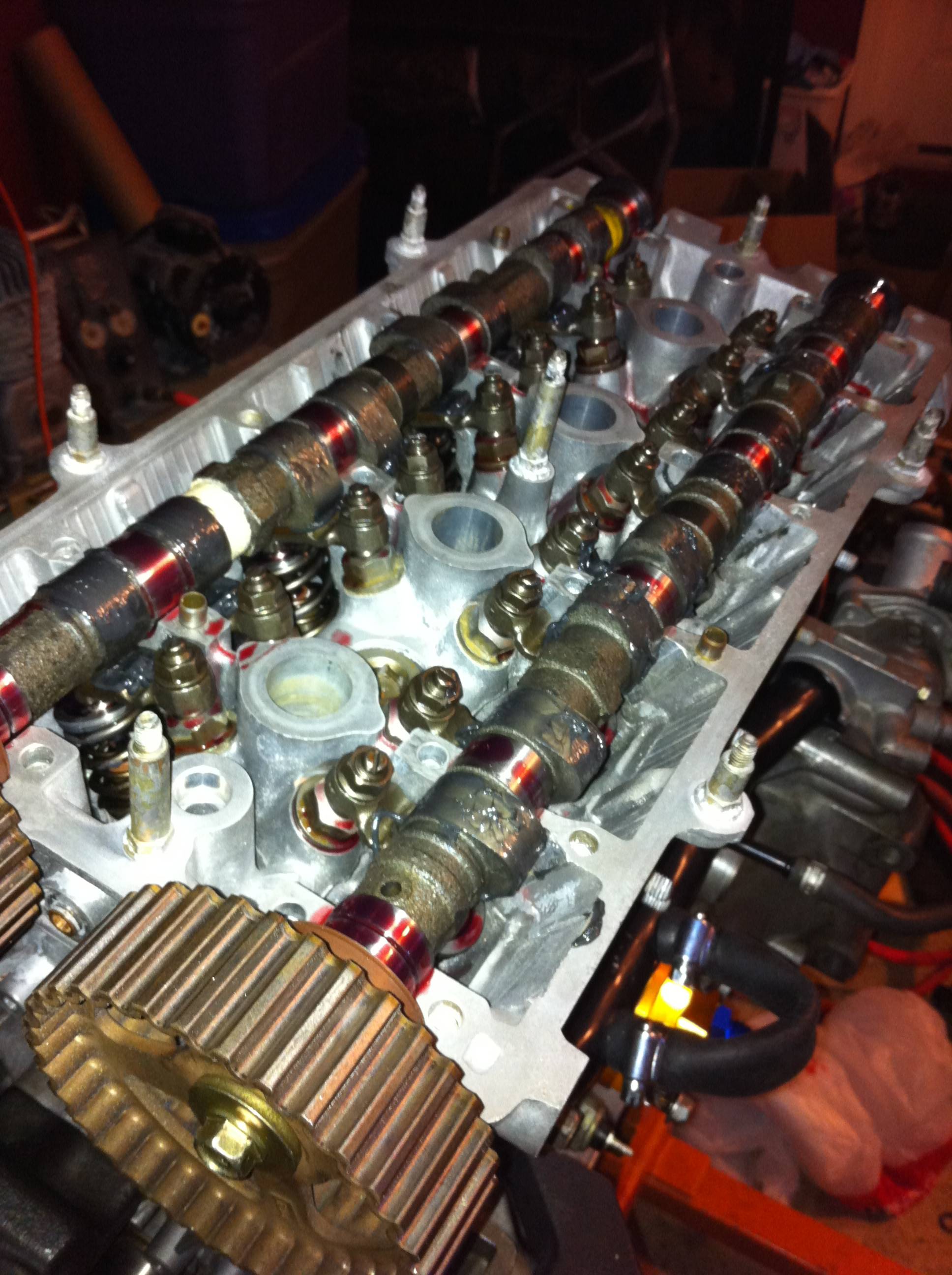

Brian Crower stage 2 na cams

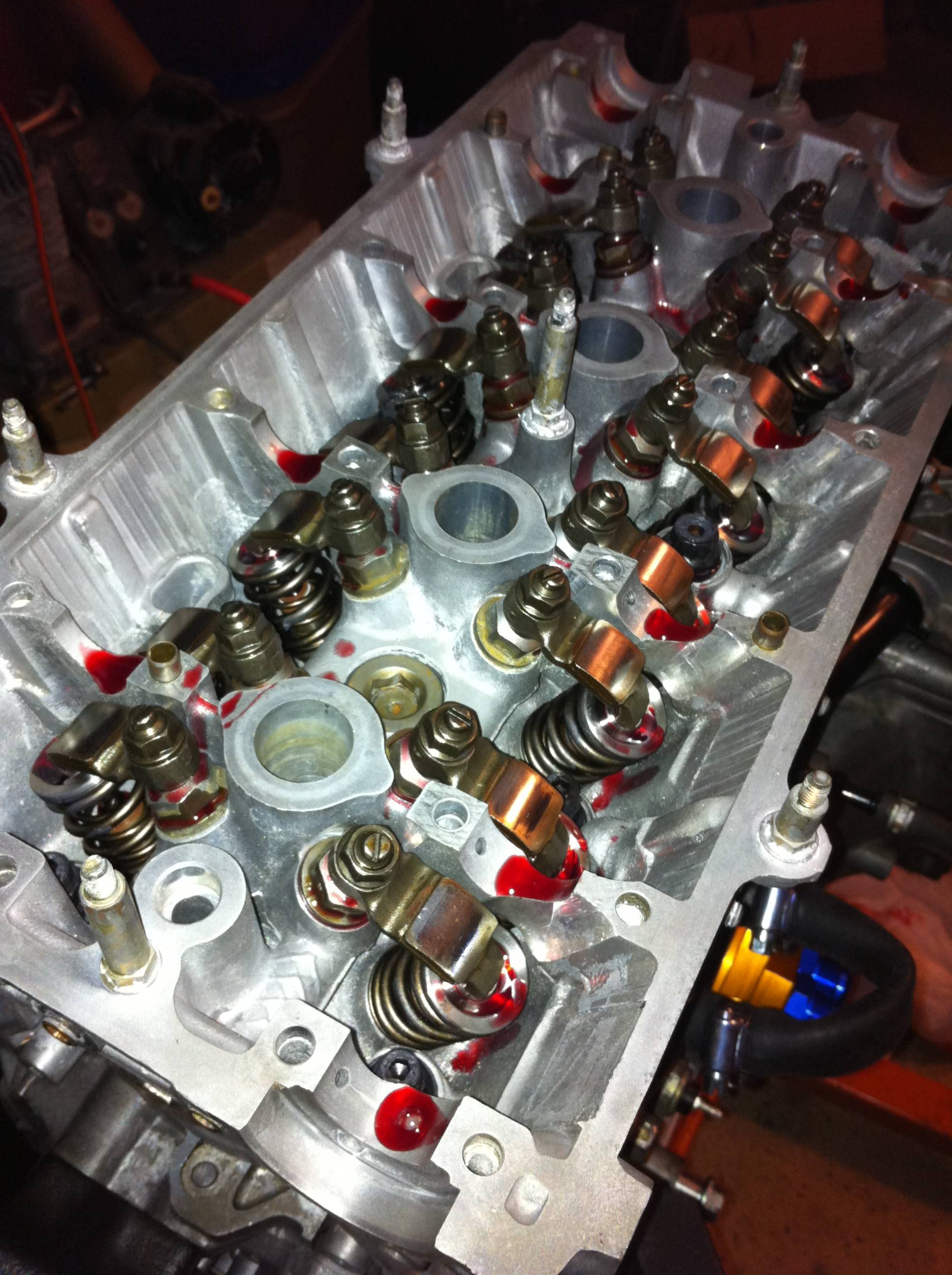

Permatex pre lube before putting in the rockers
Rocker arms in...the b18b is new to me so these are interesting in comparison to the vtec system.

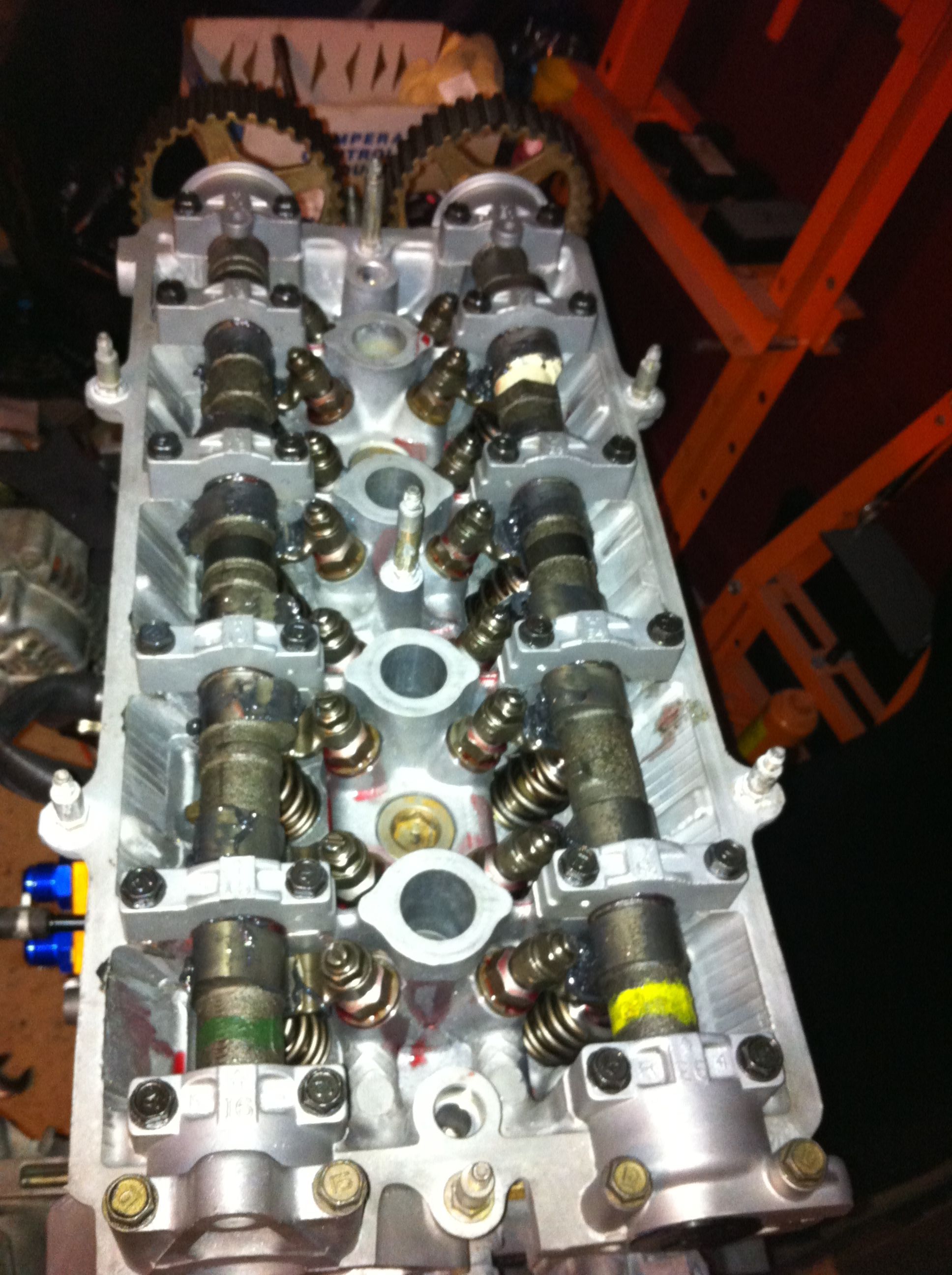

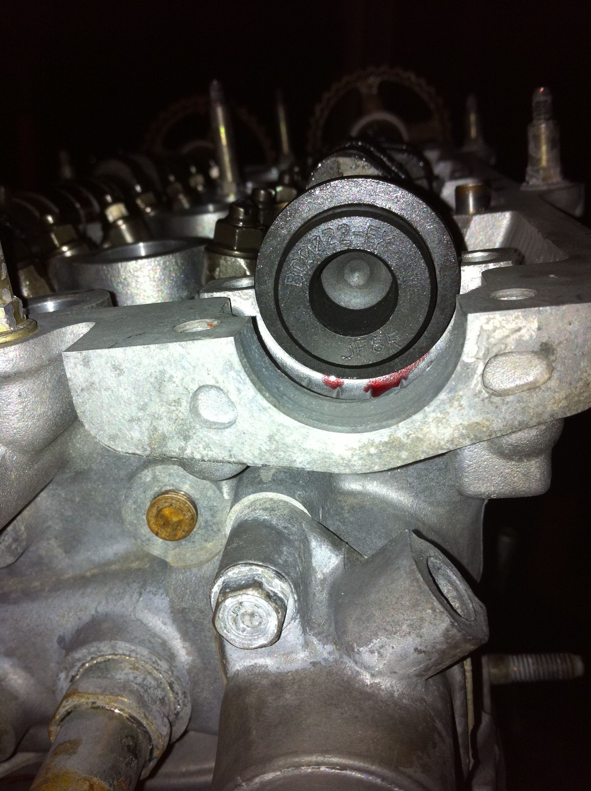

Cams in

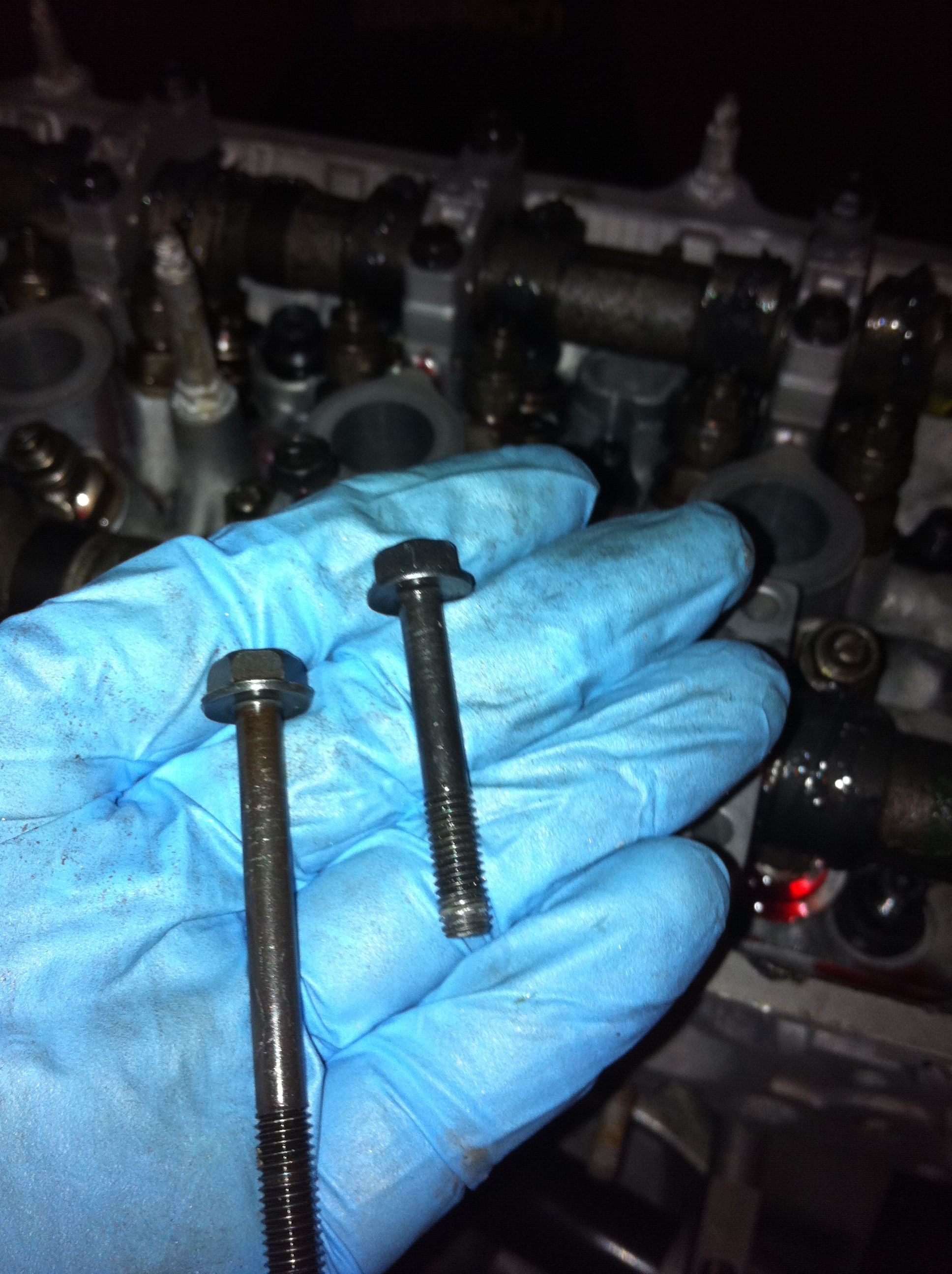

Cam cap bolts...tricky lol shortys go on the outter most sides while deeper are in the center.

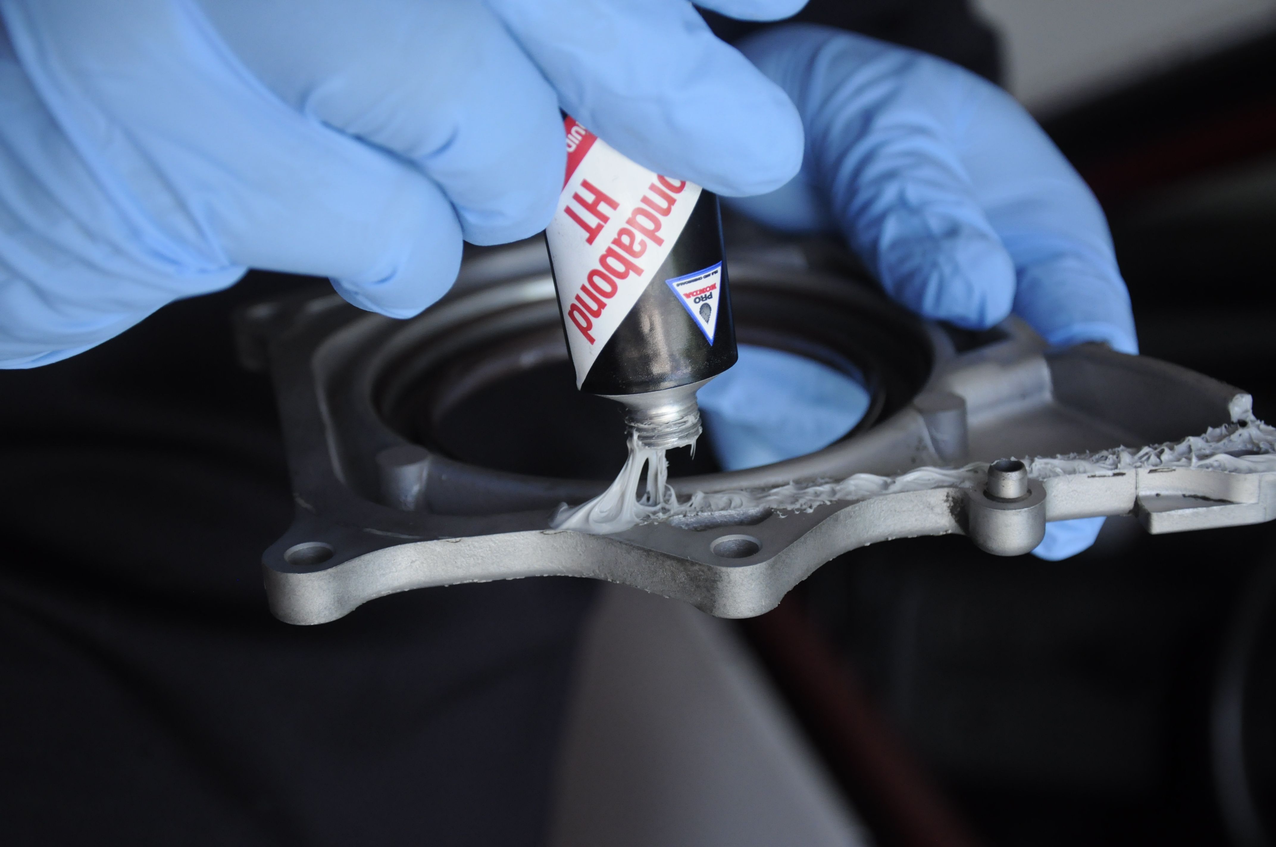

Cam caps installed and honda bond around cam areas
