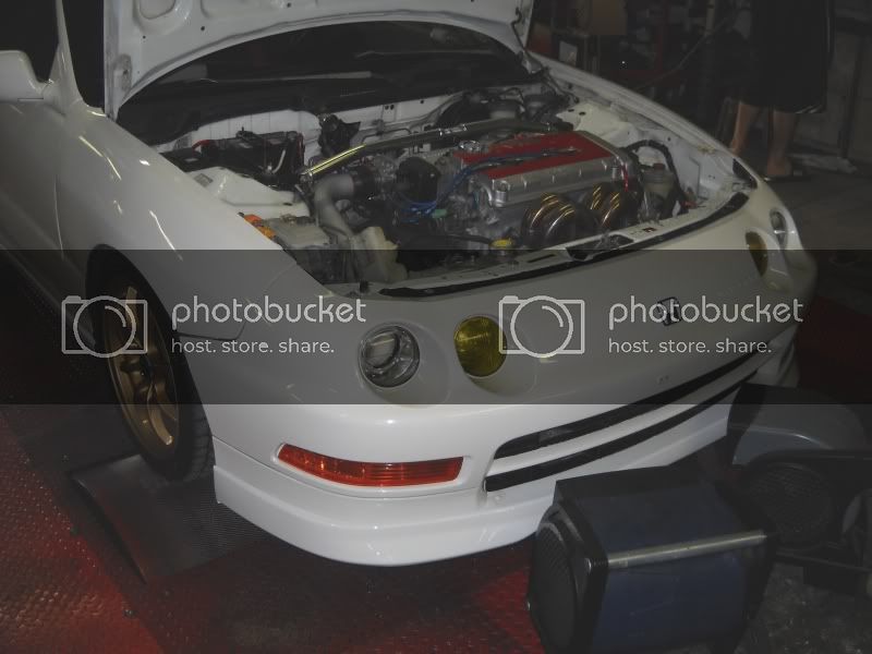

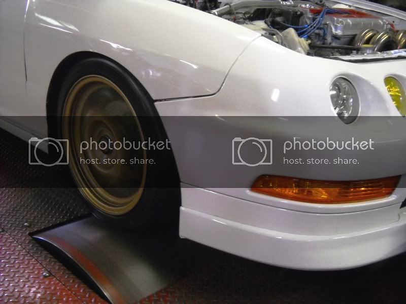

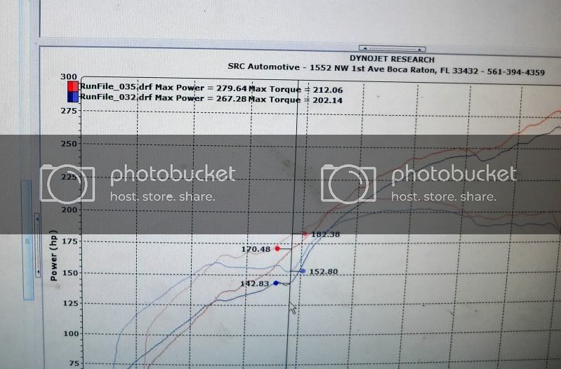

Dyno this morning. Things did not go as well as i had hoped.... Im having a problem with the car running hot. Only noticeable when on the highway for a while or on the dyno under boost. The crappy radiator fan is probably part of the problem. But it seems that my headgasket might be leaking slightly, because the temp goes up when the boost comes in
We did do some pulls and cleaned up the AF ratio so that the car is definitely running nice now. but we just left it at 8 psi for now and didnt try to add timing or adjust cams or anything. figured it wasnt worth trying to fine tune it at only 8 psi and with a possible bad headgasket. that being said the car runs good and is fun to drive, boost comes on like a ton of bricks. even the tuner said it was unusually responsive and that boost came really suddenly.
she put down 280hp/212tq at 8lbs, half-tuned. i cant wait to see what numbers it will put down at 15-20lbs and after really working on the tune. for now i have some work to do....
heres a couple pics:
pretty decent numbers for 8lbs. excited to see what this thing is going to do on 15-20 as well.
