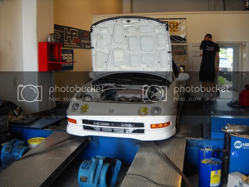

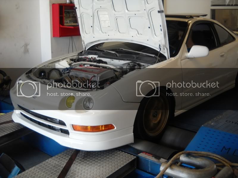

tuning went well today! the motor sounds very strong and its running well. decided to keep it conservative for now with the redline at 8400 and 11lbs of boost. it made 330whp on a Mustang dyno that reads notoriously low. had only one minor problem, on the last run it threw the alternator belt at about 7500 rpms. found out i have the wrong bracket and the alt isnt sitting quite right. but hey, if thats my biggest problem, im happy!
got one decent video..
also got my first ever rolling shot! thanks to kenny, my tuner.

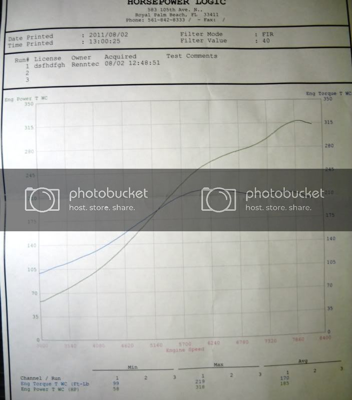

I bet it pulls pretty nice too! What kind of torque are you making? do you have the dyno sheet?
i think it made like 225ft/lbs if i remember right. i didnt realize it until after the fact, the one print-out they gave me was of the run when the alternator belt messed up and he lifted early. but ill see if i can get it up anyways... gimme a few.

after looking at it again, im not sure what run this graph is from but it wasnt the best one of the day thats for sure. looks like it was one of the earlier pulls before he got the tune just right up top. gives you an idea though. also, it was at least 100 degrees in the shop and south florida humid of course.
