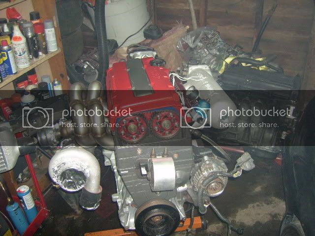

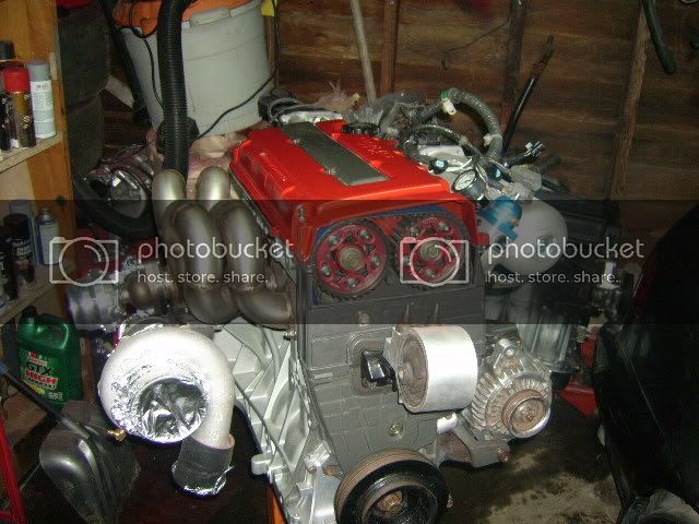

Awesome man, isn't that kind of a huge turbo? How bad do you think the lag will be? (I know nothing about snails)
The turbo is perfect for my setup.
I shouldnt have any problems with it. Thats the reason why i went with a .63ar instead of .82 or bigger.
spools quick....

Not much done these past few days.:mad:

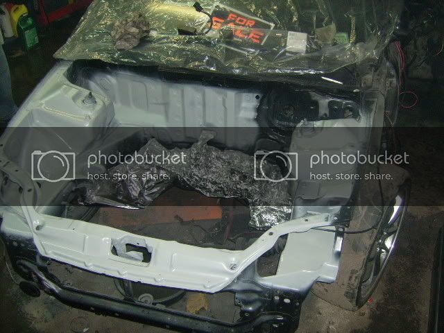

Engine bay almost done.
Fender wire tuck done
brake lines done. Just waiting for my 4040 prop valve from stealthmotorsports
injector clips wired. not pictured.

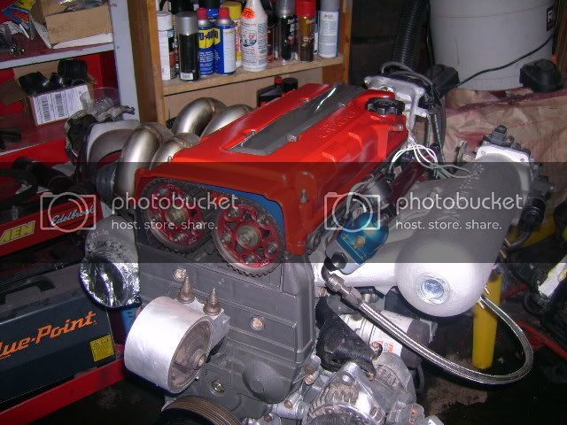

Engine about 80% assembled.
Tomorrow i'll start working on the downpipe and soldering more wires.
Oh and before you ask...The reason i painted the valve cover red is because, well....
it gets my PUSSY WET. :p
sorry for the shitty pics. Looks a lot better in person. lol

Coming along nice man. I just don't like the block guard :( other than that, your shit is gonna be sick. Oh and as far as rims go, VOLKS FTMFW!!! some bronze te37's...yummy!!!!
blockguard should be fine.. IM not trying to push 500+ whp so im not worried about it. If i ever decide to hit the 500+ hp mark, i'll get rid of the block guard and sleeve it.
