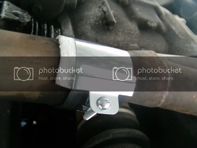

The sad thing is, I thought this paper thin bandage may have been able to help for a week or two... It broke loose after 15 minutes of conservative driving. I guess I have to learn the hard way, lol.
Shoot, I have a 4-2-1 Setup and it did the job until now. I got the shitty coupler back on and have heard nothing about getting paid lately. This sucks.
