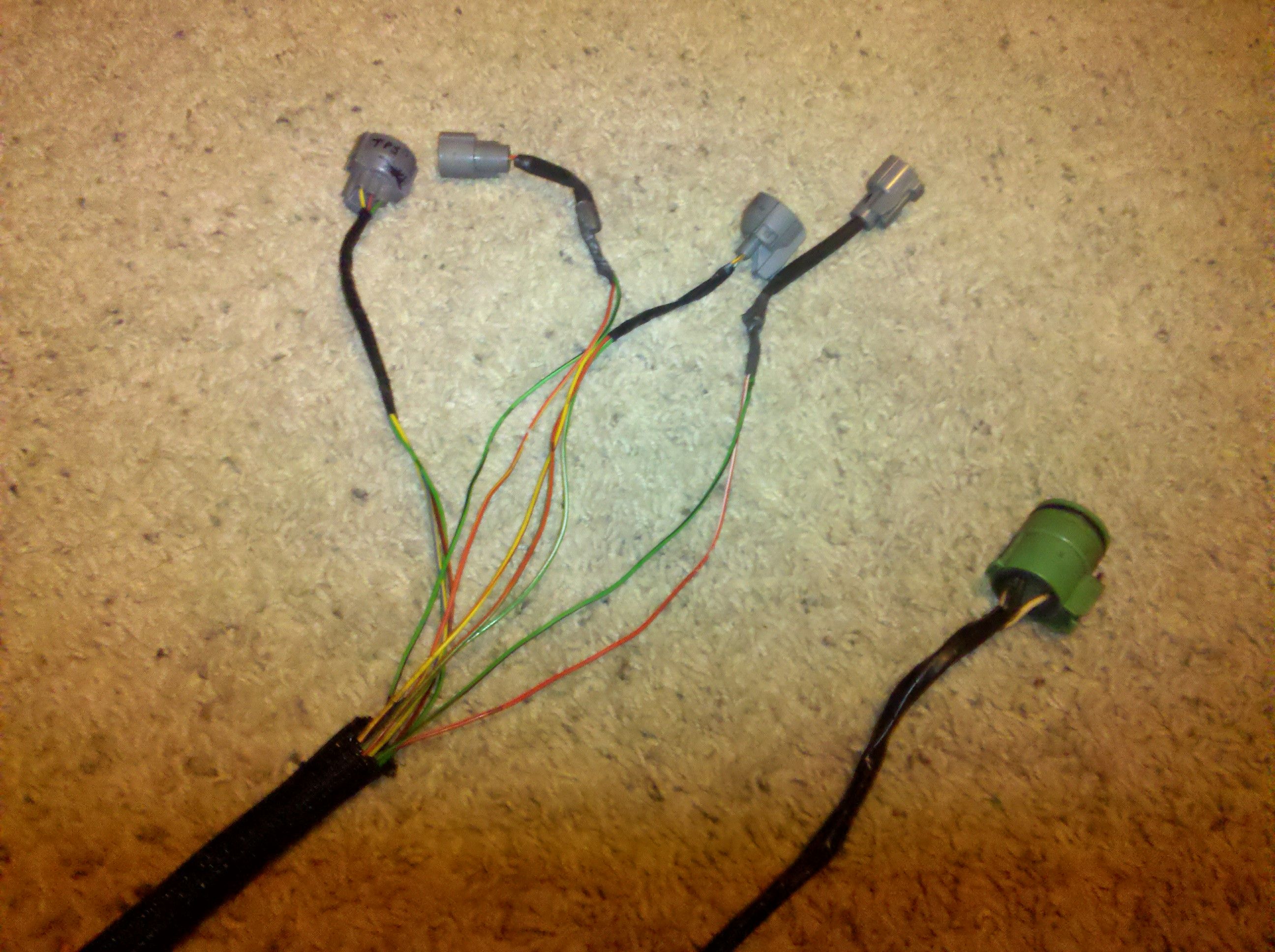

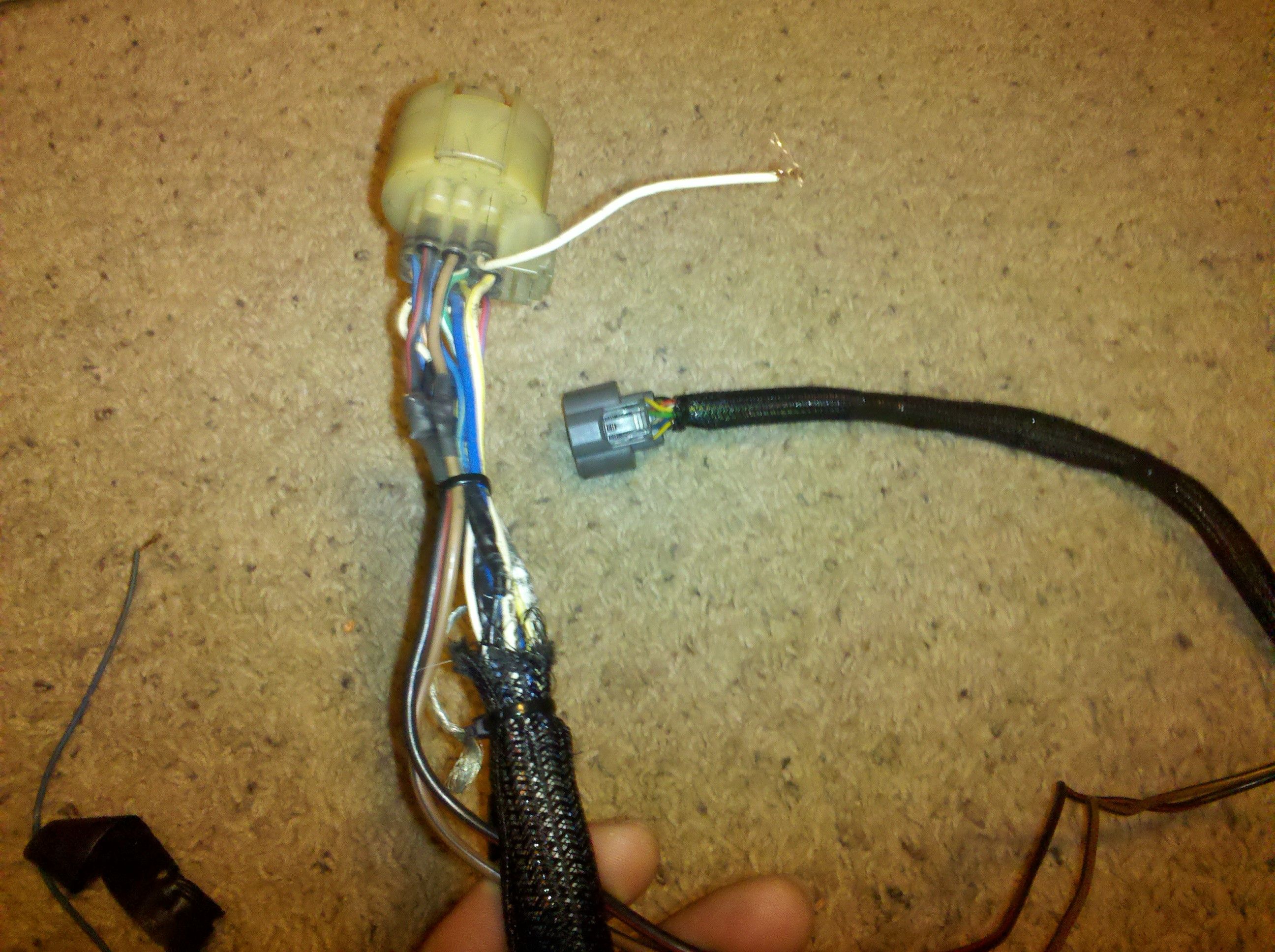

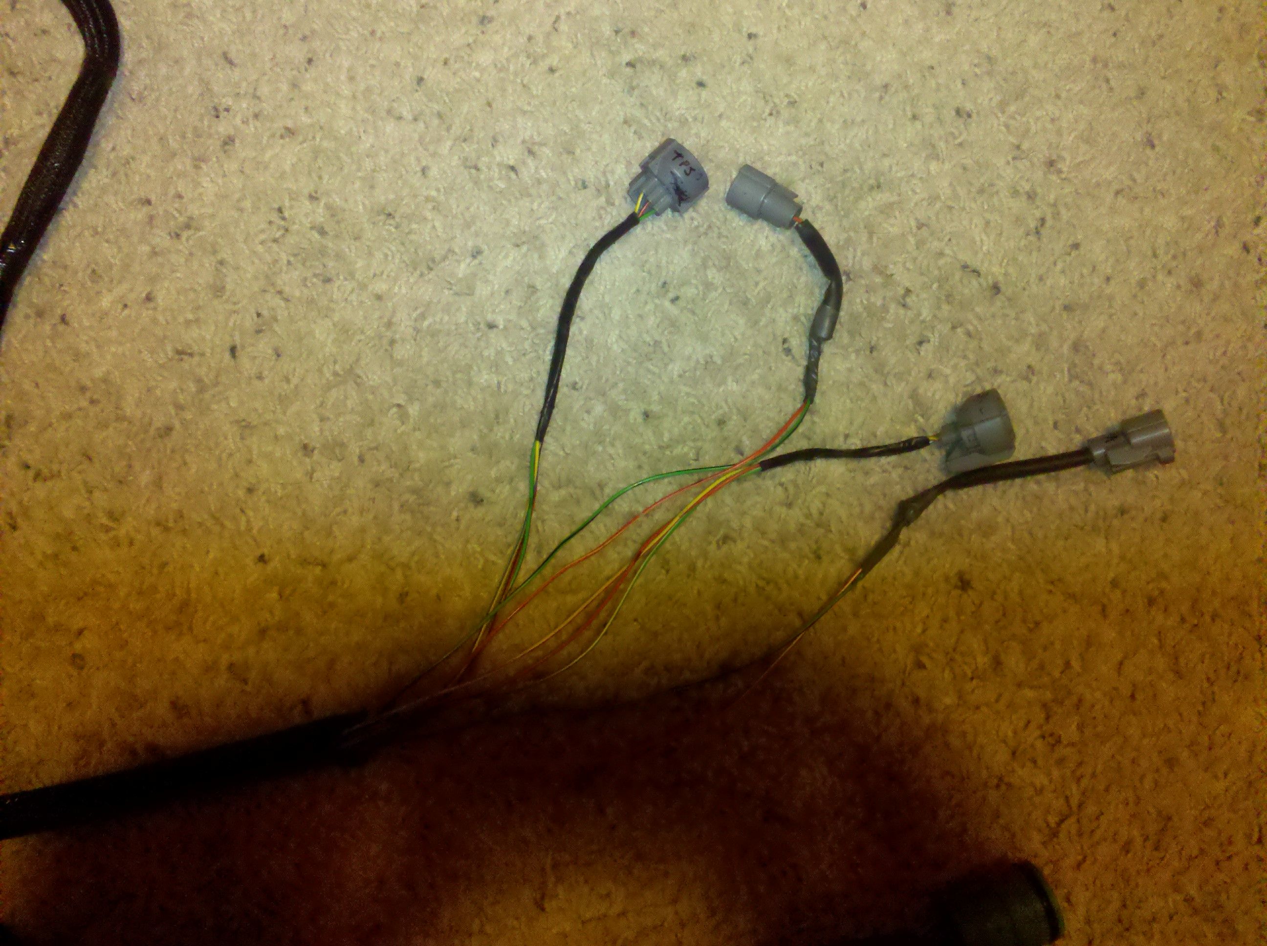

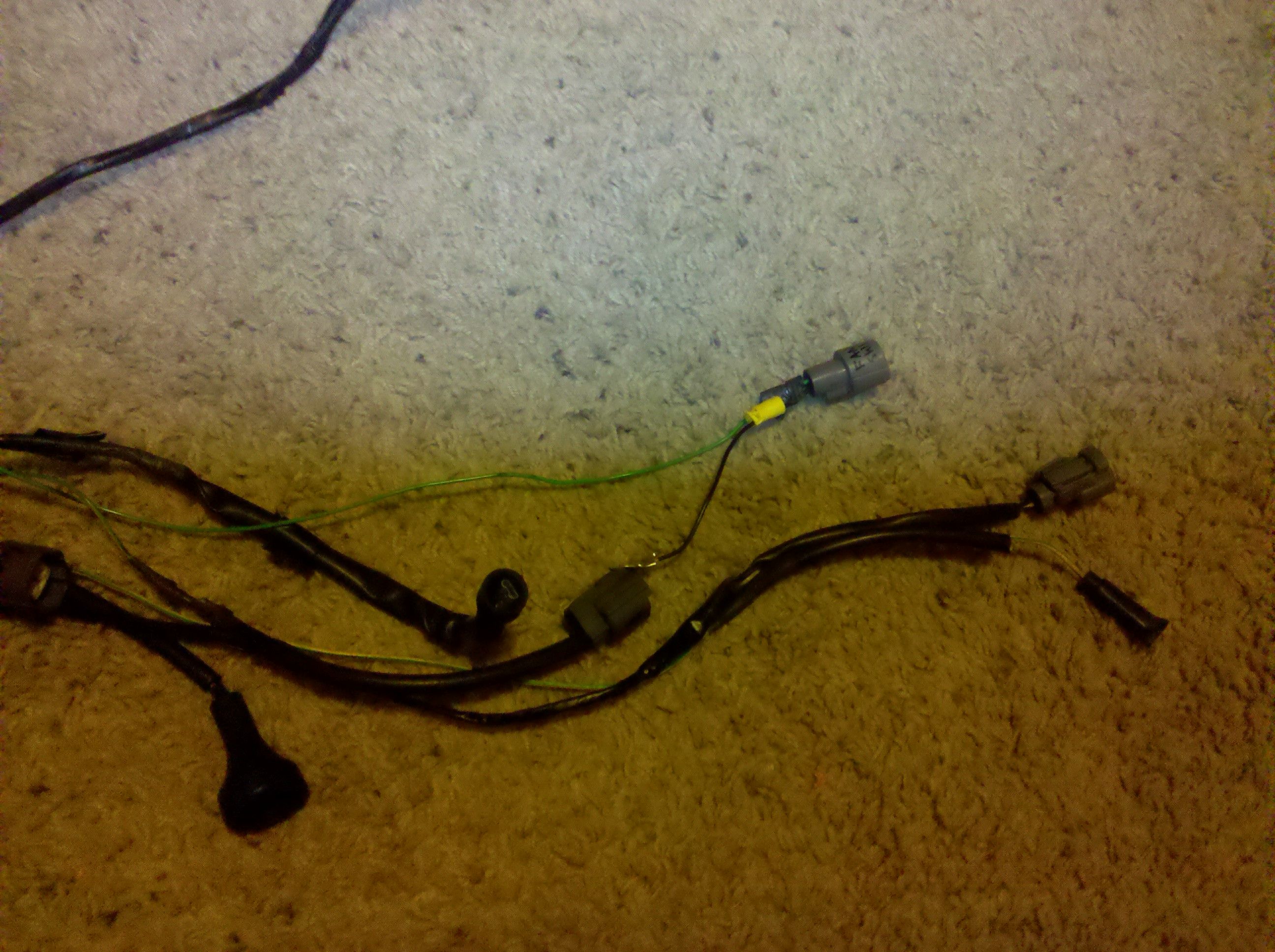

here's the pics.
everything is now full plug and play. Once I hook it up then I'll cover the wire colors.

Pull all that old sh!t offa there when ready to wrap. I see the starter solenoid wire - where's the BIGGUN for the Alternator?
You going to wrap with split loom (convoluted tubing)? Double wrap that with some good tape. Use at least Scotch 33+ or Scotch Super 88 is even better for engine harness (thicker than 33+).
Wrap it one way and then back the other way. And go over the nodes or breakout points real good.
Just like factory new.
They look pretty good BTW!
