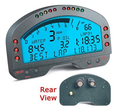

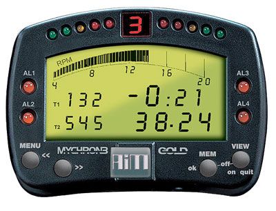

Going to do a custom cluster I think. Going to look into it and see how much of a pain in the ass the speedo is going to be.
Who knows. I like those digital ones, except a digital tach would make me want to stab my eyeballs out with a screwdriver. Never been much into them.
