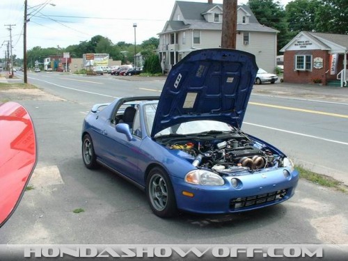

my old car (which had the non-ac kit):
Thanks for posting that, B. :thumbsup: I had your link for Hondashowoff and your old thread but eh, I'm never on a single computer long enough to keep CRAP!
What type of radiator did you end up with? From what I know that kit requires a half size and eh, though I haven't gotten there yet, it would be cool to know any suggestions for a radiator.
Just like the avian flu, I have to spread the rep around more. Thanks again man. I really appreciate the pics.
PWR rad. it sucked. didn't fit the feet right, didn't have proper mounts for the fan.
go with a fluidyne if you're going aftermarket, or a del sol dohc vtec model rad. its dual core and still half size.
but, the ac kit should fit with the std radiator in there. i'd ask FR.
my kit was one of the first ones they produced. its changed a lot since 2003 when i bought it.
