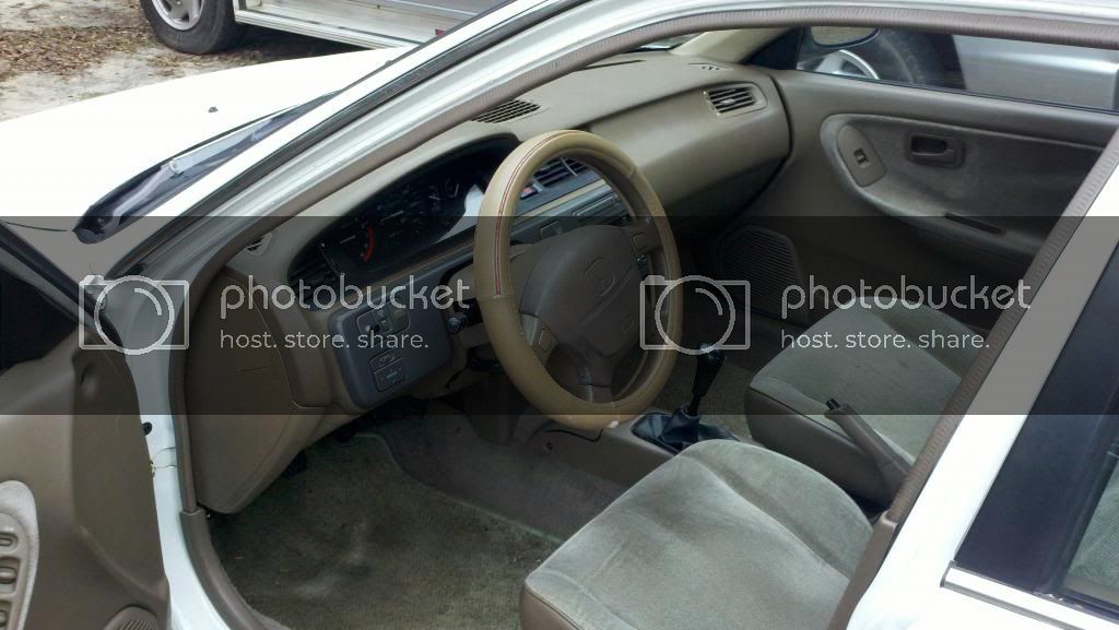

Interior:
Equipped with 12-SMD LED dome and trunk light:
My favorite part.. guess why (coming from a CRX):

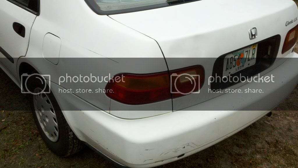

Only dents in the car. Previous owner was hit 3 times in this area! bumper, trunk, and 1/4 panel show signs... My friend over in Pensacola does Paintless-Dent-Repair. I want to get these dents pulled out sometime soon:

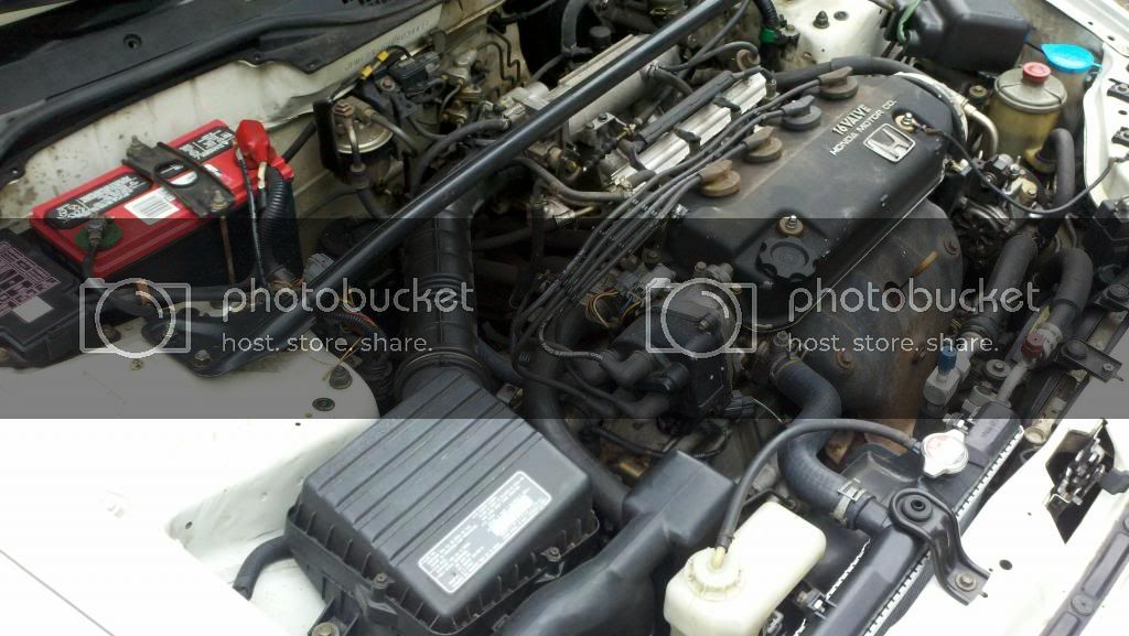

Engine:
Since I've owned the car- New valve cover gasket, ICM, radiator, hoses, ac compressor/dryer/expansion valve, and a good cleaning!

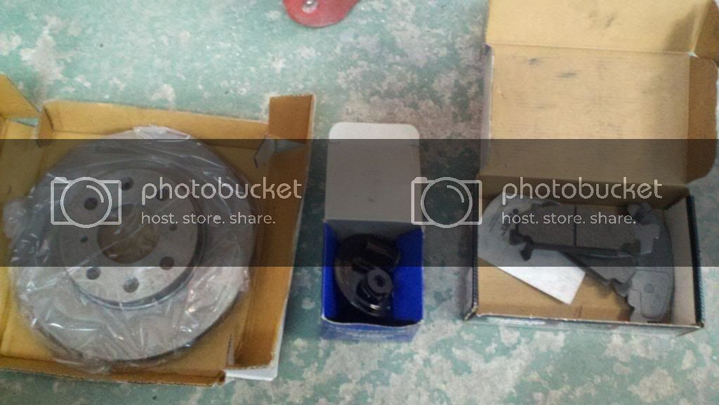

So Photobucket is currently undergoing some maintenance, but I still wanted to post an update from this morning's stuff:

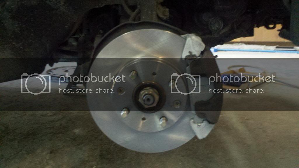

-Changed the brakes and fuel filter. (new blank rotors and Ceramic pads.) Got a good deal on all this stuff from Rock Auto. It was all $53 shipped! killer...;)

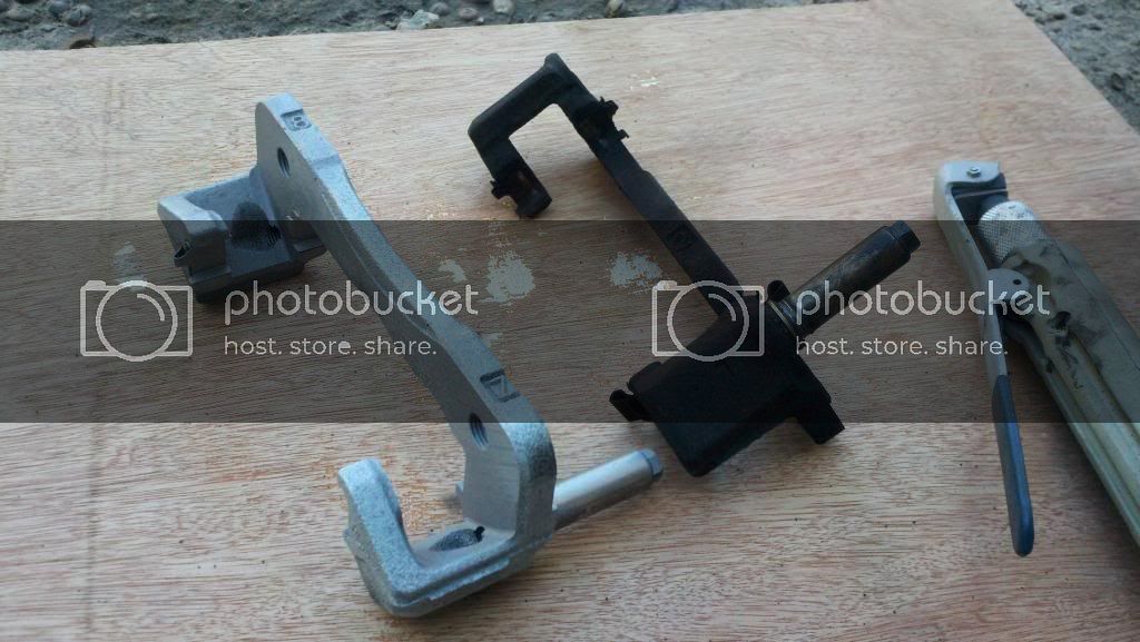

-Sandblasted the caliper brackets. Since they're aluminum I left them raw.

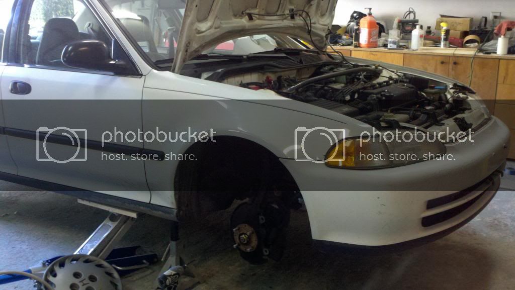

Installed the brakes. BOY I really wanted to pull the calipers off and blast them too! but I controlled myself, in hopes of doing a Prelude caliper/Mini Cooper 11" rotor upgrade, along with SS lines.. SOOOOO, I held off.

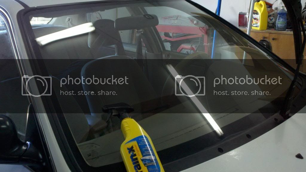

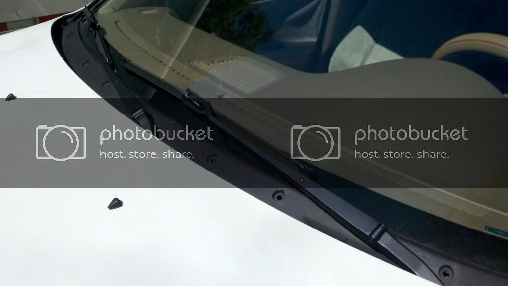

-RainX'd the windshield

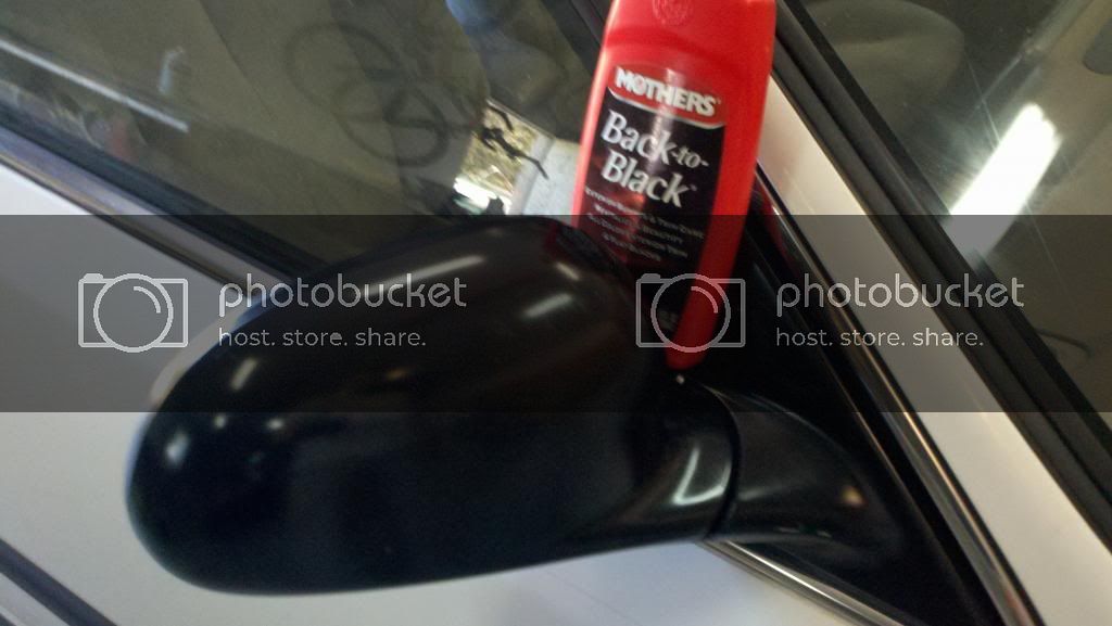

-Back-to-Blacked all the black molding on the car

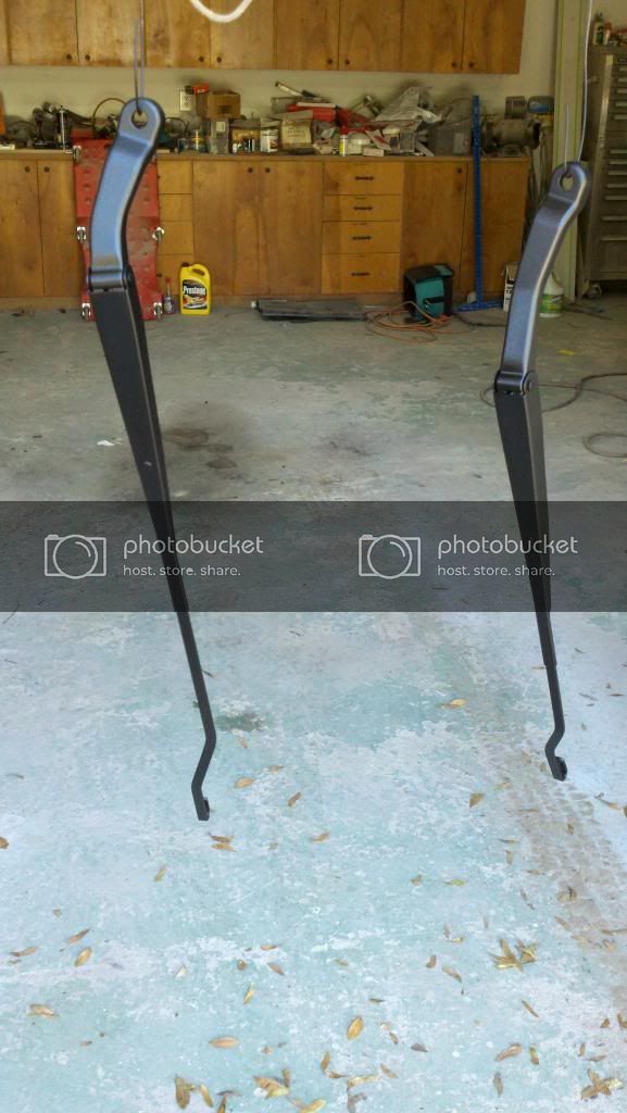

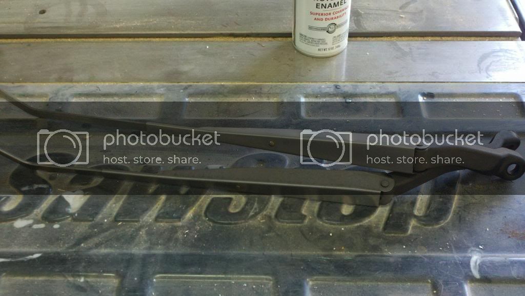

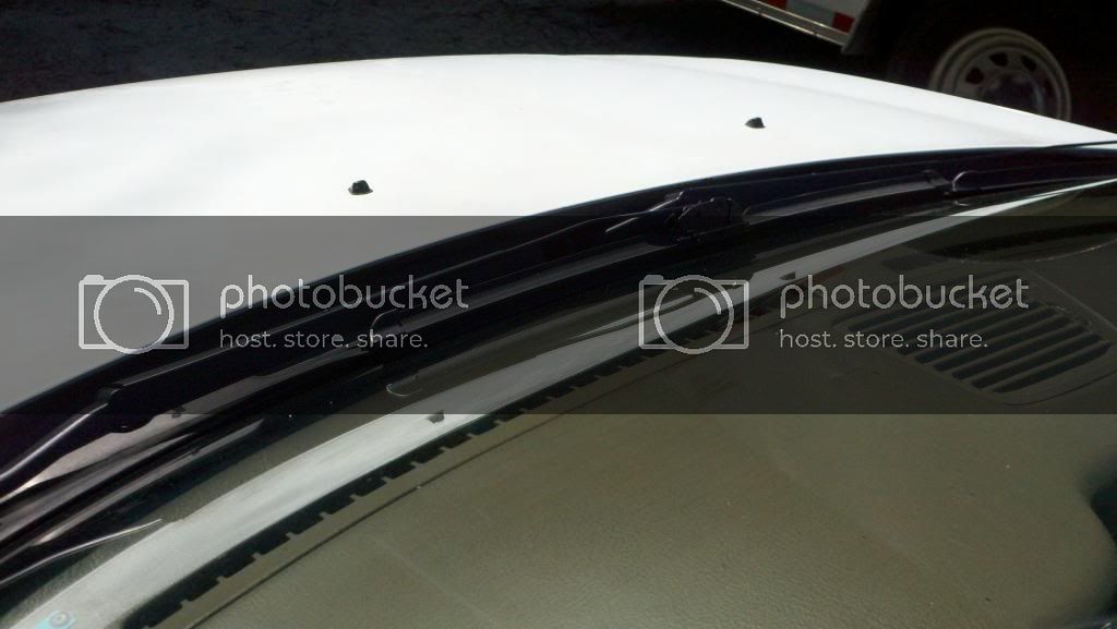

-Painted the blindingly-chrome wiper arms.
As you can see, I still need to get those little clips to hold the cowl-cover down. I have no clue where the originals went. lol. How did the previous owner lose them??? weird...
I'm happy with the results! Brakes feel great, wipers are no longer an eye-sore. Big update, huh?! lol....
