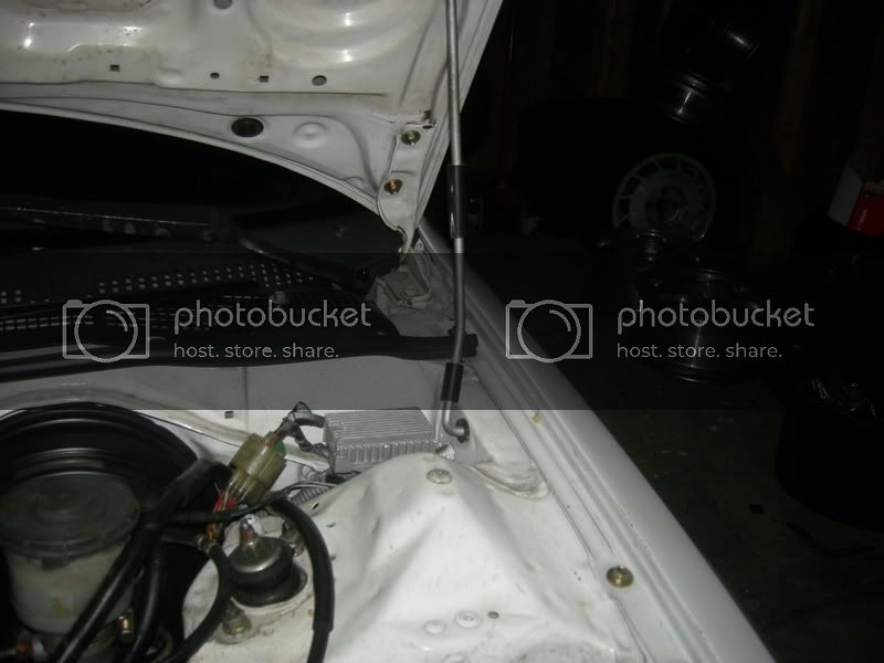

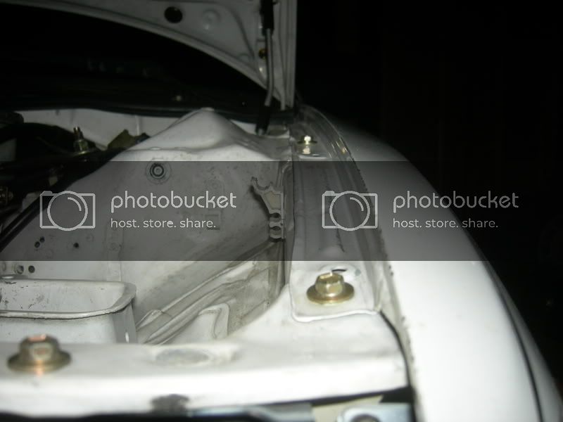

Got some work done today.

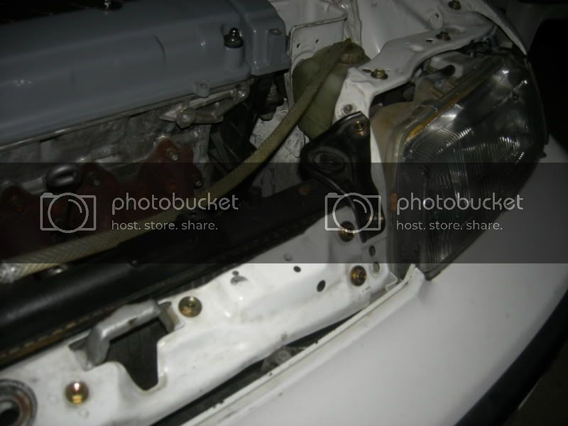

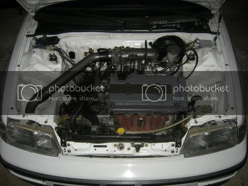

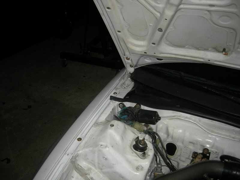

Looks like my rex is running pretty good. Went and filled it up with some fresh gas and checked for leaks (story of my life... thanks.. EF's.) and I've got a strange coolant leak dripping down my engine stamp. I'm still trying to diagnose it, but it's no big deal.

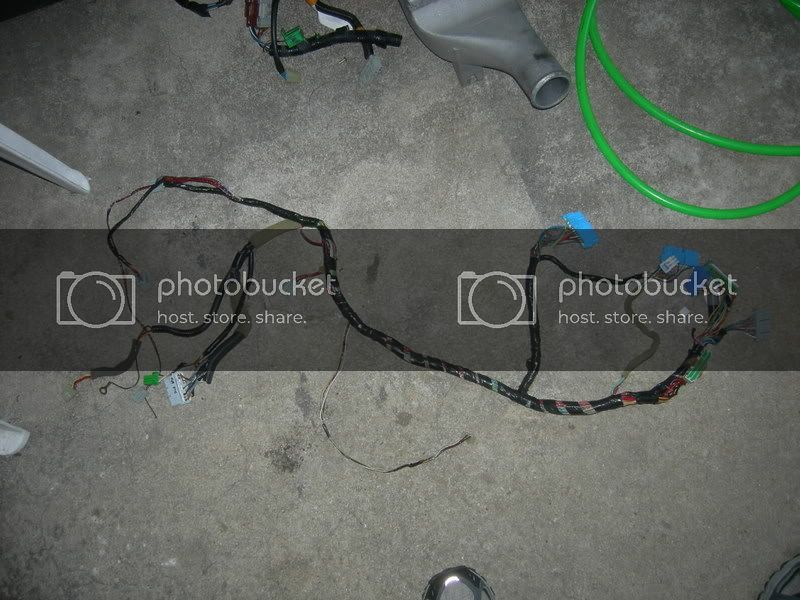

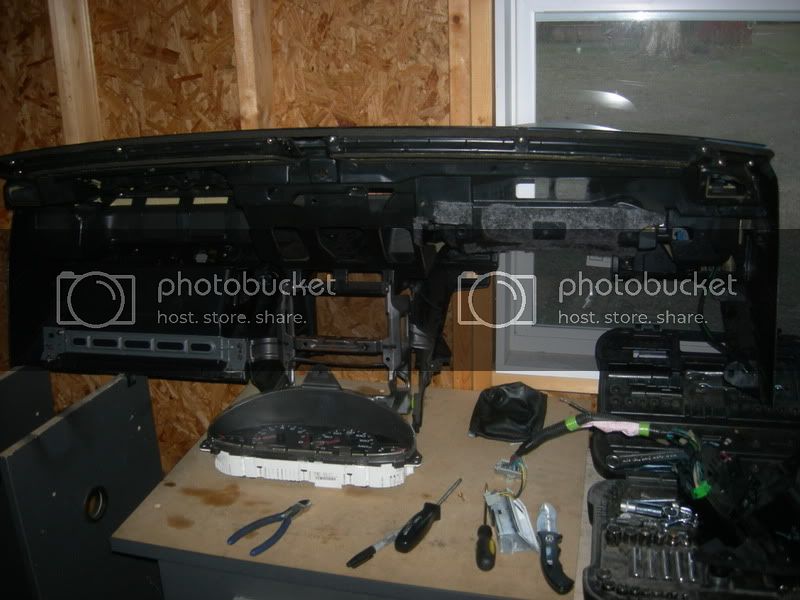

I stripped out the dash harness of the DC dash. I labeled some of the plugs I want, but I think I'll be using my CRX harness and merging some of the wires for simple things like the dimmer, sun-roof, Hazard, and Defrost (which is pretty much the only things I'll need, since I'm ditching the Climate Controls.) Don't worry. I'm doing everything I can to keep the harness', and my car in general, ready to switch back to normal if I ever need/want to.
Oh, and I redid my engine bay in GOLD bolts! bling bling, homies
