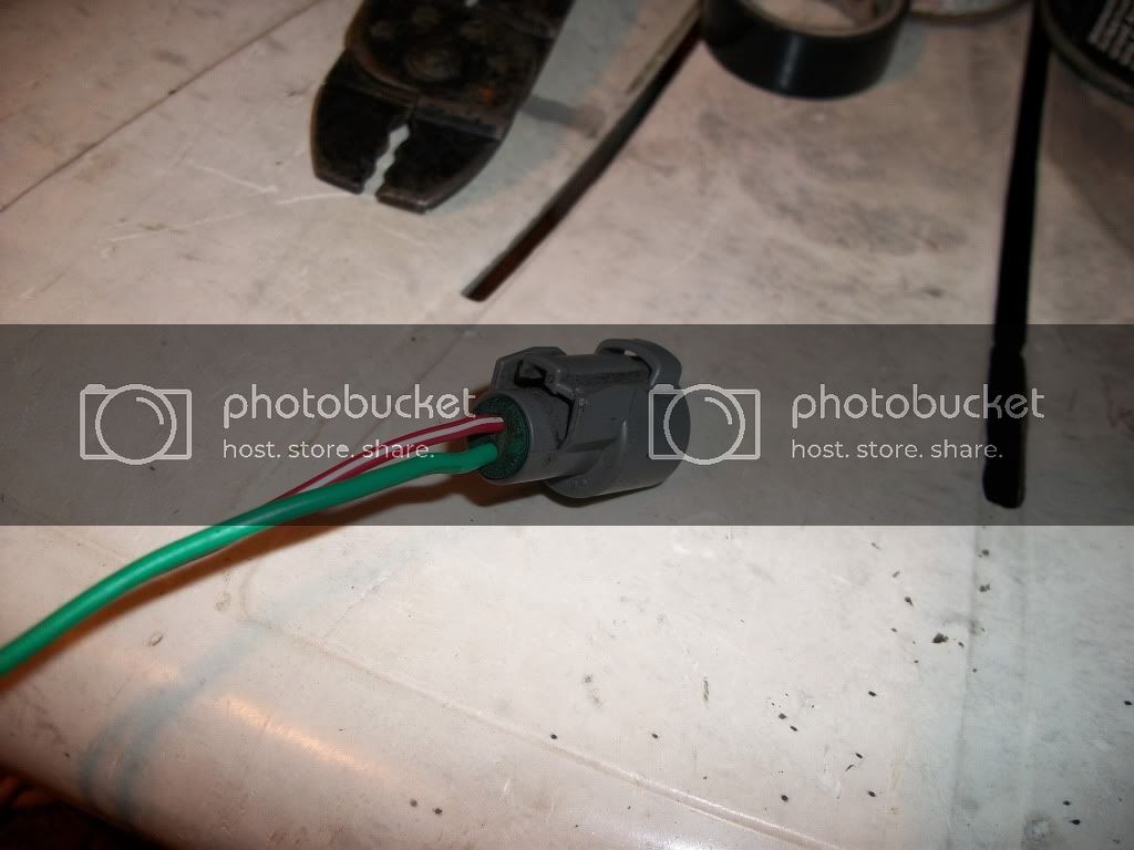

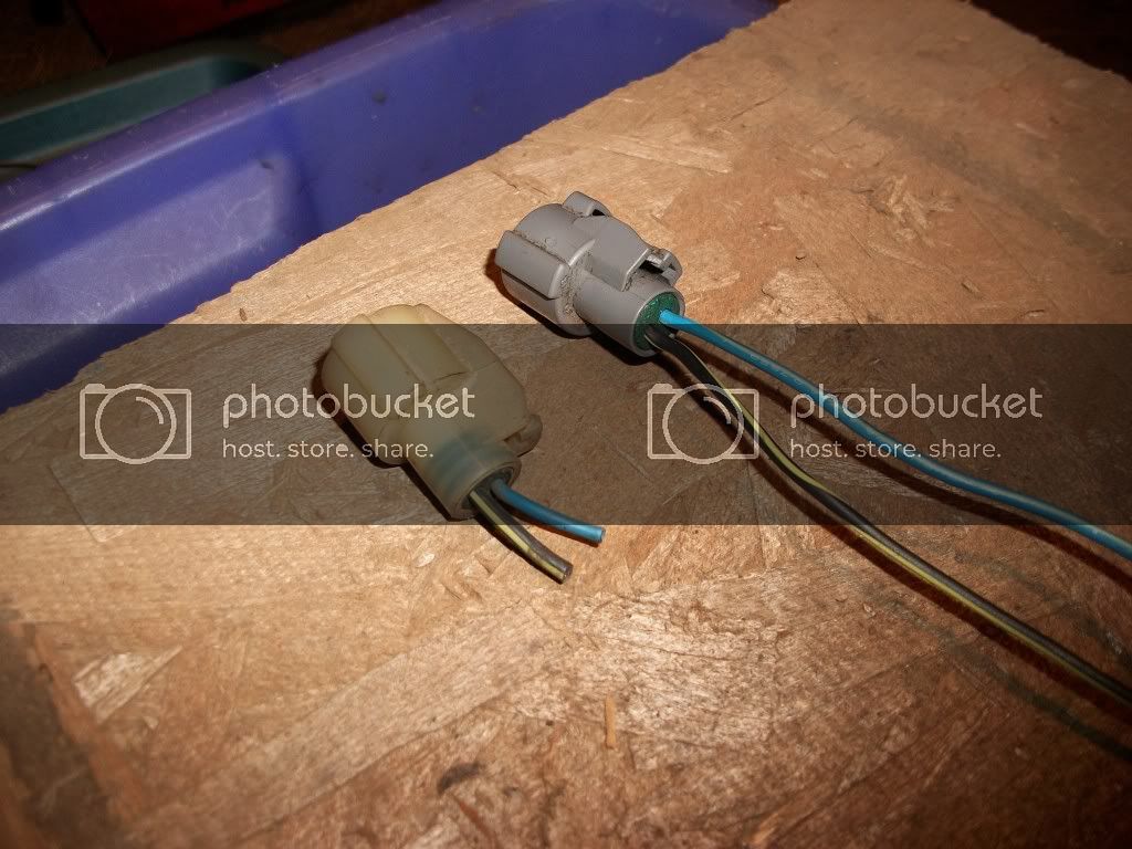

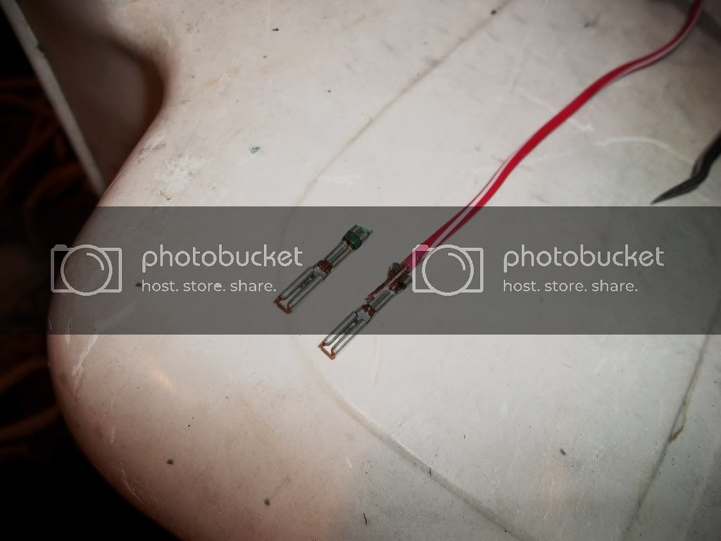

My temp sensor was oil soaked and the wires cracked so I fixed it by soldering right to the pins. (notice the new OBDII plugs I found ;))
The IACV plug got cut too short to my liking so I fixed it the same way.

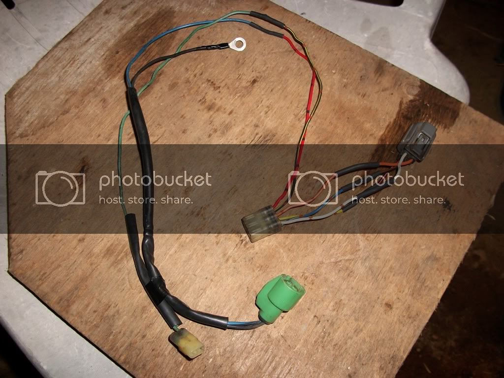

The remade VTEC and 4 wire o2 sensor sub harness. All other wires on the B16 match up exactly to a stock Si harness.

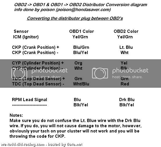

Maybe this will help.
My OBDII dist didn't come with those wire colors according to that chart ^^, they actually matched up to OBD0 wire colors. And yea I checked them a few times to make sure they matched up. I'm maybe thinking now that I need to find the function of each wire and make sure that they weren't mixed up from factory.

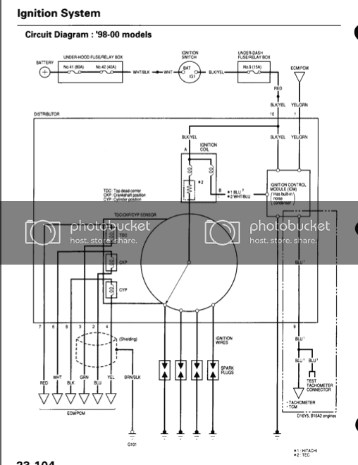

I'll bet that if they were not the same color as the obdII dizzy then you probably got a wire crossed. Can you compare the new dizzy with a plug from an oem dizzy to see for sure what goes where. Here are some pics from my helms that covers the 99-00 si. These might be able to guide you through.
Wiring diagram
Connector diagram

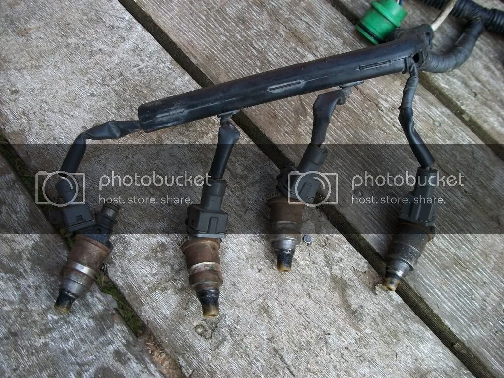

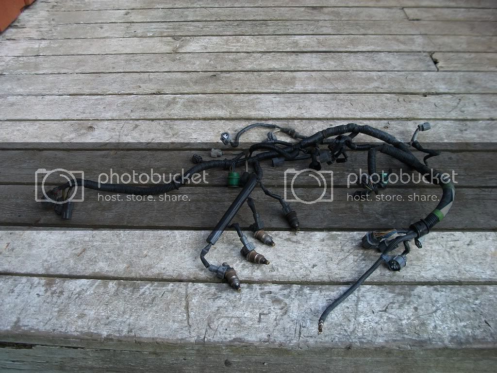

So I hit up a hillbilly wrecker today, not the usual one I use cause its a longer drive but well worth it ! The guy has about 5 almost complete EGs and 3 of which still have D16Z6s in them !! So I got a complete Z6 harness and OBDI injectors for $40 ! :D The injectors have 430xxx KMS on them so should I attempt to clean them? So now I am deleting the resistor box and converting all my engine plugs to OBDI. :)
I'd sure clean them up before installation.
Yeah I'm degreasing the outside but isn't there a way to take them apart and clean a little screen or something? I just wanna make sure there isn't 430xxx KMS of shit clogged in them and they don't supply enough fuel since my OBD0 B16 injectors should still be fresh.
