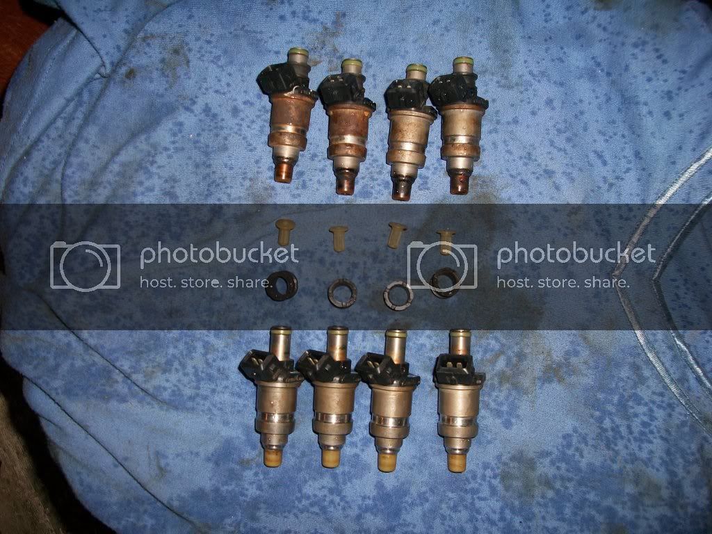

It does run fine on the B16 injectors, except the first time I started it up the # 4 injector sprayed all over the place. I took off the rail and bolted it back down and after a couple fuel pump cycles it sealed up.
I took out the screens on both the D16 and B16 injectors and the B16 ones are cleaner so I have the D16 ones soaking in paint thinner for now.
OBD0 injectors on top, OBDI injectors on bottom. Yes I cleaned the OBDI injectors.

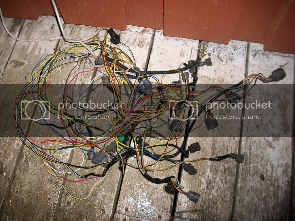

The harness is all taken apart.
YAY !! GOOD shielding wire ! :) One of four 02 wires in the EG harness is shielded so I'm going to do the same.
Haha it better. I let the screens soak for about an hour , shook the bucket they were in and I saw 4 shriveled pieces of crud in the bottom. :) So I blew compressed air through them and they're like new ! I could barely blow through them before. I have confidence in using the OBDI injectors now.
