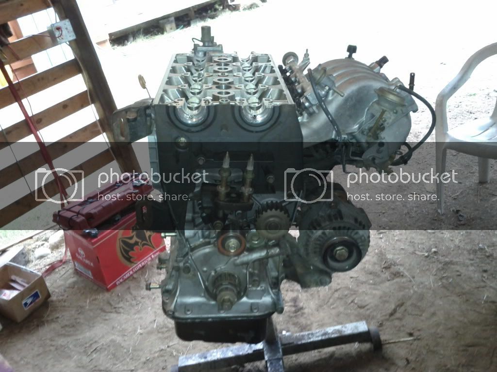

The head is mint.
The head is mint.We may earn a small commission from affiliate links and paid advertisements. Terms

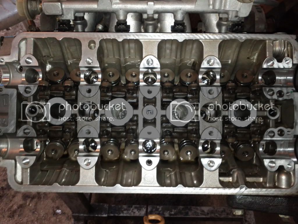

The head is mint.Ya, it looks like a piece chipped off and you can see the top of the spring. I would def double check that before you drop a valve.look damaged to me too..
Definitely looks butchered. Probably just cosmetic. The camera many times picks up stuff not readily noticed by the eye.it looks like someone tried to hold it with either a visegrip or a wrong tool for the job of some sort... the tops should be straight and smooth all the way across. i dont doubt that the head isnt mint, but looks to be hacked from where im sitting dude. thosse are def tool marks...
That may be, but it doesn't take much damage for a retainer to fail. And when it does...Definitely looks butchered. Probably just cosmetic. The camera many times picks up stuff not readily noticed by the eye.
Yes indeed - failure would likely turn the engine into a recycling event. Certainly not worth risking it. When in doubt, I would change them for sure. But, Brad claims it's nothing but "Camera Magic" - so, I'll figure he's right as he knows what to look for.That may be, but it doesn't take much damage for a retainer to fail. And when it does...
