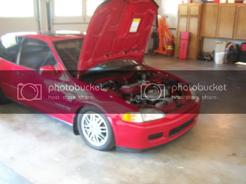

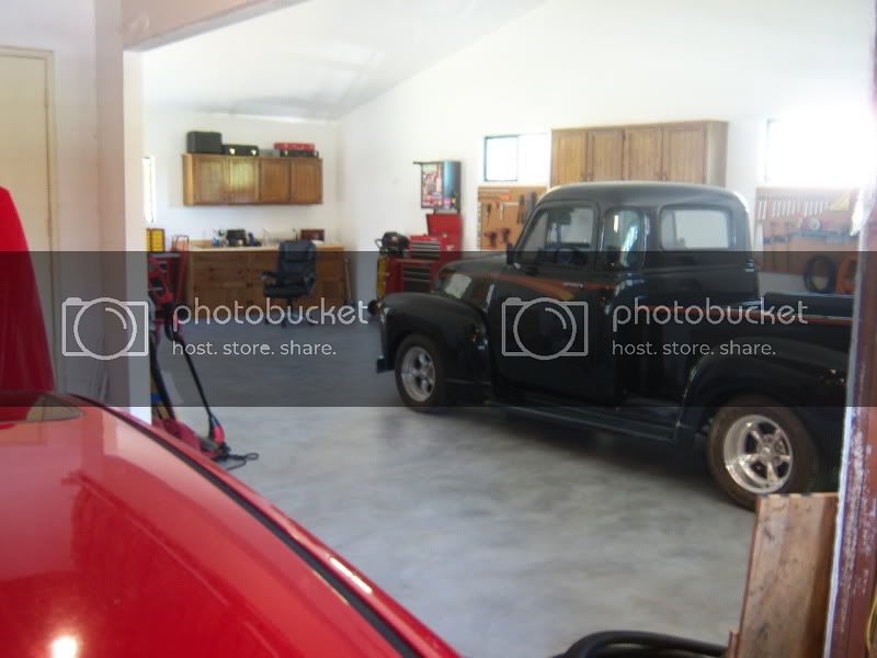

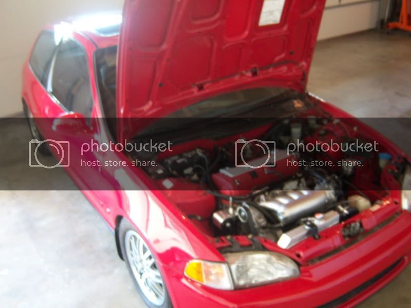

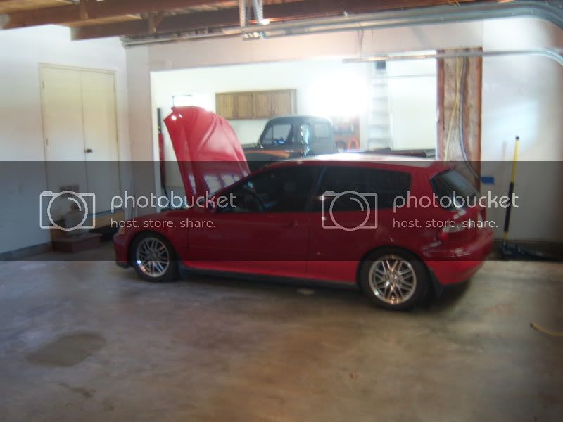

Took a bunch of pictures to share (after I took pics of wiring up the conv harness and imm. bypass) because its all I can do with the P.O.S.......I was suppose to be having fun and driving it around by now :( They came out like crap but I ain't no photographer.....and (obviously) no K-swap expert lmao
At least she has a nice place to be stored lol
My dad's dream garage is getting really close to done! This is a okay shot of his 800sqft addition. The Chevy Truck is half torn apart inside so it isn't running either!!

now thats what i call a garage.. i'd like to extend mine out to the side of the house to the RV parking because i dont and wont have an RV any time soon.. lol
