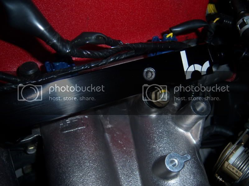

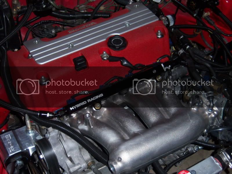

Here's a few pics.
The allen head bolt can be seen here. You can see some of the thread sealant too.
What's the purpose of the allen? To plug an unused port that could hold a pressure gauge?
That thing looks really nice - it outta scream. How much HP in that engine?
Yes its a port for fuel pressure gauge but mine is on the FPR so I just plug it. Both port and allen head plug are conical shaped
Motor is stock 220hp at the crank but I would guess I'm around 240 at the crank with the bolt-ons and RBC IM (so I am guessing damn close to 200whp)
6-spd LSD 4.7FD transmission
I should be in and around 225whp once I get K-pro and a tune (Spring hopefully) then close in on 250whp with some camshafts/springs/chain tensioner/70mm TB/RDX injectors. Should be at least 240's
