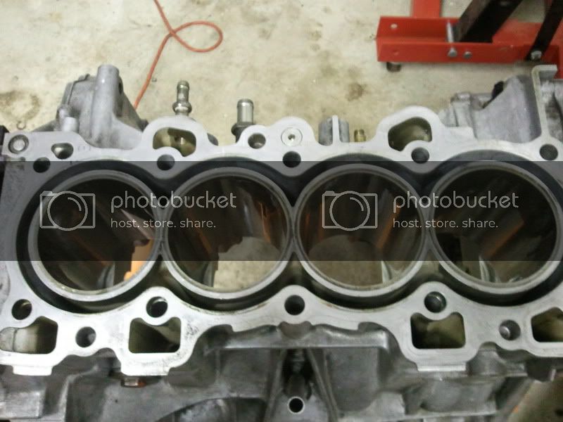

Block came back from a coworker who bored/honed it to 81.5mm

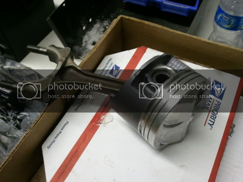

Also had PCT (ctr) pistons pressed onto my stock rods

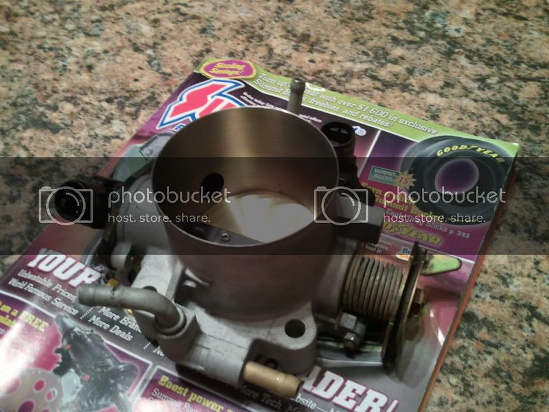

Ported ITR throttle body arrived back from Maxbore.

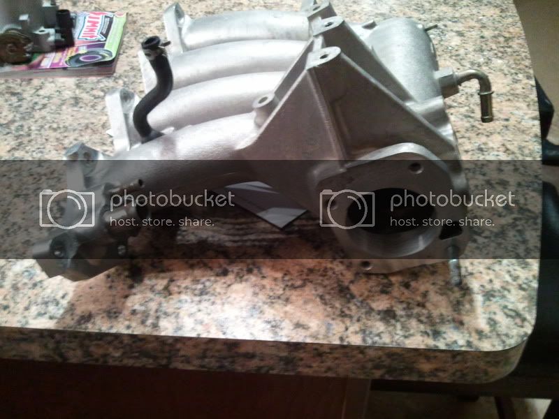

Went ahead and had the ITR intake manifold port matched...
