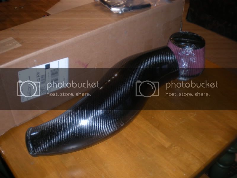

More updates! I have most of the needed parts and started assembling the motor. Whale dick intake:

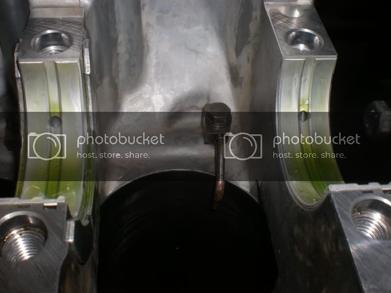

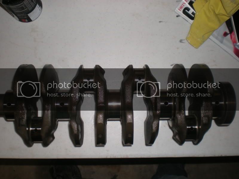

Cleaned all of the bearing surfaces of the crank & block with brake cleaner and a lint free rag.
Dropped in new OEM main bearings and cleaned oil jets
Carefully setting the crank into place:

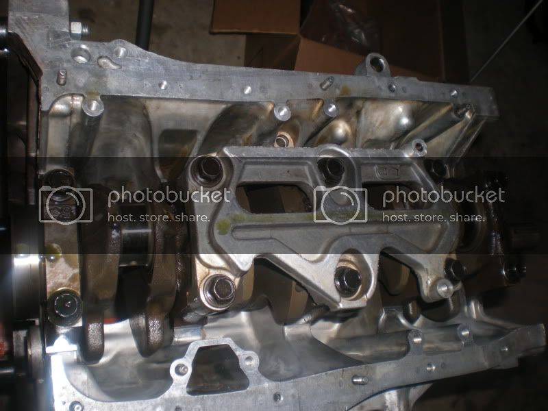

Got the main caps & block stiffener torqued to spec. The crank spins nicely. Clearances seem to be good.

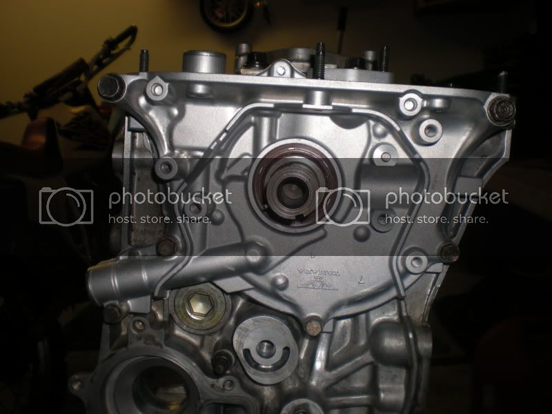

Brand new ITR oil pump installed:

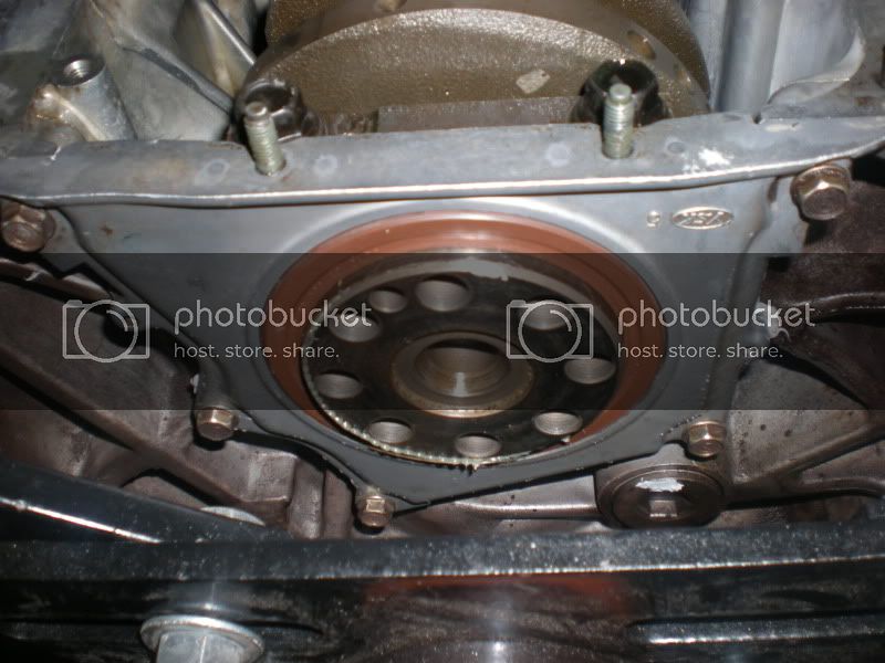

Installed rear main cover with a new rear seal. I used a square piece of 2/4 to evenly tap it into place.

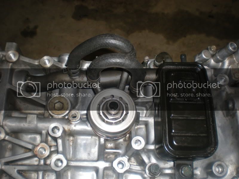

Also got the coolant pipe, oil cooler, and pcv box installed
