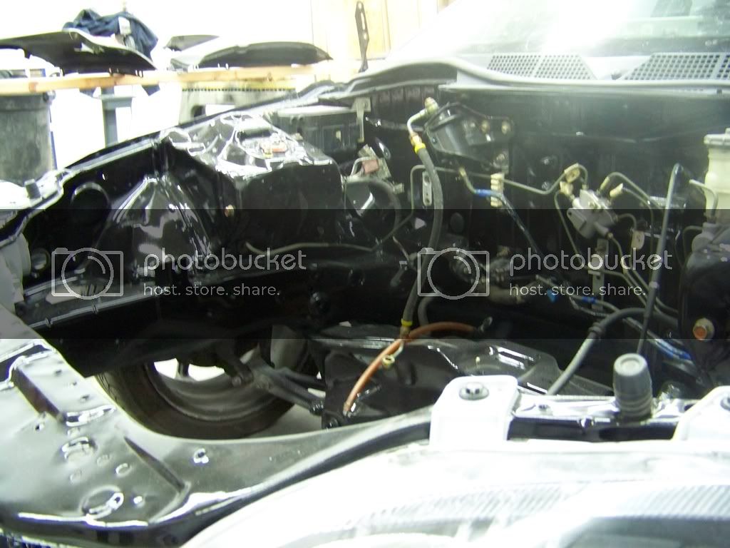

On a good note, I got everything in the engine bay squared away. Its ready for the engine to go back in. Hopefully I'll get off at a decent hour so I can snap some pics of it.

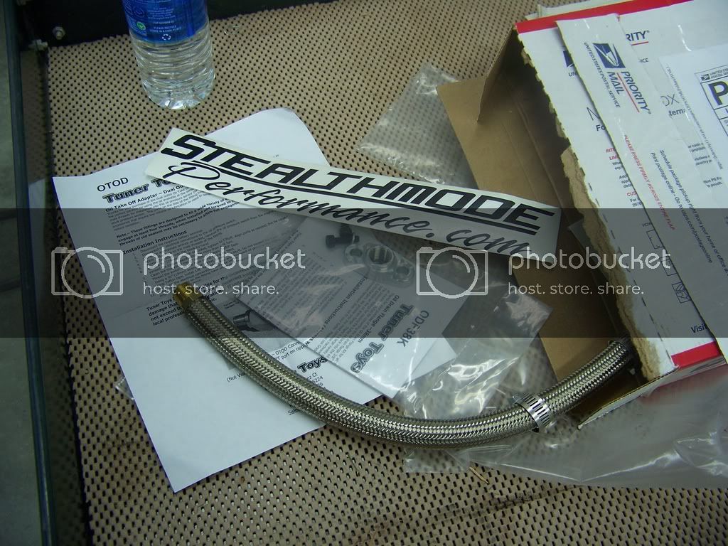

Stealthmode oil lines are here. Looks like a great kit. I'm going to dry fit it to the block tonight just to be sure that everything lines up right.

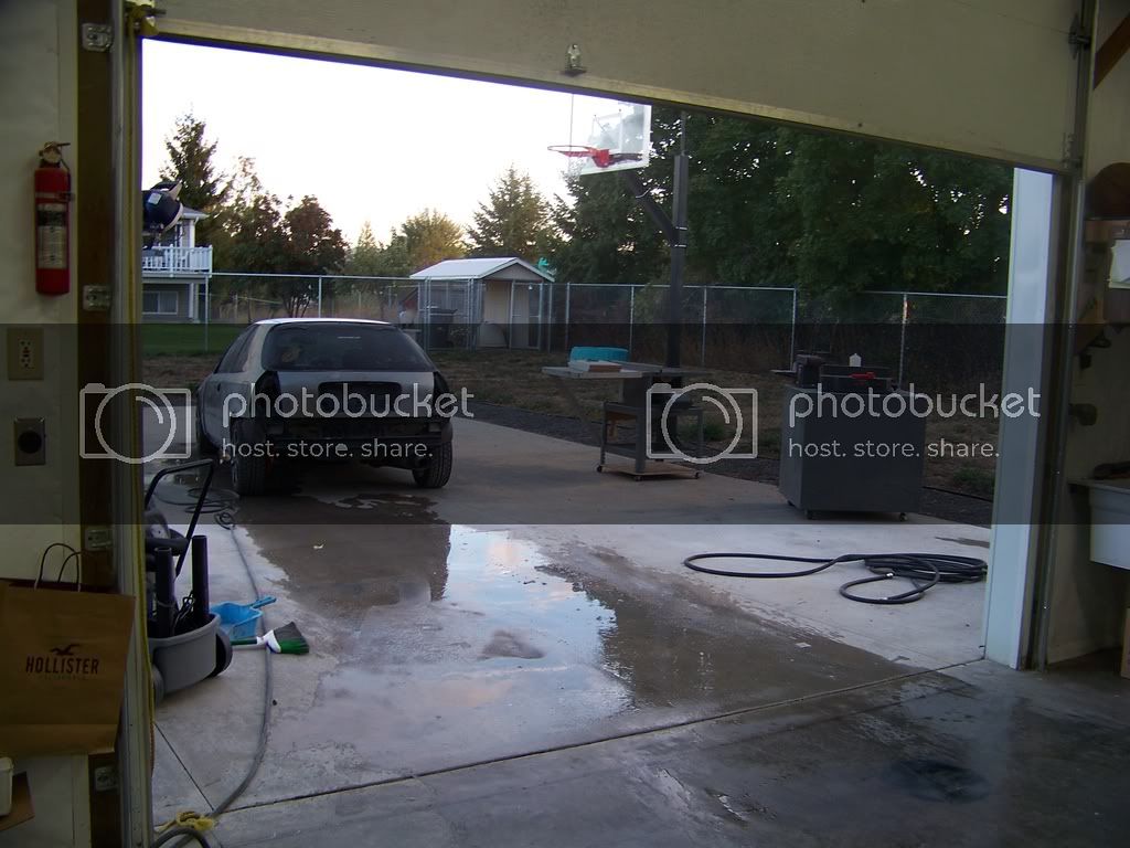

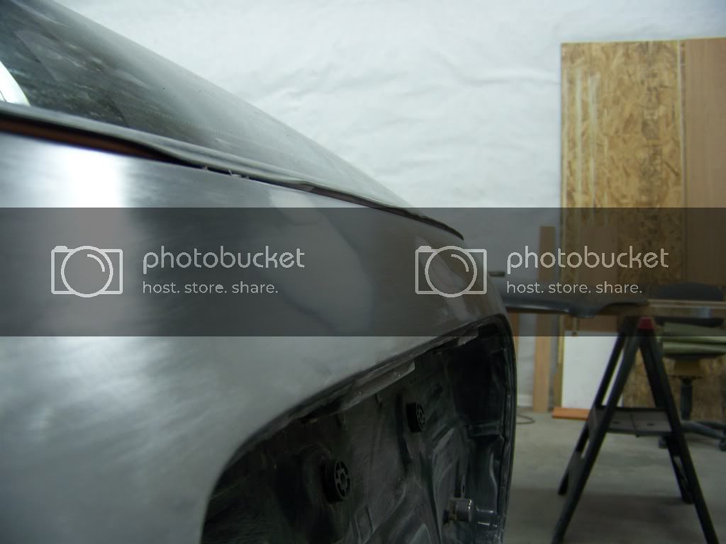

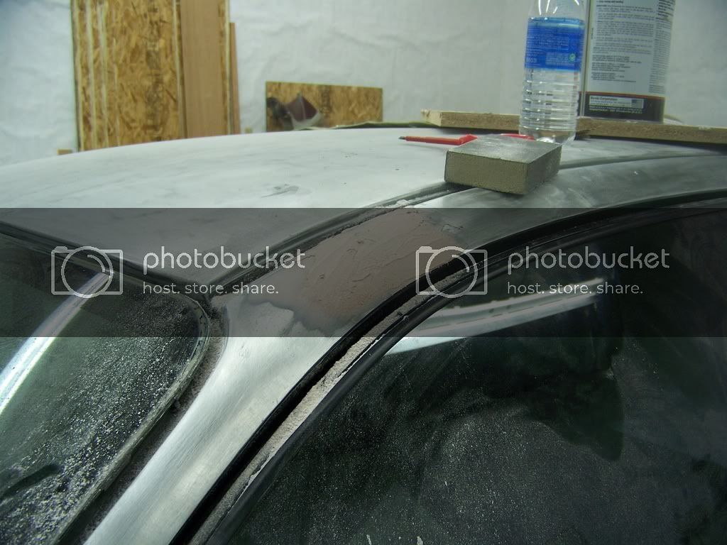

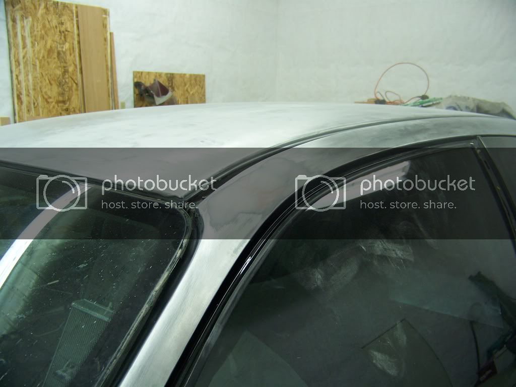

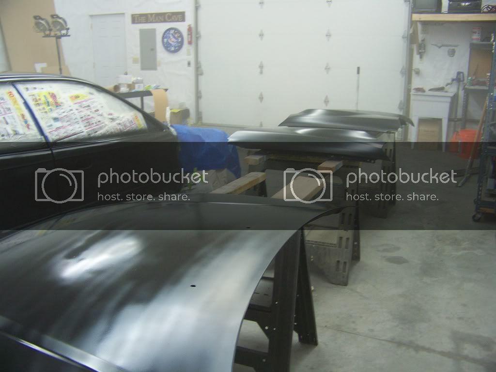

Finishing up the last of the sanding on the shaved spots tonight, and beginning to clean the shop out.

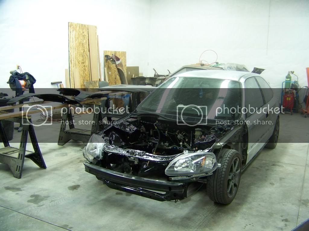

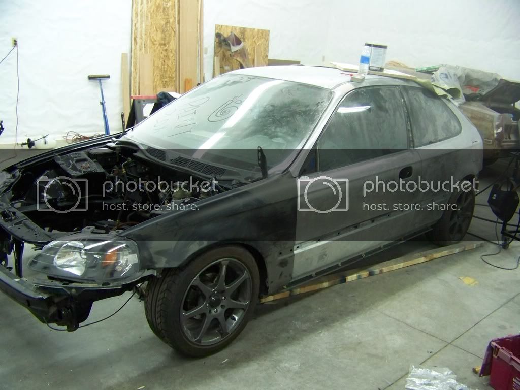

Its been awhile since I have posted pics of my little beast.. well here's quite a few, and a few pics of the shop as well.
I love my new suspension.. tuckin like a mofo. No engine in, so it will probably sit a little too low with the engine in.. which means I'll have to adjust a little.

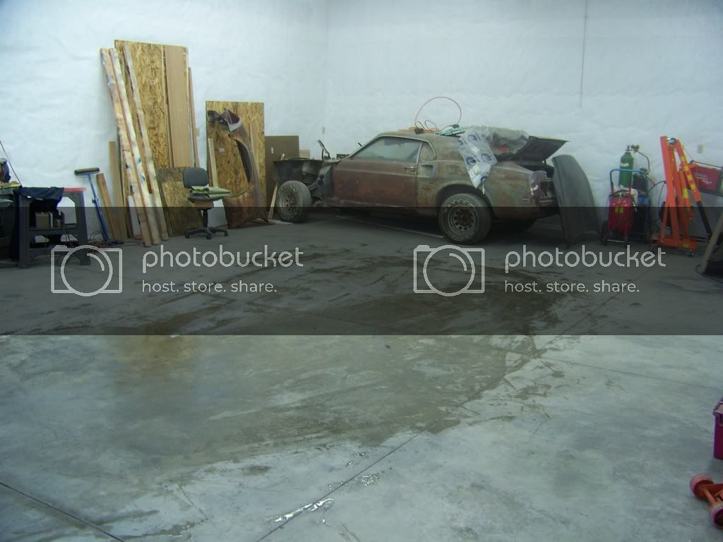

How things were sitting prior to cleaning.

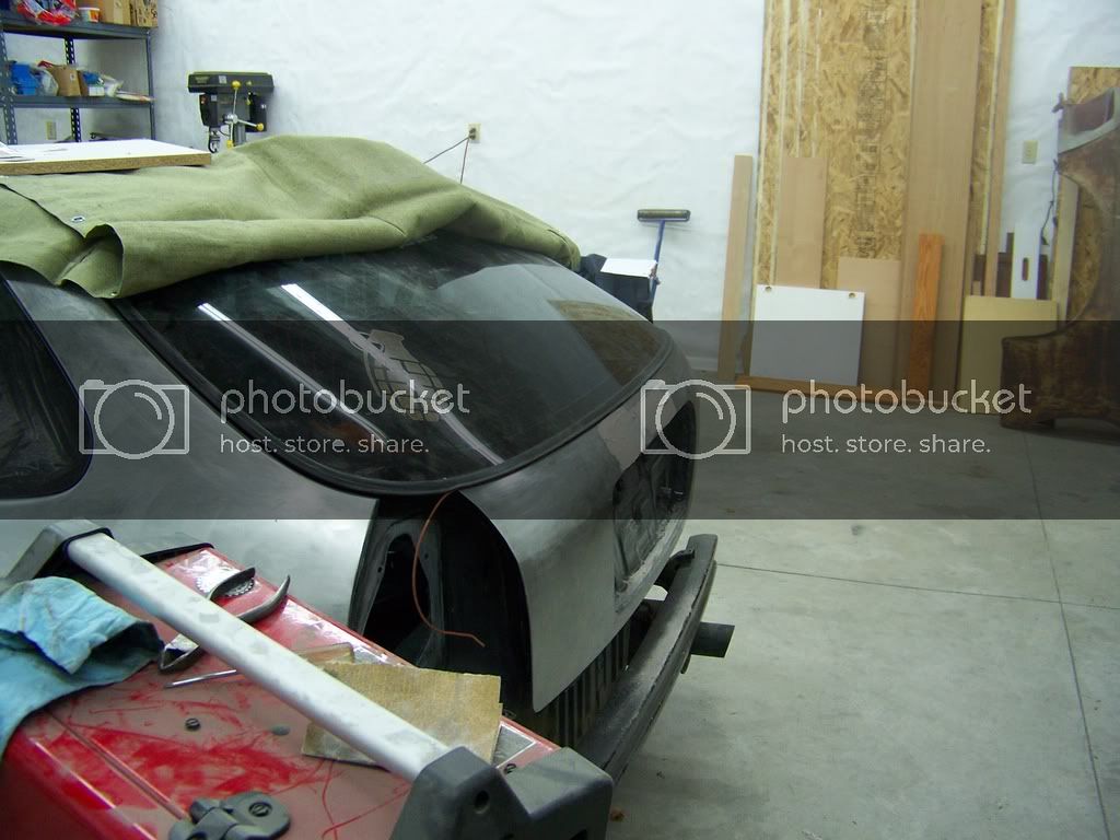

In the process of filling the antenna hole
And the rear wiper/emblem holes

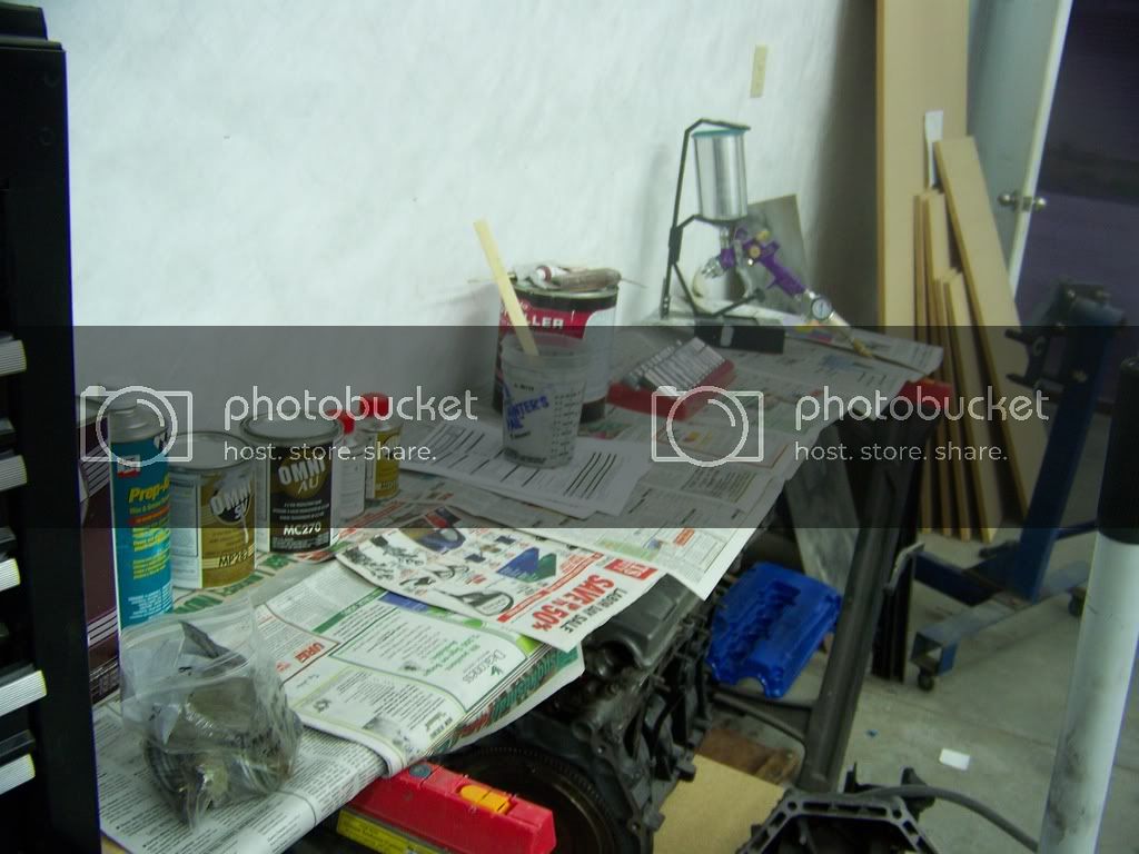

Man this place was dirty, and primer doesn't lay down too well with a bunch of dust in the air..
So out everything went..
After sweeping and wetting down the floor then clearing it out, this is what I was left with
Finished up the sanding on the antenna..
And on the rear wiper/emblem holes
This is what it looks like now. Neat and organized.

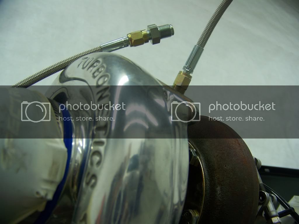

Stealthmode oil feed/return kit
Shot of the feed line attached

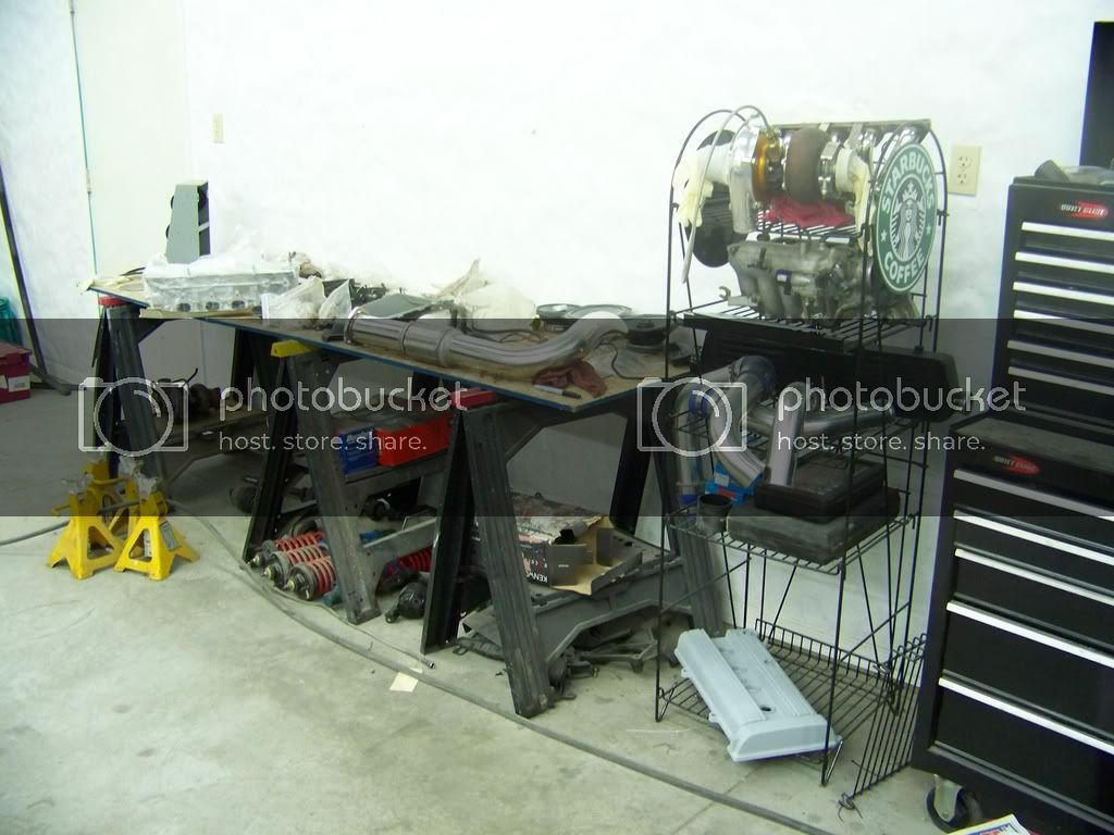

Where the turbo sits for now..

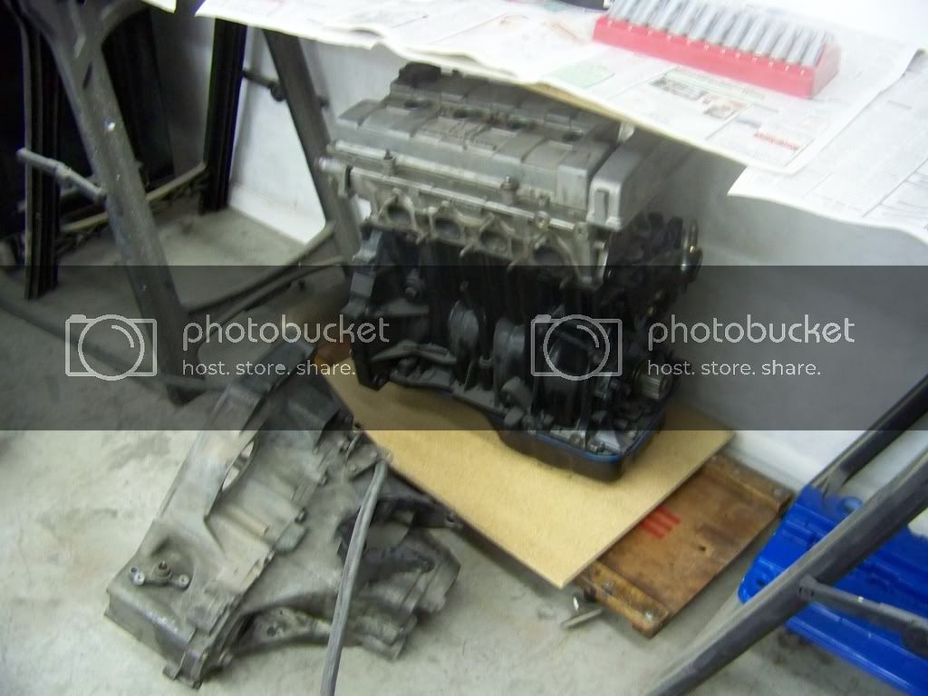

And the powerplant.. hiding under the table for now.

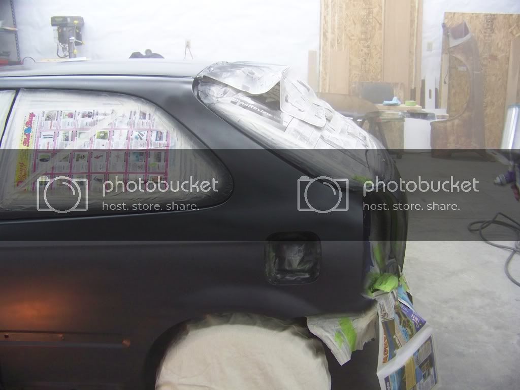

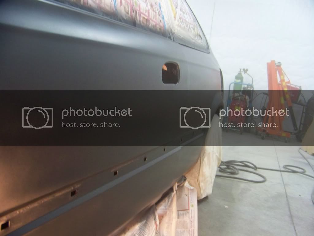

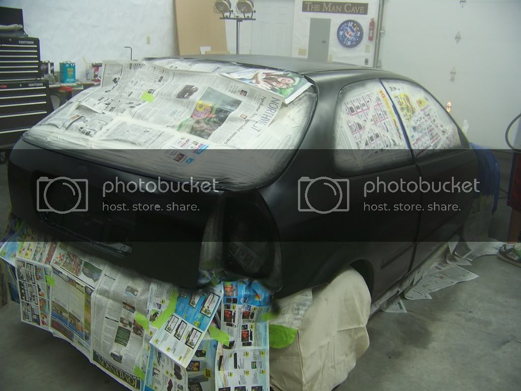

Anyway, I'm in the process of laying the sealer on the car right now. Should have some pics here in a few to show you all.
