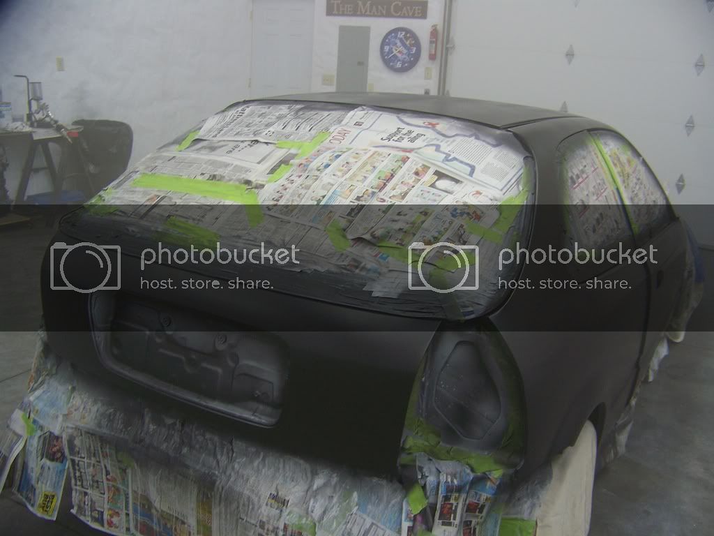

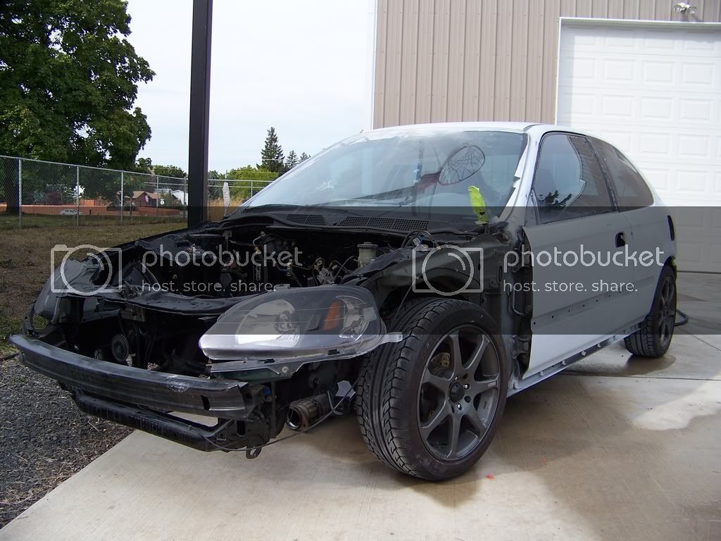

Well, here's your update. 56k I'm sorry.. but you're about to be molested. These are from yesterday though, the camera is dead (go figure) but the car IS PAINTED. It looks good. I'll post up pics and better details tomorrow. Anyway, on to the other pics now!

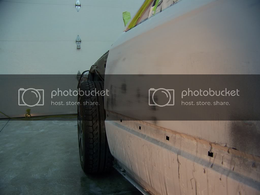

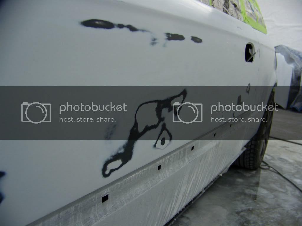

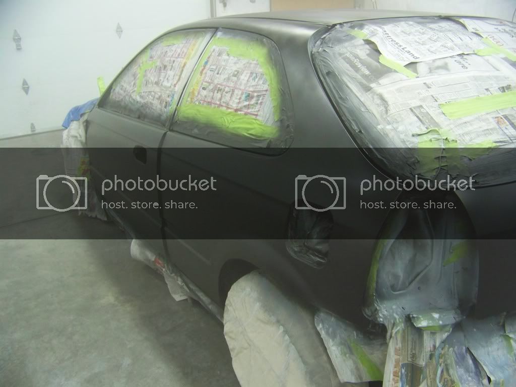

Okay so this was the second layer of epoxy primer. This convinced me to go back and do another layer of sandable primer:

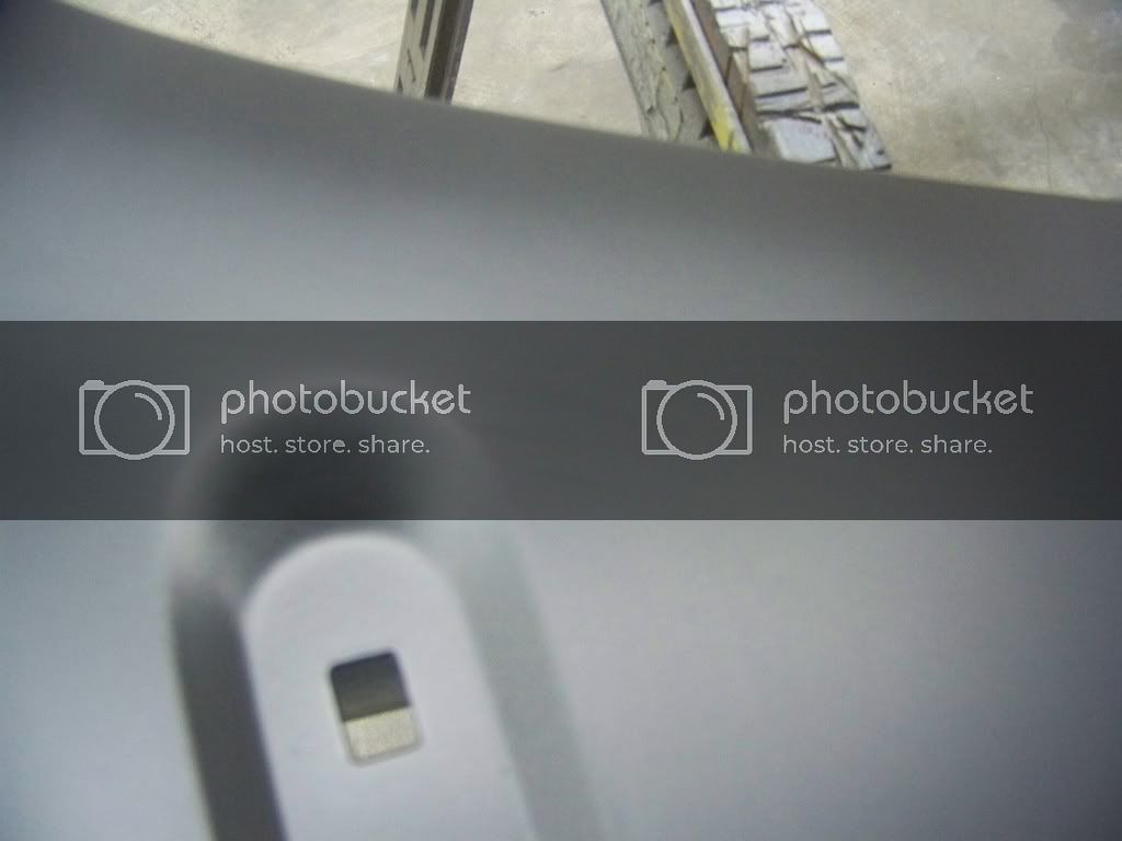

An up close shot of the sand marks that drove me crazy, kinda hard to see:

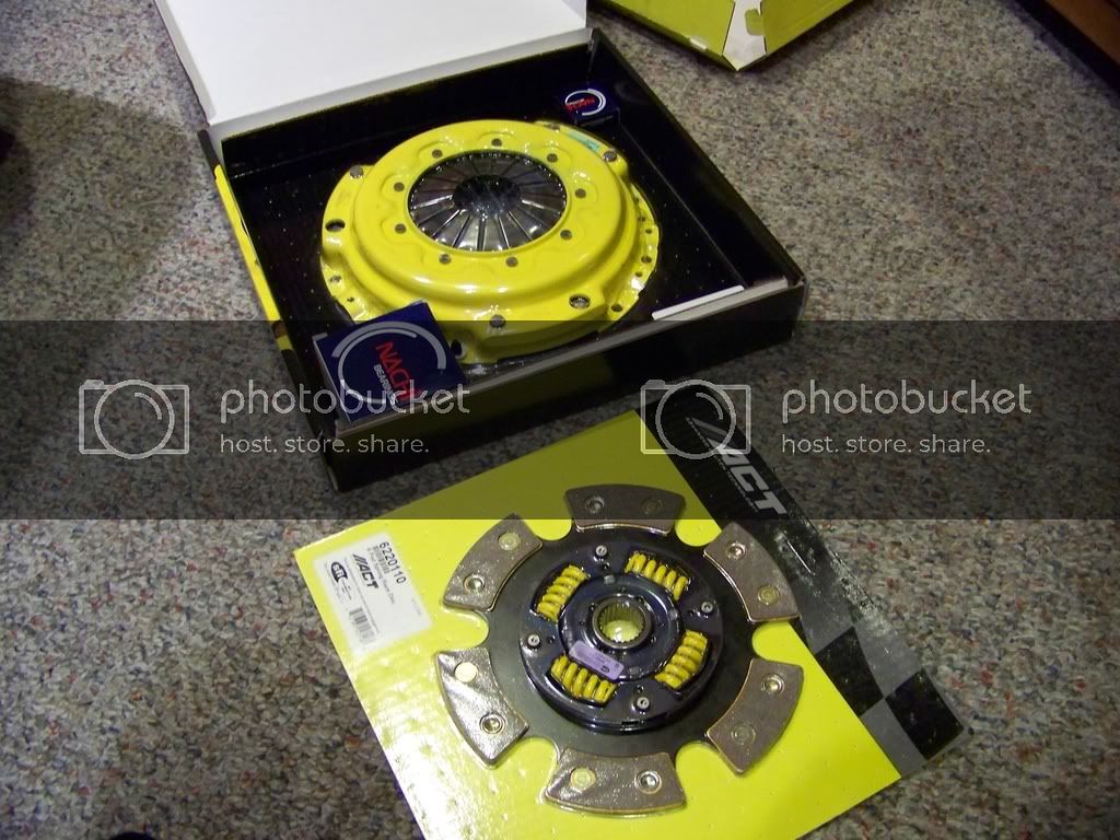

CORRECT ACT Clutch! 6 puck FTW!'

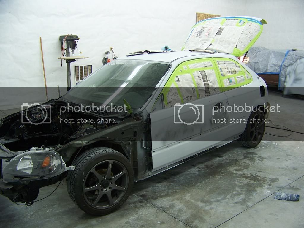

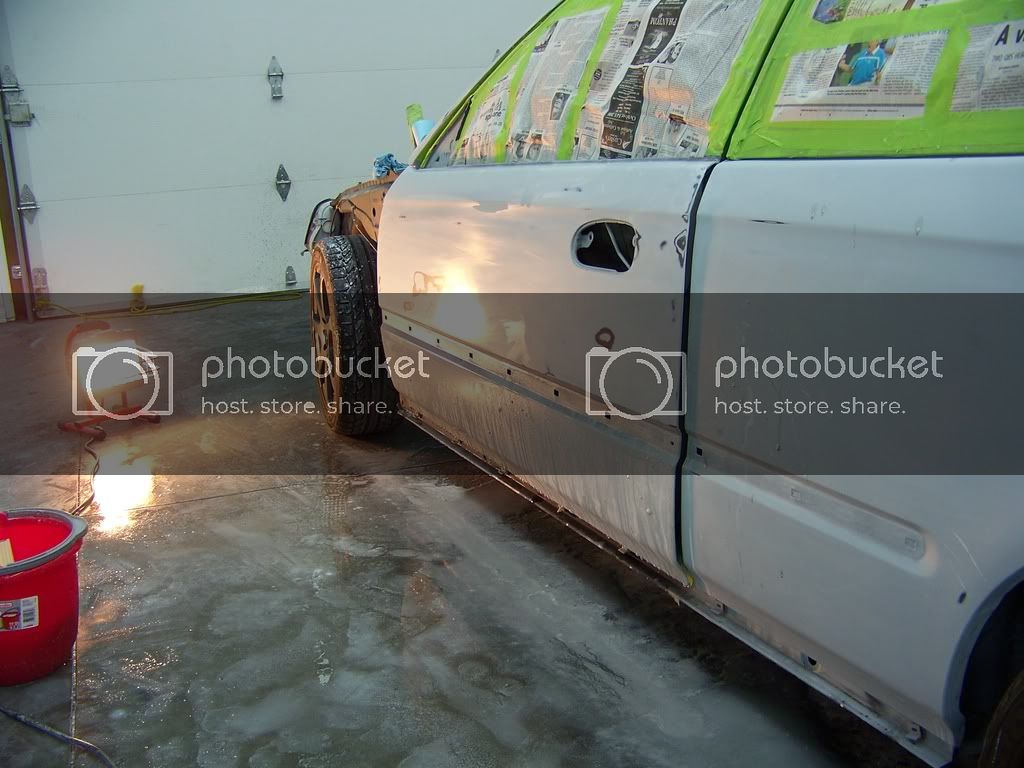

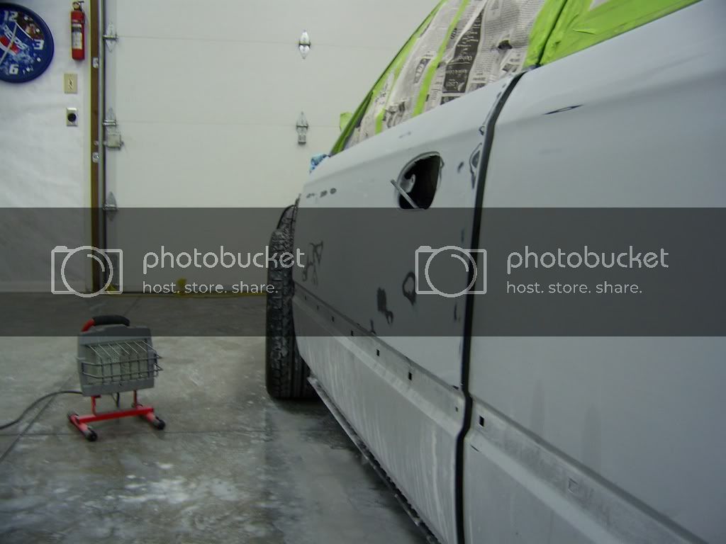

After the second coat of sandable primer and some wetsanding this is what I had:

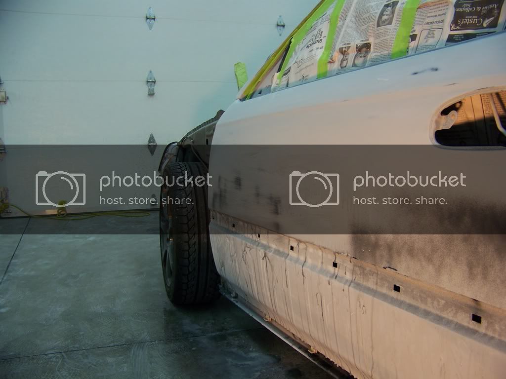

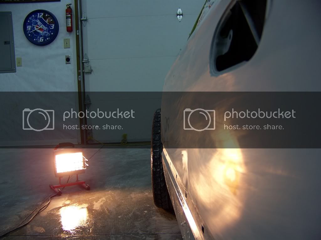

Pretty straight, but this was before I guide-coated this side and found some ripples:
Passenger side looked great:
Roof looked pretty good as well:
Got it back inside and guide-coated the driver's side door:
Random shots

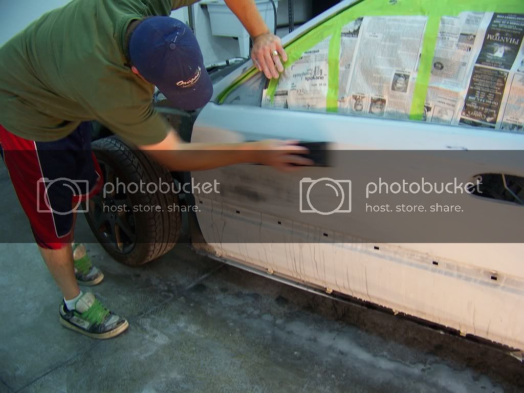

Out came the wetsanding stuff again, here's my dad workin while I take a pic lol:
And of course my dad didnt last too long wetsanding ;)

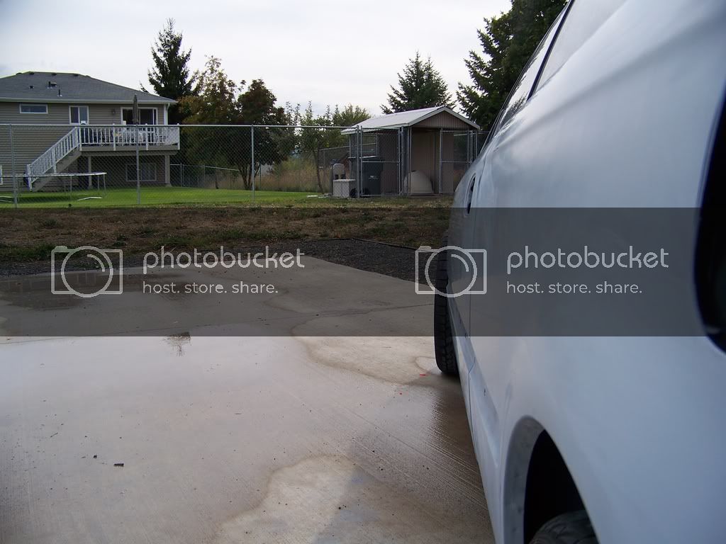

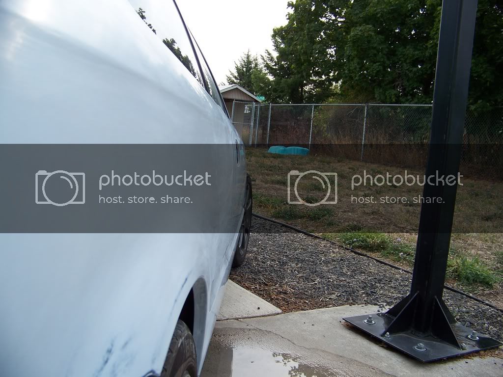

Progression through the layers of sandable and epoxy primer:

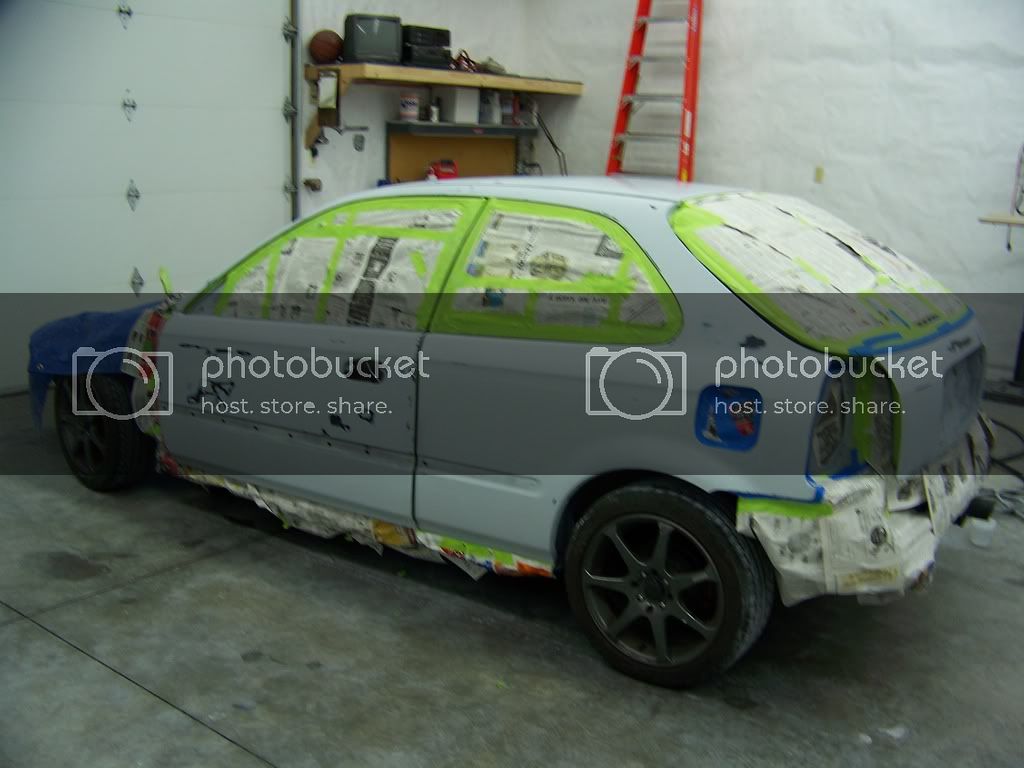

And this is what I finally got it down to. It was completely flat here. You can look at it in any light and you wont find a single ripple anywhere on the car. Took some time, but def. worth it!

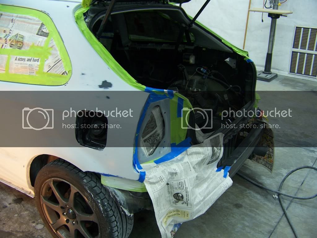

In the process of masking it off:

Nighthawk Black Pearl is the final color. Its a pretty cool color. I wanted to keep it close to stock, since I'm only fixing a couple spots in the jambs.
