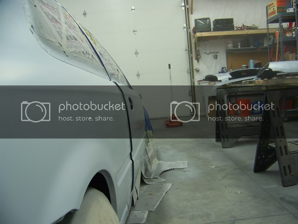

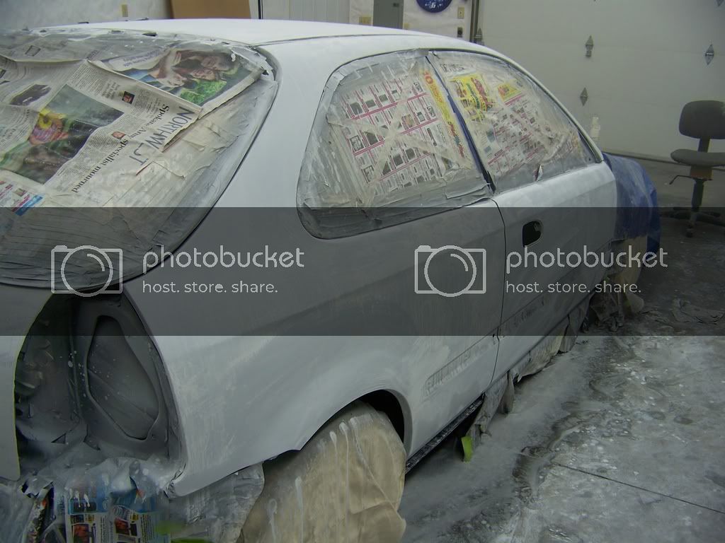

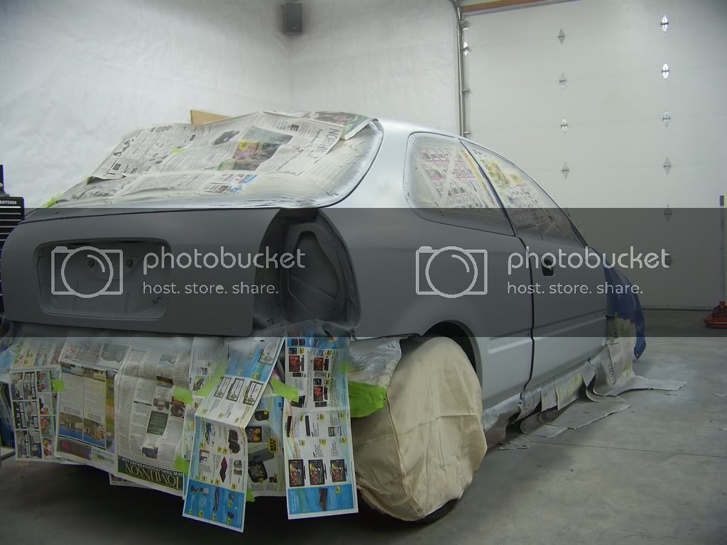

UPDATE: The primer/filler is going on the car right now.. and its white ^.^ my car looks really wierd white. But anyway, I'm now realizing why I did all the prep work, its really paying off. This car is REALLY flat and VERY straight. I have two dents to focus on, if the primer/filler layer doesnt take care of that some filler will :thumbsup:
Moral to the story is: Prep work is everything, the sanding prior to paint is just as critical as the paint itself.

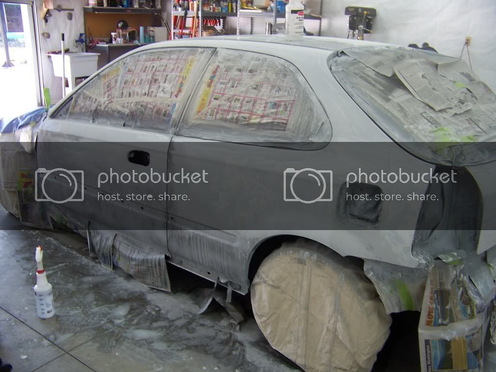

I haven't actually painted the car yet. Its just primer. It took me all day today to block the car and get it flat. But man, its incredibly straight. I got rid of all the door dings and what not. Looks great.

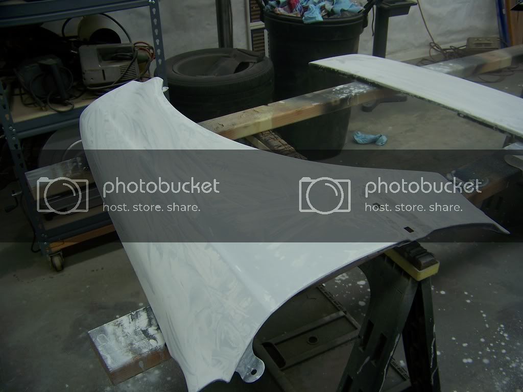

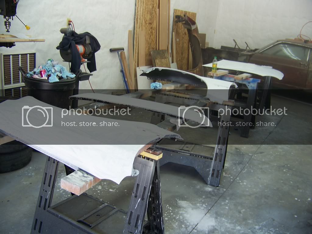

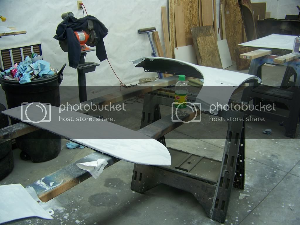

Primer/filler:

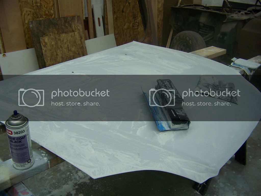

Wetsanded/blocked, some shots of l guidecoat in here too:
This stuff is magical, a must:

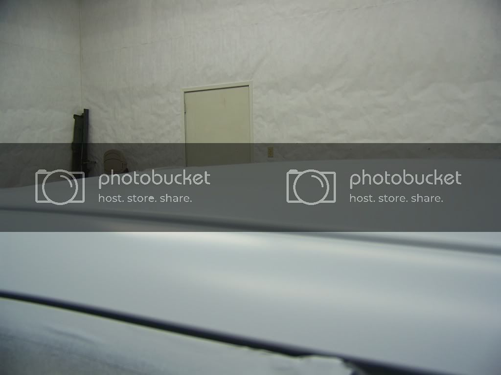

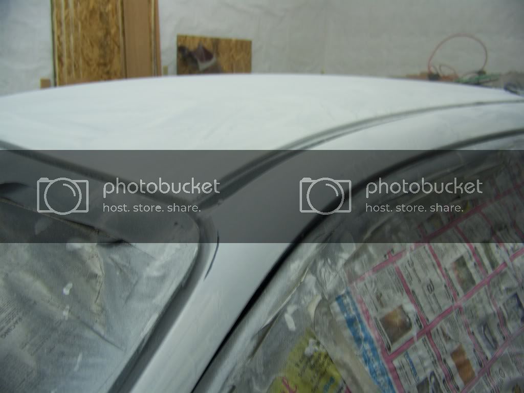

Again, the prep work really paid off. The shaved areas look as if there was never a hole there. I love the way this is turning out. Hopefully some updates tomorrow if I am not too tired after work. :thumbsup:

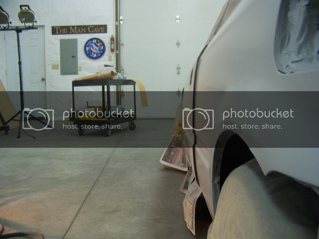

I spent 4 1/2 hours cleaning the shop. Its extremely clean, hopefully everything turns out well. Tomorrow is the day! Laying down the base and clear. I'm sure I'll have PLENTY of pics tomorrow and sunday. Hopefully by monday I can roll it outside and take some pics in the light. :thumbsup:

I love the Man Cave sign in the shop.
Haha, yeah my mom got that for my dad for christmas :P

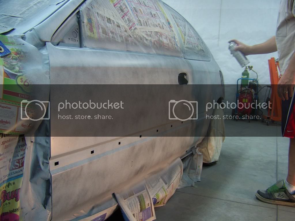

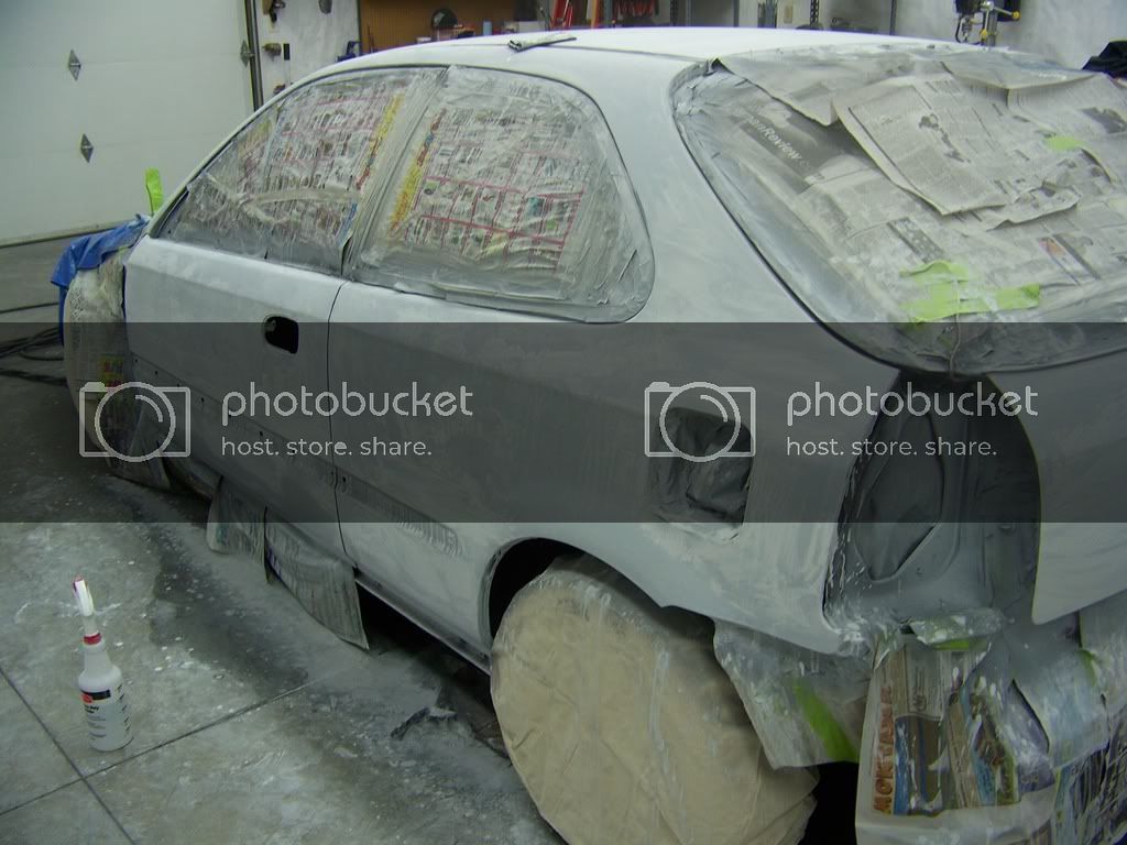

Anyway, as for progress tonight nothing crazy but some good progress nonetheless. I sprayed another coat of epoxy sealer on the car and the fenders/hood/fuel door/spoiler and I can see a few places that need minor work. I'm sure most people would just go straight to the color and call it good, but I'm not that type of guy. Monday I'll be laying another light coat of sandable primer on the car and wetsanding again. This time I'll strip everything off the car and re mask the whole deal.
There are a couple spots where there are some light sanding marks showing, and I just simply cannot have that.
