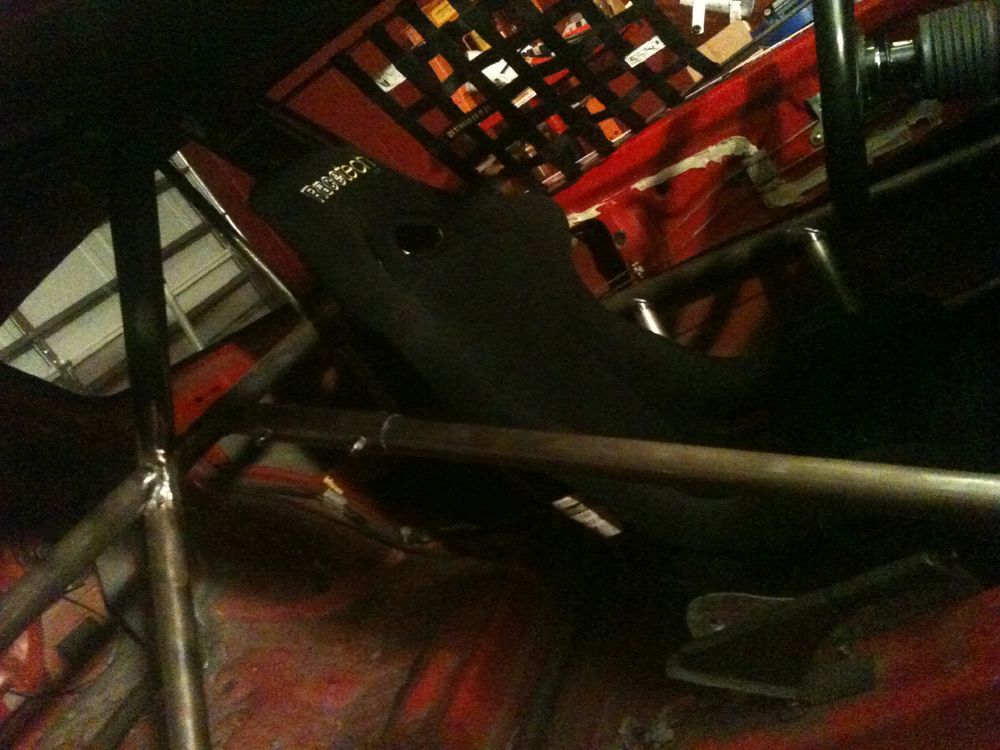

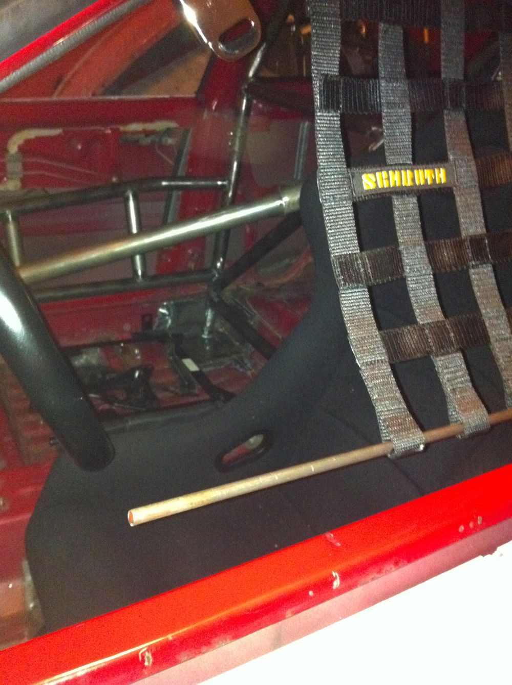

Yeah roll cage is done!
I just snapped a quick teaser until I can get some good shots.
I decided to add a petty bar and a few other little things. Im very pleased with the work!

i didnt even notice that bar at first. what is it ( where it is connecting) and what is the purpose. ive never seen that before.
Give me a sec and I wil snap an iphone shot.
You can see the vertical rod I had him add as well for my right side net to wrap around.
edit:
The Petty bar was added to nascar after Richard Pettys horrible crash in 1988. It adds additional stiffness to the roll cage overall and car. The safety aspect is that it gives you even more protection on that side of the car if you were to go head or right front into a wall. The connection point is off the ecu area meeting the firewall.
