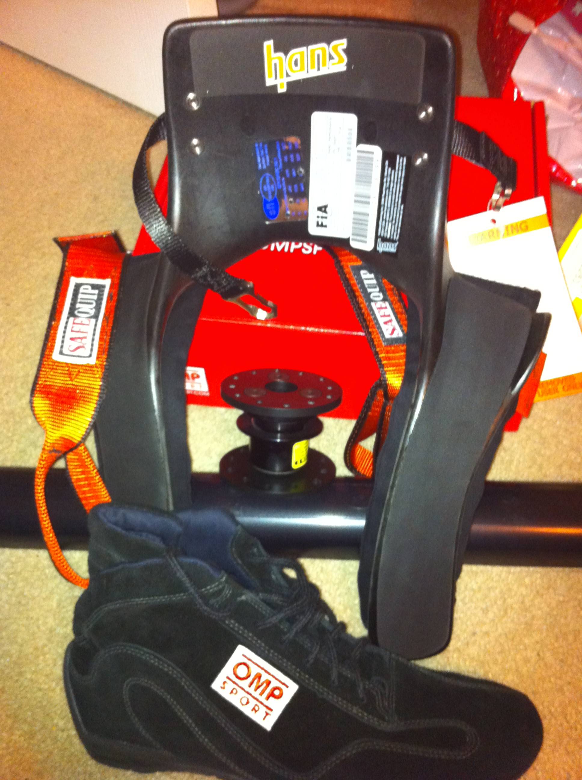

Some of the last pieces came in today.
Hans, 3x36 inches of sfi roll bar padding, ltb quick release, safequip tow straps, sfi omp sport boots, redline mtl, motul 600.
Awesome, glad to see you went with the HANS.
HANS didnt give me much of a choice putting dfender out of business lol. I guess if they were guilty of infringement so be it. Im not dropping that tpe of money only to have the company not be able to service the product if needed. So HANS it is!

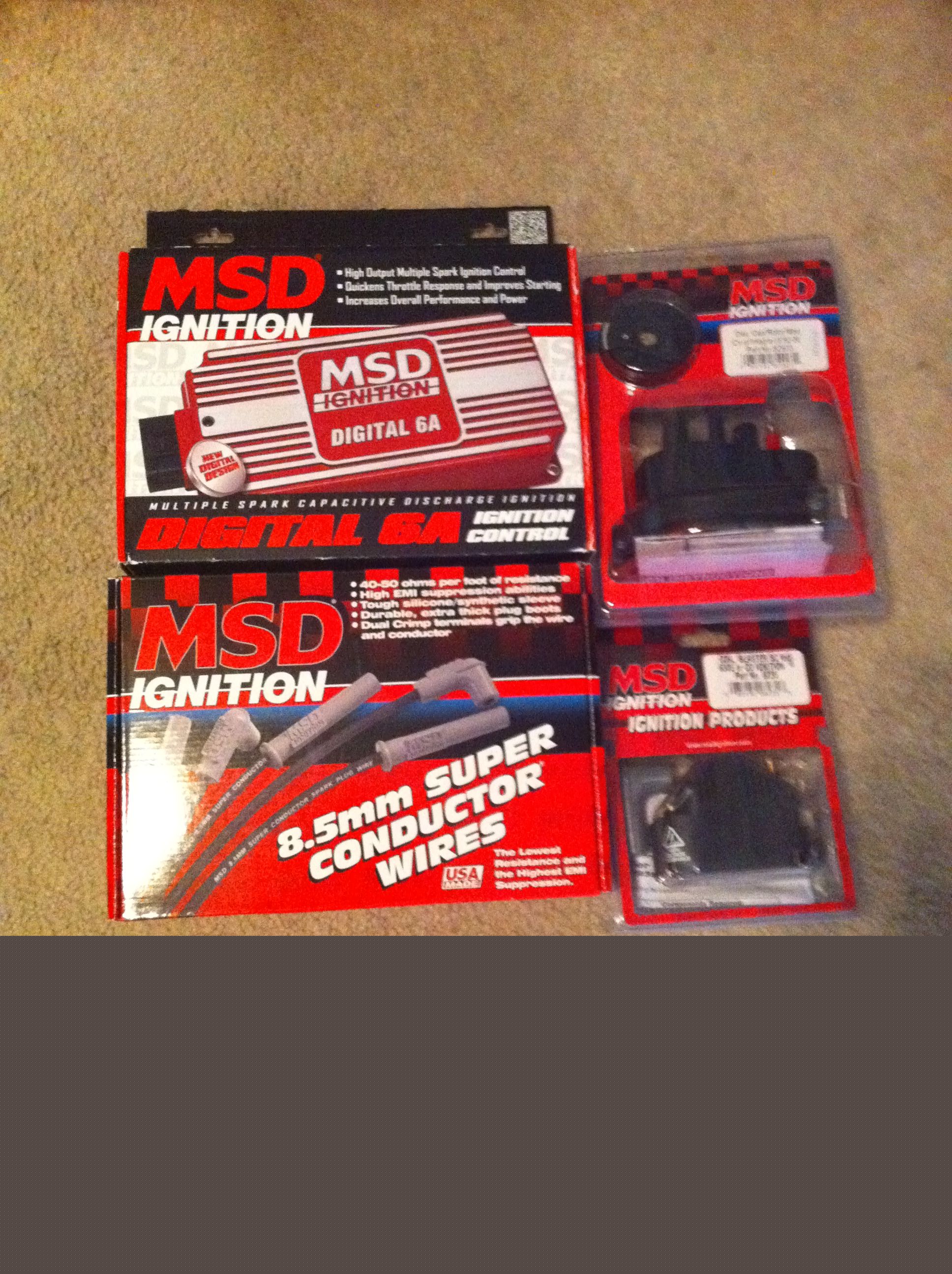

MSD 6A digital ignition that came out recently, much cleaner and has a small profile. MSD blaster sc, MSD wires and cap.
Honda ignition is great but I would rather not have it go out on me at the track which I have seen happen often with some of my fellow scca club guys. Im starting it without this installed just to get it running. I also have the ever so important back-up igniter as well and transfered almost everything over internally from my gsr distributor.
