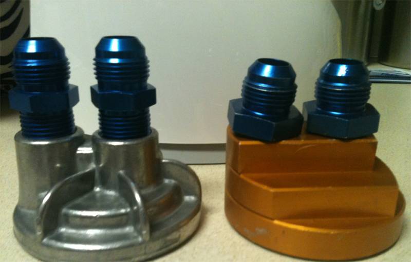

One little snag I had is finally corrected. I was trying to find an exact replacement for my oil block off adapter for my ebay oil cooler setup after I had a friend tap it and destroy it for me.
I got this setup from pegasus racing with fittings for $30 because I couldnt find just that piece. I could have run it like this but it is a critical thing to not have properly hooked up and have potential oil leaks causing me to crash or have someone behind me crash.
I wasnt going to risk it over $30.
You can see how jacked the adapter on the right is from a shitty tapping job. I didnt have a drill press and he did and apparently didnt give a shit. I can now finally hook up the oil cooler and check oil psi and oil temp to check and see what weight oil im going to run to try and maintain about 10 psi per 1000 rpms.

Why did it need to be tapped? Wasn't it already tapped for fittings?
It was tapped and came with fittings already but barely even tightening one of them and it snapped off.
I couldnt figure out what size it was because it wasnt like a standard 1/2 or 3/16 etc. I called the ebay people I got it from and they didnt even know what size it was so that pretty much left me with tapping it out because I dont even have 1 local speed shop I could go to that I would be able to find the right replacements for.

what is wrong with the one on the left? nothing? thats the same one i have...

The oil adapter on the left is fine and what I replaced the messed up one on the right with.

Oil adapter is bottoming out before it seals so Im going to have to cut the oil piece down.

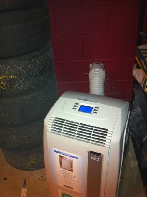

But I did pick this up to help my efforts.
Drops the garage temps down like 15 degrees or so!
80 degrees is so much better than like 95
I still have some touching up to do but its pretty much done and awesome.
youre not kidding. ive barely stepped out of my house because of the damn heat. all week had been like 95-100 with a heat index of like 115. fuck that noise.
thats the average summer here... put on your man panties and get outside
lol in my case my garage has no side doors or windows so the ventilation is terrible.
I should be getting some new stuff soon....still saving for the cage but almost there.
i feel ya on the ventilation.. my garage has one side door that i have to leave closed or the dogs will book it down the street.. no windows.. i've thought about installing a window in the garage
I totally would have done a window but I have an HOA and all I could do was a stealth dryer duct behind a bush.
Im going to add some flourescent lights because of how dark it is in there now.

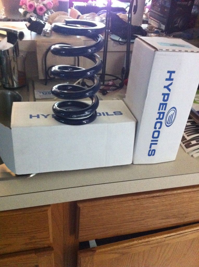

Im home today and these just showed up!
Hyper Coil 1100lb 7in rear springs, now I have 800f/1100r and I can always go back to my 500/800.
Wow......stiff stiff stiff. I need to learn more about spring rates. I know that track use should be stiffer than street use but what about road race vs. drag spring rates? I would like to know if there is something in the middle. I am on the fence when it comes to the direction of my hatch. One minute....I want to drag and hit N/A 11's......the next moment (after I watch a video like yours or Katman) I want to road race and pass domestic muscle all day long!
Nice! I'm thinking of picking up a set of 1100's also. I'm currently 800/900, thinking of going 900/1100.
