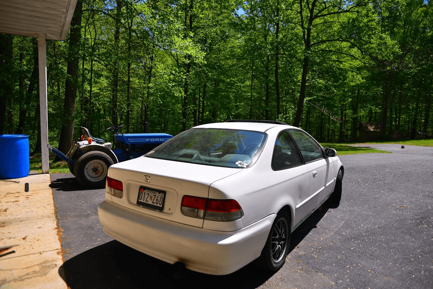

Look at all those dents, lol.
And that color mis-match:
It's a hoot to drive though. It's very quick and a very "connected" experience.
