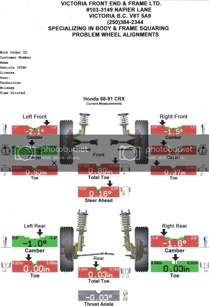

Bad news from teh frame shoppe today. Car iz bent from mah crahez. :<
~Frame is pulled back on the passenger side (side of impact)
~Rear cross member is tweaked where the LCA meets (the frame shop can repair it but I've got a spare)
~A couple seams in the wheel well have separated a little bit (not too noticeable)
~The mount for the upper control arm is pulled back a little bit which makes uneven camber left to right (related to bent frame)
~Little things like outer tie rods need to be replaced
~The knuckle may be bent but he said fix the other stuff first
The car CAN be straightened for about $400-$700 depending on labor time and parts that need to be replaced but I'd replace my own parts.
