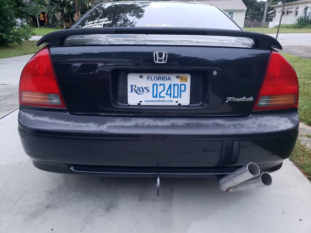

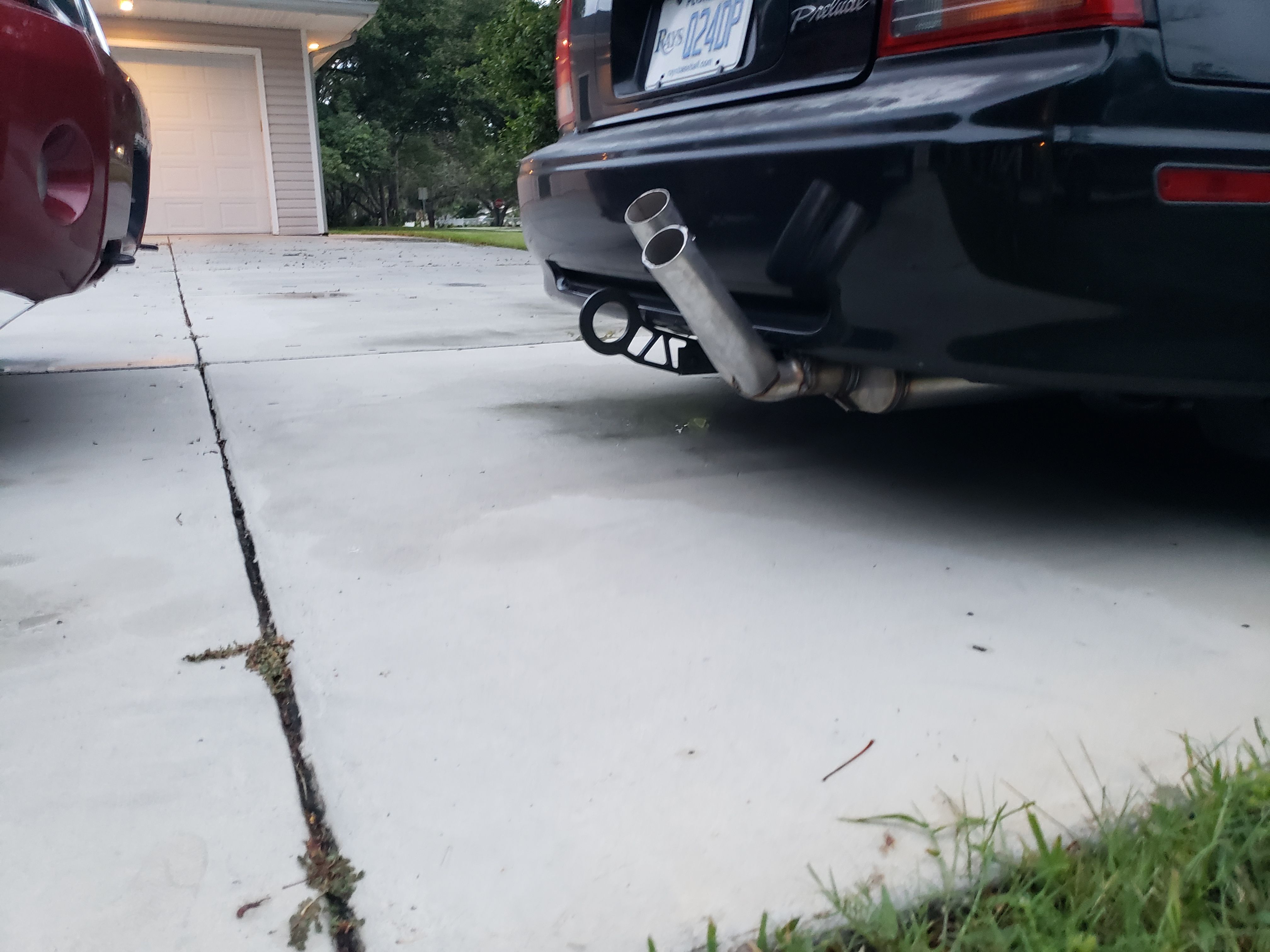

Rainbow Muffler is going to build it for 200, they patched exhaust on my blue integra and it looked nice and clean. It won't be anything too fancy but it'll be a start
2.5" straight pipe from the downpipe onward into a single muffler to keel it legal, with the Bosozoku tip. 240$ in all.
Roast me i deserve it.
