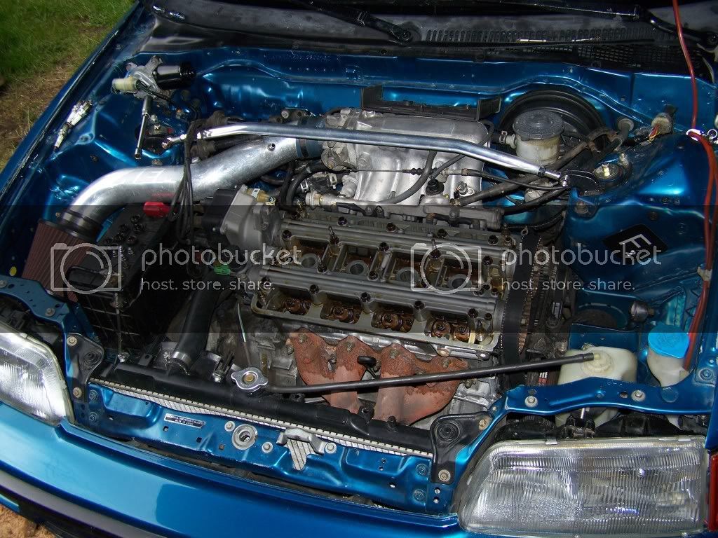

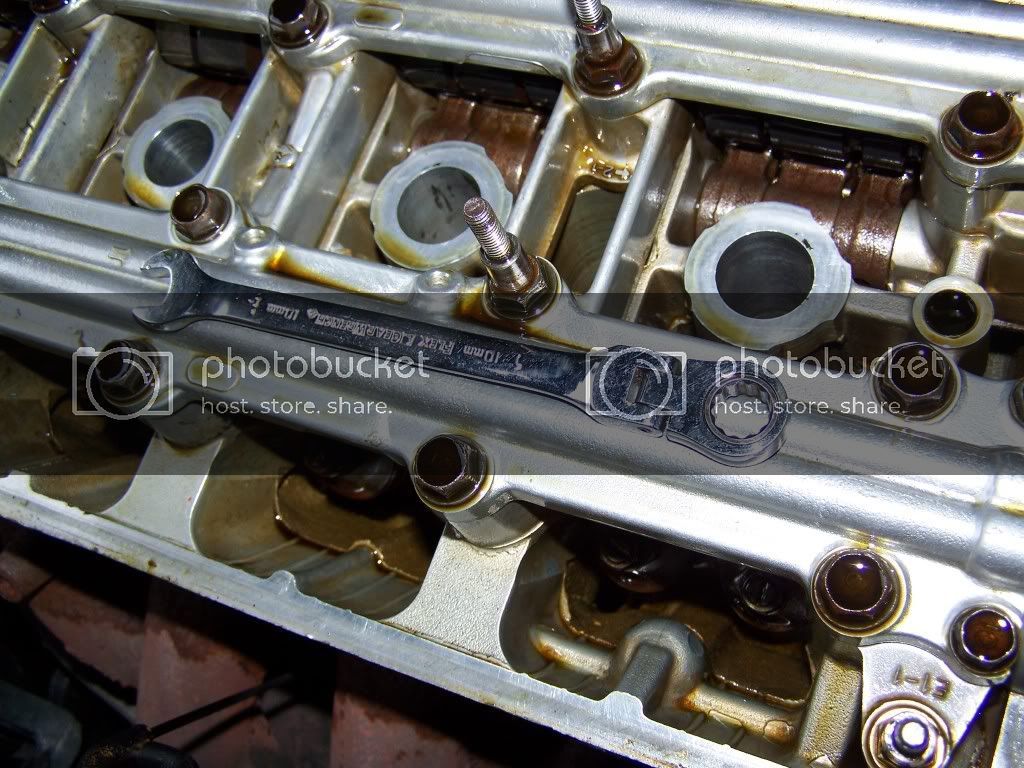

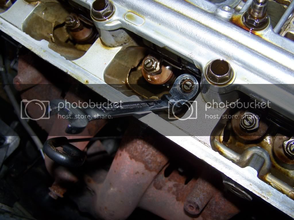

Going over the valve lash again.
My tool. :)

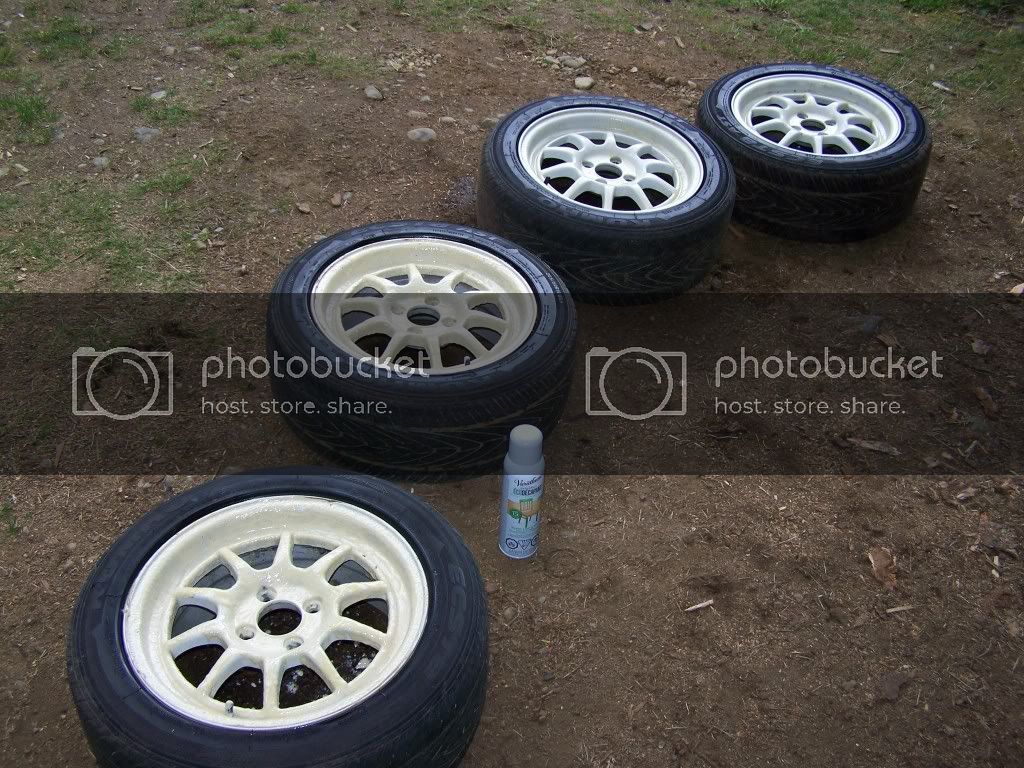

Spray on stripper on the wheels. Going to try them raw aluminum with polished lip or gold center if I get bored.

I set the valve clearances to 0.006in on the intake side and 0.007in on the exhaust and it still has a weird valvetrain tick. It ticks like 10 times in a row then goes away for a few seconds. And it sounds like it coming from the no. 1 cyl.
hmmm. you sure it's in the valvetrain?
maybe a loose cam lifter (?) the thing that opens and closes the valves
Also, check the oil pan for rod caps being either loose or maybe a bearing about to go.
just to make sure the ticking isn't down there.
I'm pretty sure the tick is in the head. I jacked it up and its quiet at the oil pan. After that tune up its running awesome now too so I'm just being picky.

It might just be the normal valvetrain sound. It drove me crazy thinking something was wrong at first with my Si when I replaced the original motor with a JDM B16A, but by every Hondaphile I know I was told it sounded normal.
Yeah my dad said the same. He said every Honda that gets revved high makes a little valve noise. :dunno:
Haha! Yeah mine ticks kinda bad when cold but sounds normal when warmed up.
