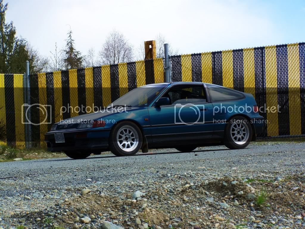

looking good man. what s up with the wheels?
I haven't been able to find a set of rims that I like in a CRX but those rims in 16's would be sex for my taste.
how much do those Work wheels go for?
Those in 15x7 are $950 from Infinit Wheels.
