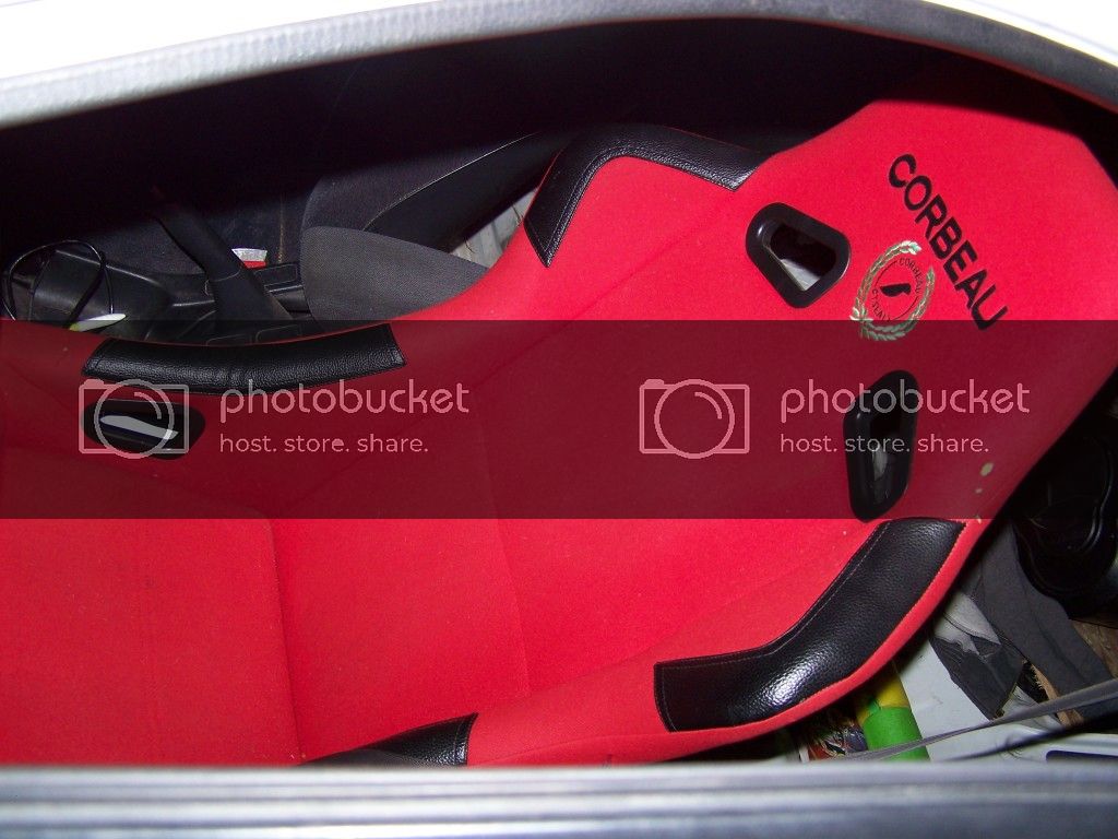

Corbeau Forza FIA Standard approved seats (Minty pair, $150, Pawn Shop)

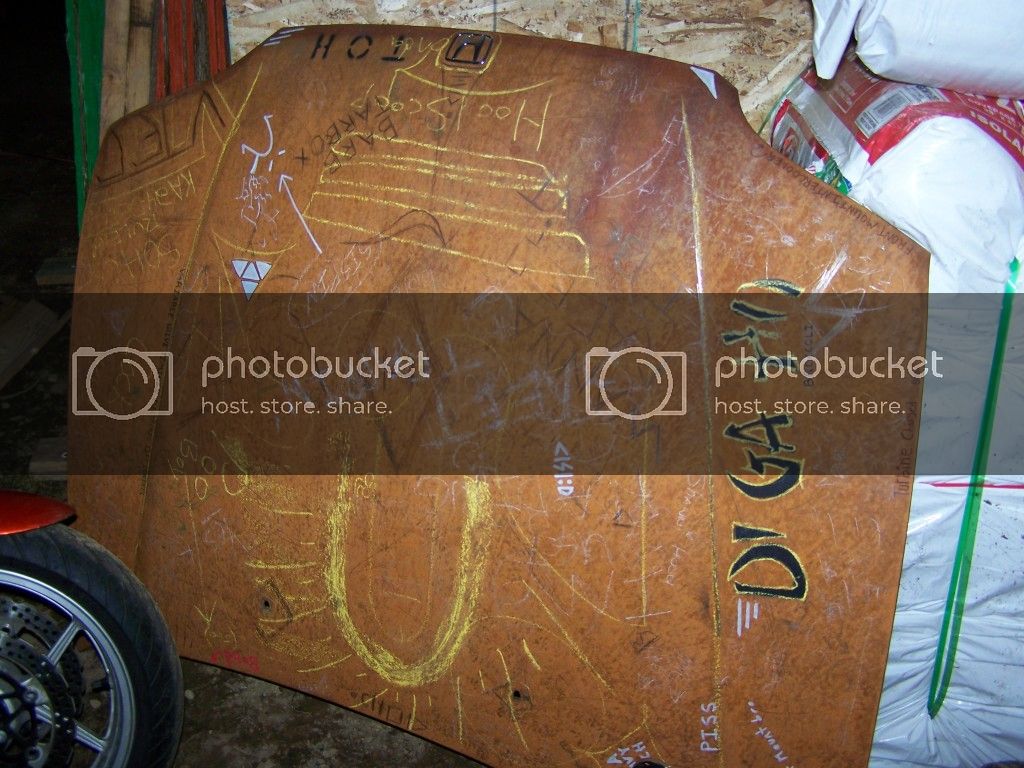

JDM Sea Water rusted hood (Wrecker, $30, had it on for a couple months then let buddies write on it (bad idea) now it's off)

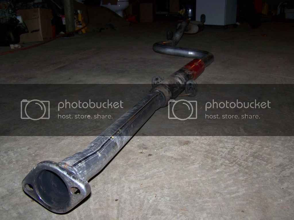

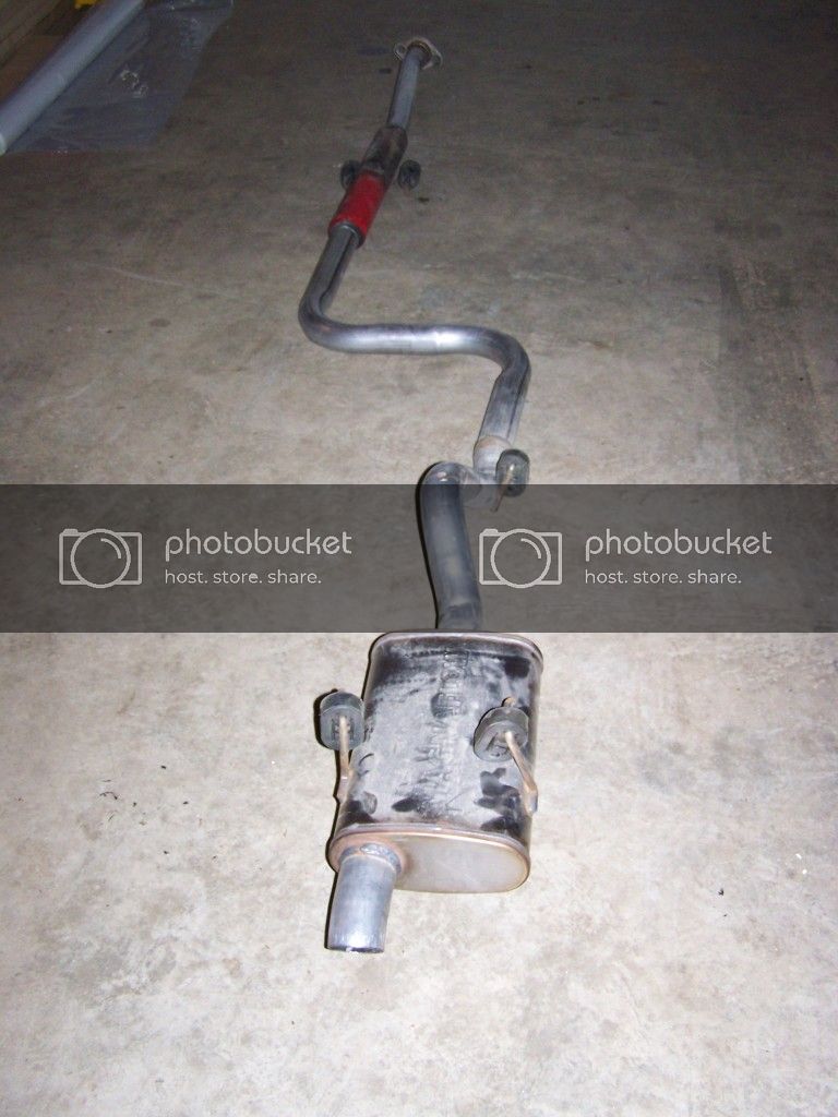

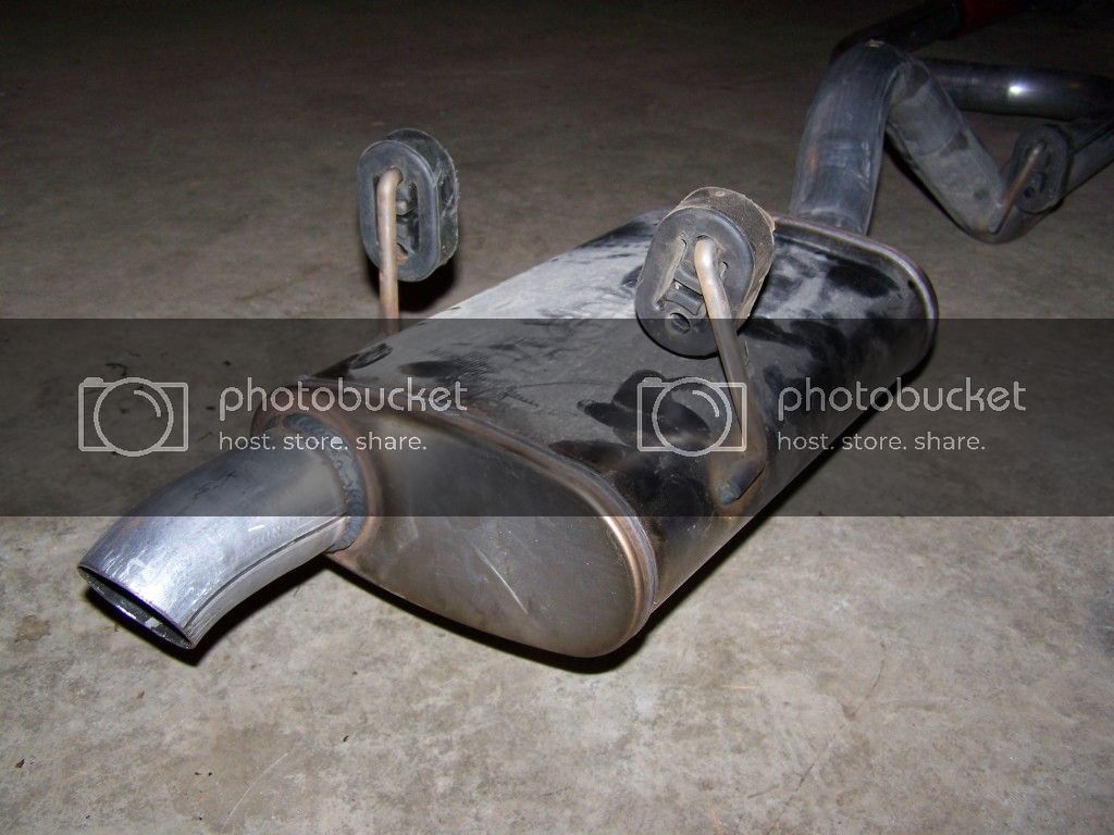

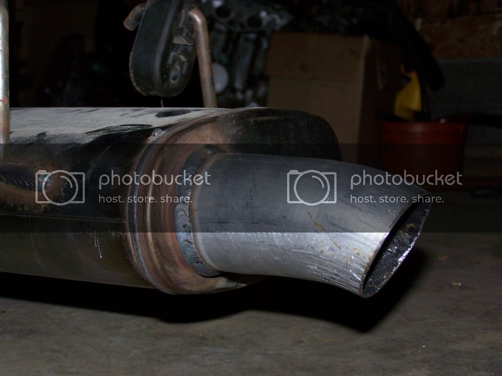

2.5" Custom built exhaust. Glasspack - crush bends (price was right) - Magnaflow muffler (Locally built (Met a great guy), $400 included tig welding to fix my header...header lasted a week and had to take the exhaust off... Sounded amazing, super quiet low tone and looked great behind the car)
JDM turn down style, all the pros do it.

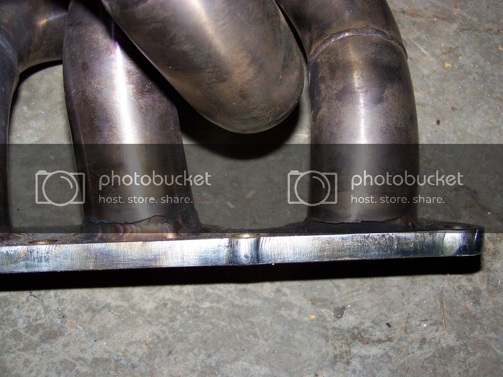

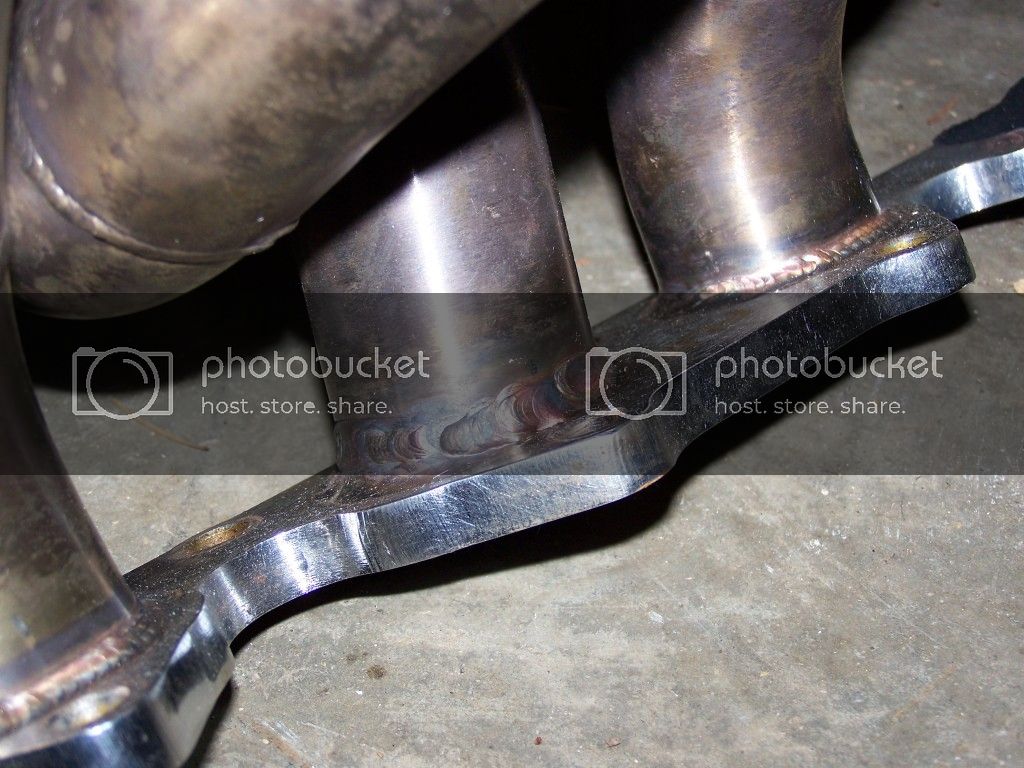

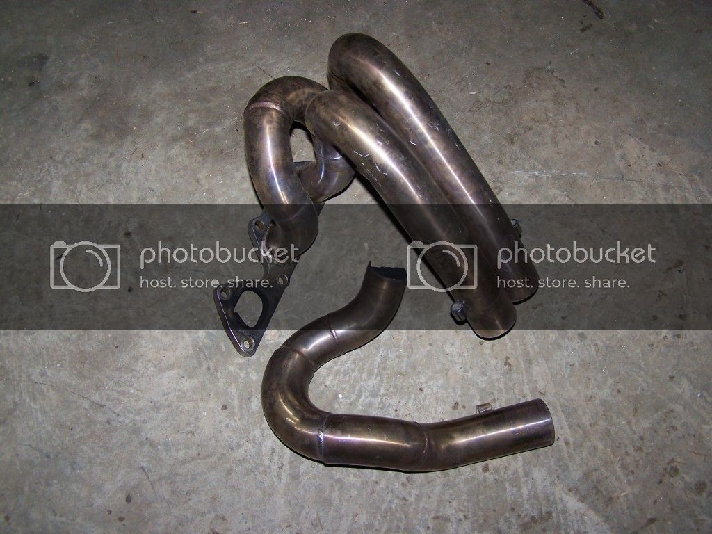

My broken header...bought new when built the car, lasted a couple months, cylinder no.2 tube snaps off the flange. Couple more months go by with an LS header (In search of a cheap tig welder). Found what I was looking for and he made me the exhaust at the same time. A week goes by with everything great then cylinders 1+2 crack and no. 4 breaks completely off. Plus the bracket on the bottom ripped off and made a hole in the downpipe... :bs:
did you ever get ahold of the people you got it from?? theres something seriously wrong if it broke twice.
I'm guessing the bracket did the damage.

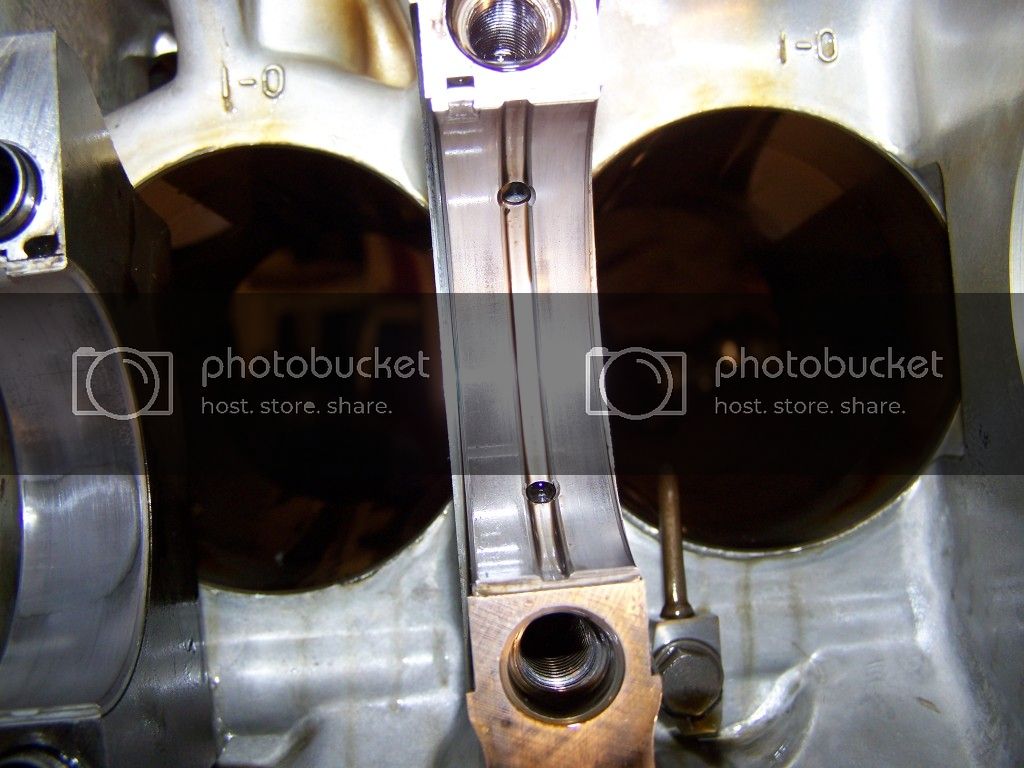

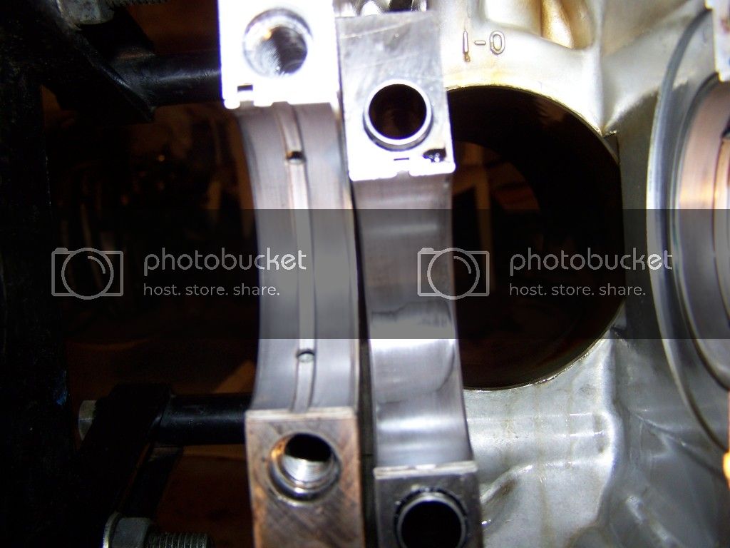

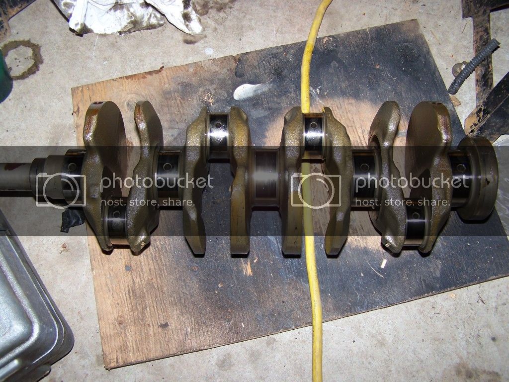

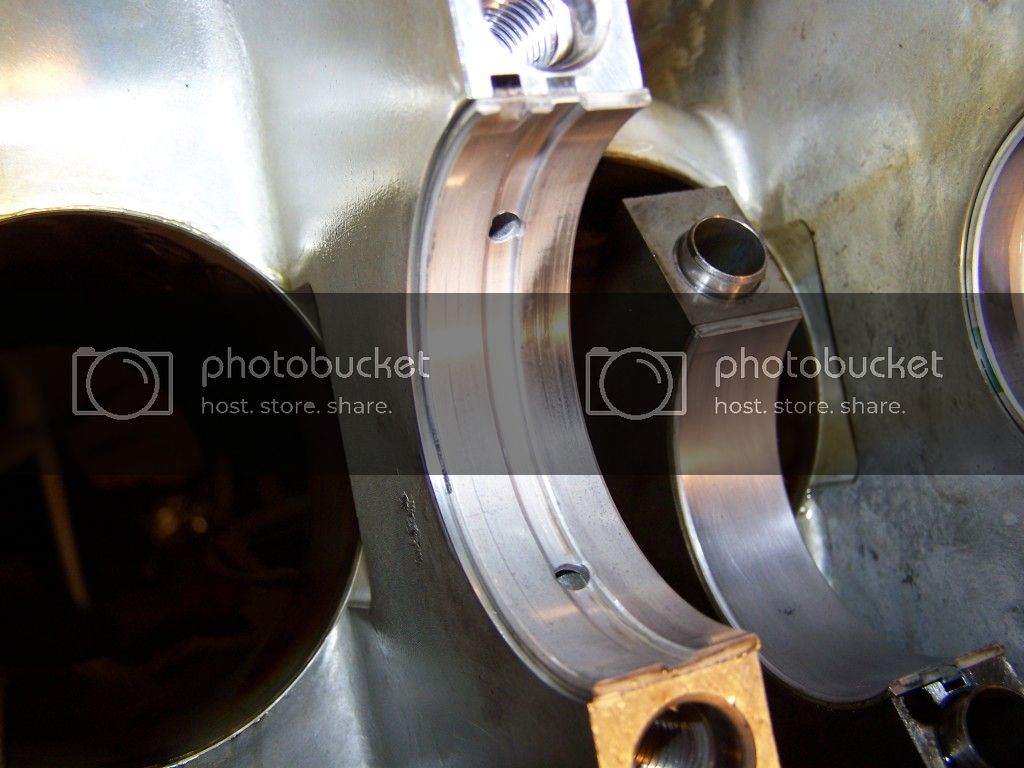

My dad and I tore the block apart tonight. Everything looks great! I shal be dropping off the block, crank, crank caps and pistons/rods tomorrow.
Crank is sooo mint.

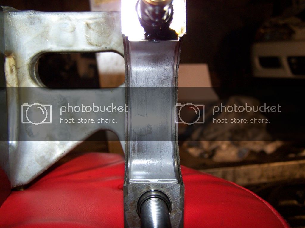

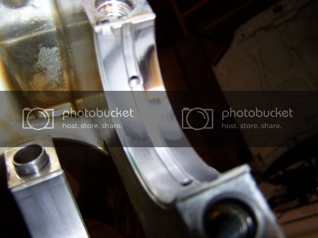

Minimal to no wear on most bearings.
The only "bad" bearing showing some bronze. Closest to the flywheel.
I got some positive feedback from the machine shop today. They will be sizing up the proper bearings/pistons/rings then assembling the whole block. It sounds like they may have to oversize the pistons :( more money...

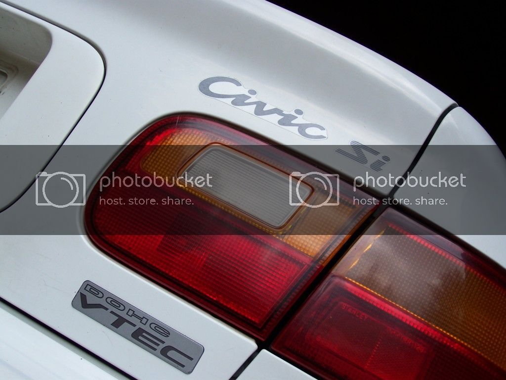

Looks good. I like the Doe-Hawk VTAK emblem.......clean.
I snagged it off Matts GSR parts car. Shes officially a Civic GSR now lol.
The machine shop told me the no.3 cylinder went a bit oval (not round at least) so with parts and a new bore with oversize pistons I'm over the $1g note...still a stock bottom end... lol oh well.
