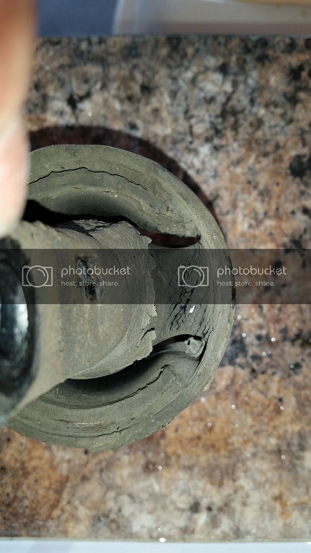

My RTA Bushings were fine....yeah, right.

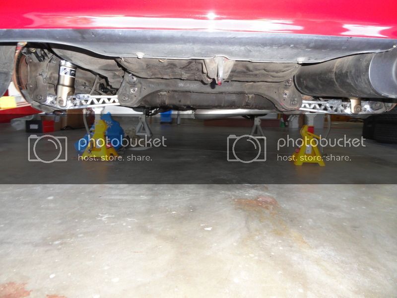

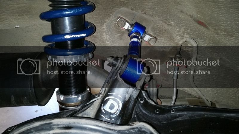

Rear End is almost done. All Bushings are in, new coilovers, new hardrace camber kits, new LCA's and new Goodridge brake lines. Still need brace and sway installed.
Did you replace them with polyurethane bushings? It'll make a huge difference on how it drives and handles changing the worn out bushings - you're going to like it. :)
I bought a complete Hardrace Bushing Kit. All rubber but stiffer than OEM. After my research....I chose their rubber over polyurethane. It will be a nice improvement none the less. All the new parts will make it feel like it's on rails compared to my worn out previous set up.

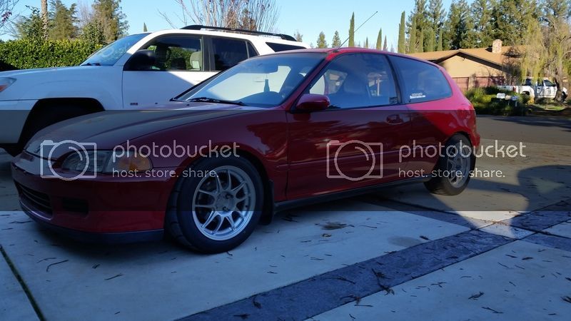

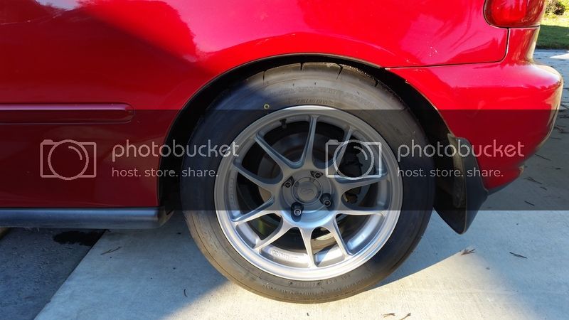

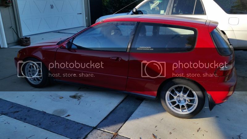

Got some stuff done.....finally. Brakes bled and set it on the ground for the 1st time in a while. Not sure if I'm happy with the rear height. I'm thinking of a little lower. I'm concerned with function.....not looks.
[/URL
looks great - i would leave the ride height alone until you put some miles on it. it can settle down a bit more.
Thanks guys!

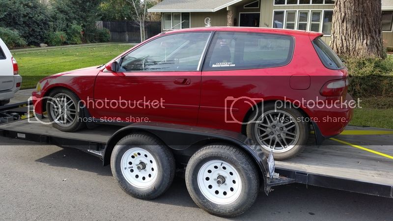

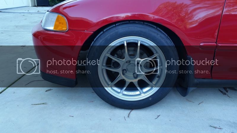

Front end is about 7/16-1/2" higher. I can get on my tilt trailer pretty easy (with a few 2' 2x6s).
I think I found a race shop to do my alignment. They're about 1hr away.

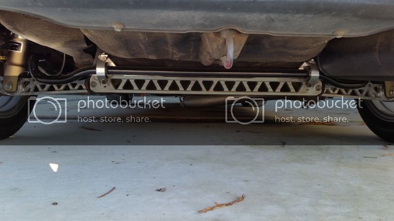

park it on a level surface and get a pic of the rear from the ground showing the rear lower control arms
perfect... just wanted to see the angle of the LCAs, i would not go any lower than that
I'm thinking I'll keep th height where it is. I was only wanting 1/4" lower. With these AMR coilovers, it's a hassle to raise/lower compared to the stereotypical coilover adjusting. I have to lossen bottom collar, disconnect coilover from LCA, adjust height of coilover, reinstall to LCA, and tighten lower collar.
