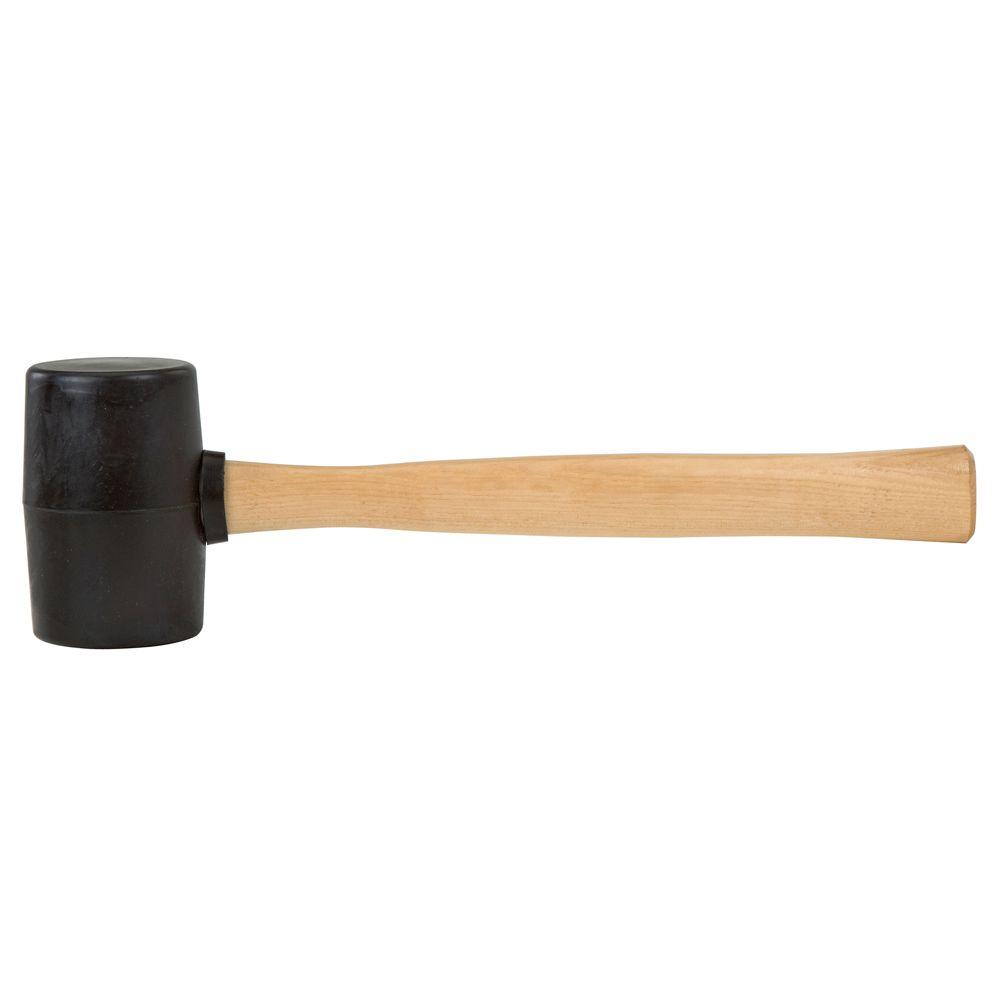

Pretty sure the hood don't shut. Its super close and maybe I can just drop the hood and send it but I'm hesitant. Done for the day.
Ha. Pound out some clearance while keeping things symmetrical. Right in my wheel house.
