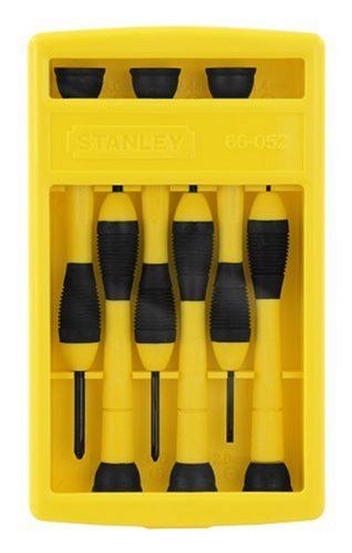

Easy...take the smallest flathead, push it into the slot you wanna remove a wire from this will push the locking tab down, the wire will pull out now, then carefully bend the locking tab back up and reinsert. This last step takes finesse, they break easily...GL
