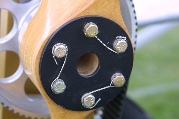

Flywheel bolts loose?
Did you safety wire them?
I don't recall the bolts on my D16A6 or ZC being drilled to accept safety wire. When I assembled the ZC and installed the flywheel it was recommended by the machine shop that did the work on the engine to use a liquid thread locker on the flywheel bolts. I used Red Loctite on the bolts per advice from machine shop. Threads were prepped with lacquer thinner to clean them.
They aren't drilled for it. You have to drill them yourself or buy them pre-drilled (wickedfuckinexpensive). I have never heard of anyone safety wiring flywheel bolts for a street application. Loctite is sufficient.
