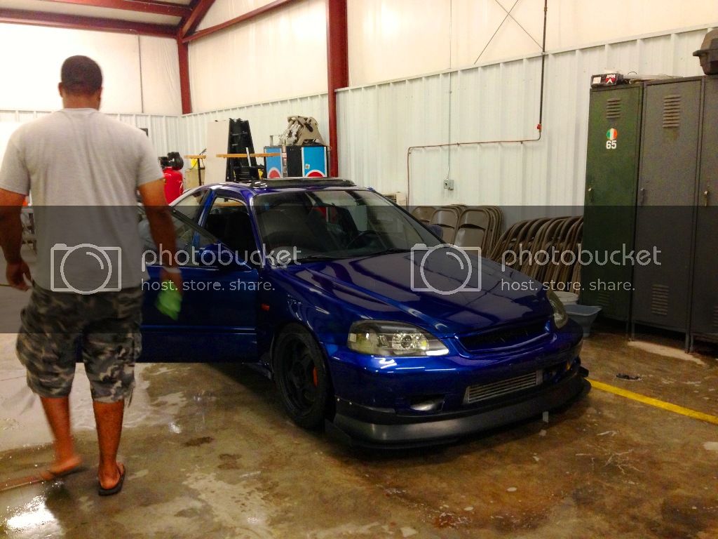

Well sorry everyone for not posting on here in forever but I do have some updates to share. I've gotten a lot accomplished in the last 3 months, been to some car shows, done some racing and tore up some shit! lol
Getting ready to go racing and to some car shows!!
Messed up my lip while at a High Performance Driving Event, but still managed to get a plaque at the car show lol!!

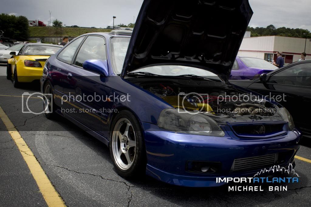

Then went on to the We Hungry Meet, had a good turnout although it was raining. My driver's side window is off the track so myself and the interior got soaked!!
Had a lot of fun this weekend, but after seeing some of the other nice cars that came out I knew that I needed to change things up a bit. Plus after going to another driving event I totally tore and ran over my front lip, so I had no other excuses.

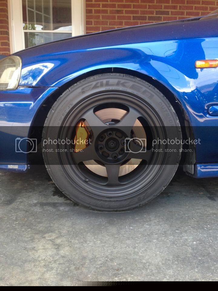

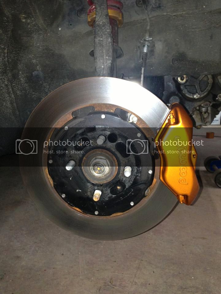

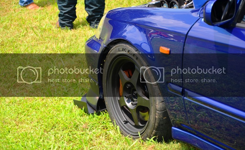

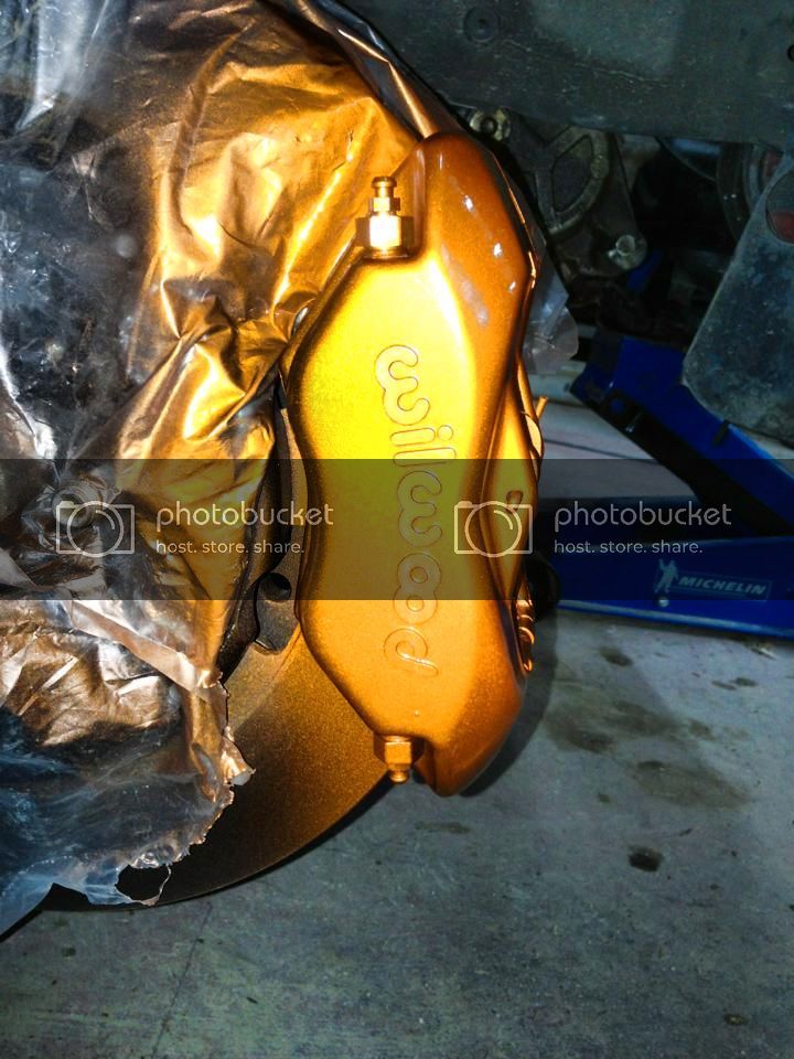

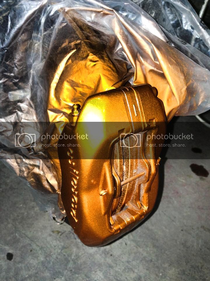

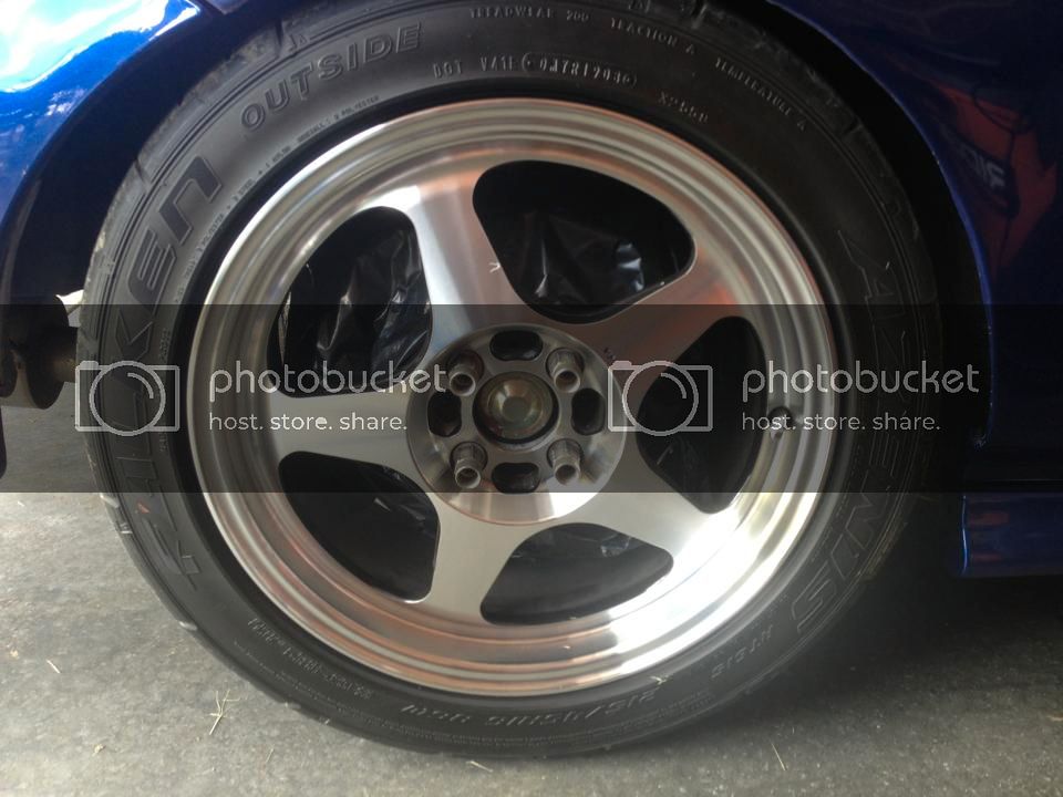

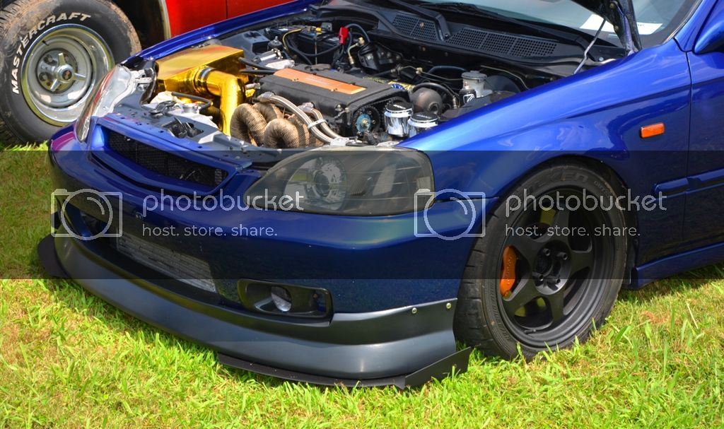

So I started with my front calipers that were bland and not noticed, so I sprayed them a metallic gold/orangish color lol. Really matched my side markers that I also installed.

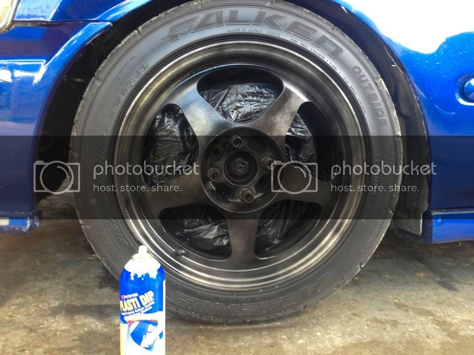

Then it was time to pull out the plasti dip and get to spraying.
Really brings out the color of the calipers and plus I was just tired of looking at polished all the time.

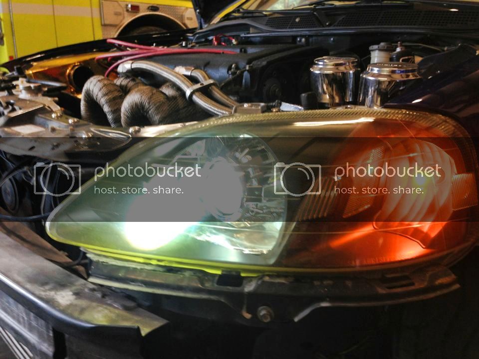

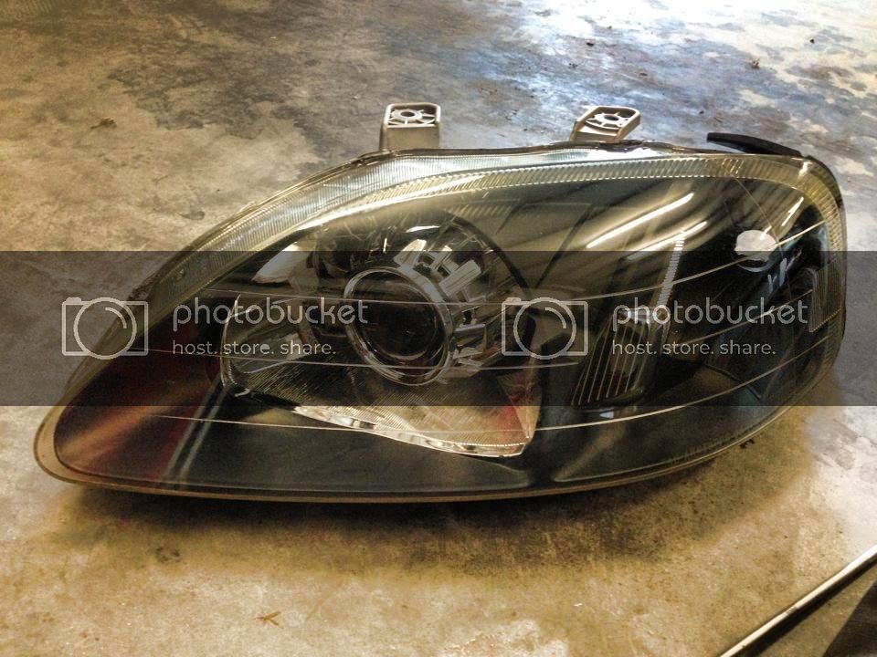

Next up was a projector retrofit that I had laying around the house for like 3 months lol. These were really nice, got them from the retrofit source in Atlanta Ga. Big shout out to the Liberatariate for answering all of my questions.

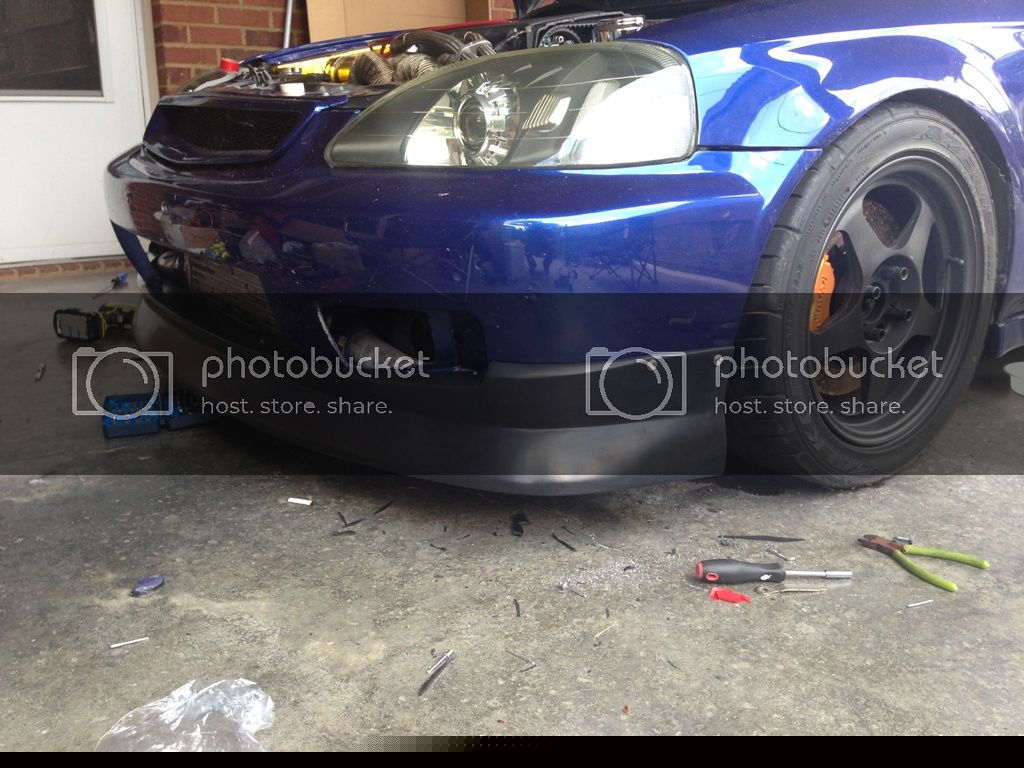

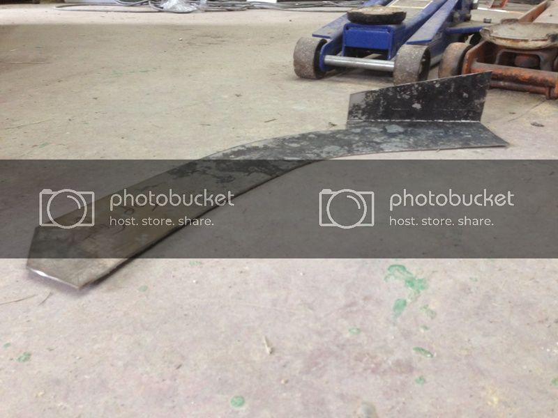

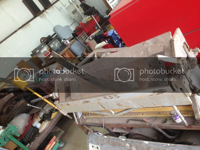

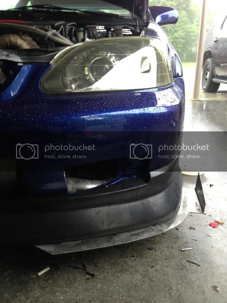

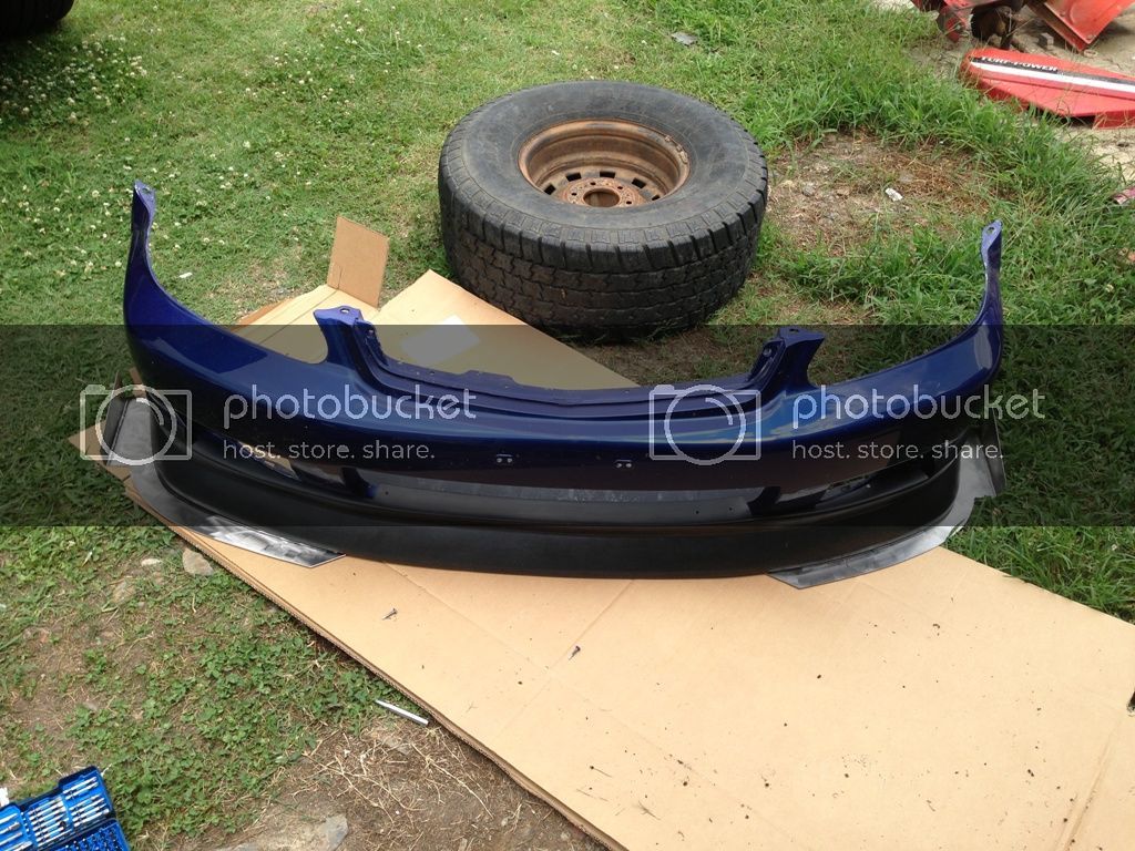

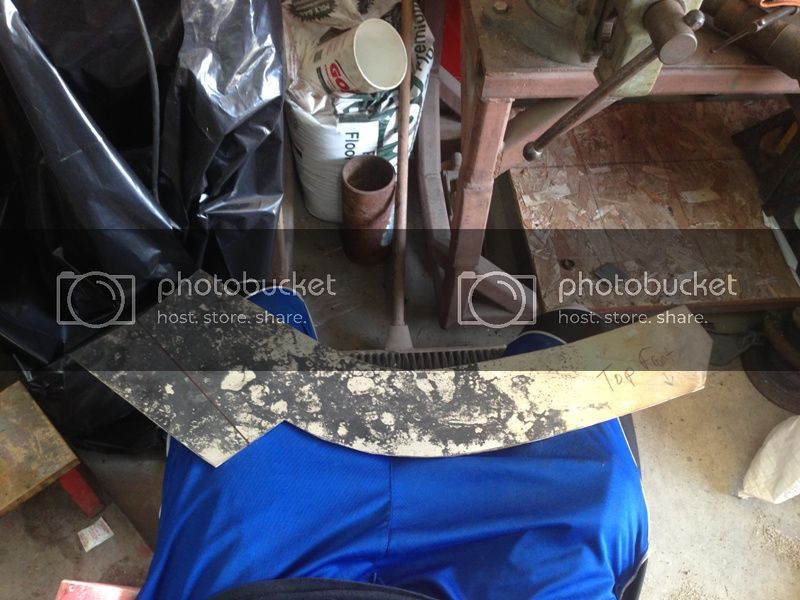

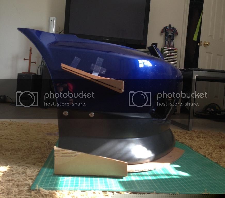

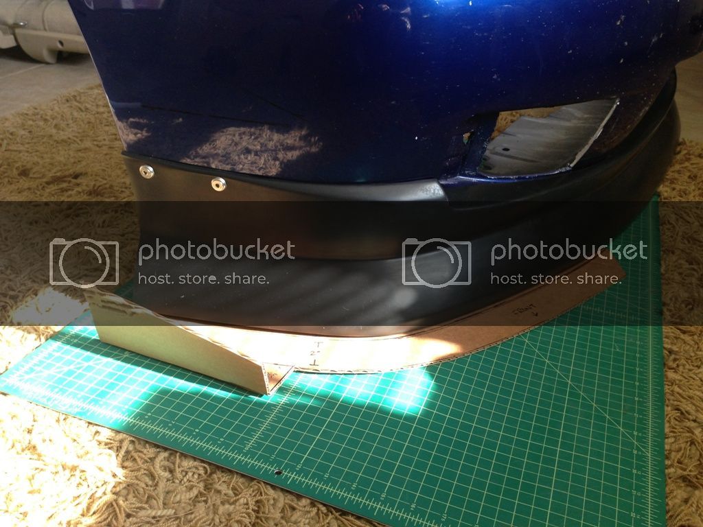

Then my new lip finally came in, is a Chargespeed Rep Lip. But I didn't just want to put a different lip on, I needed just a little bit more. I ended up after doing a little research on front splitters and winglets, started fabricating my own out of stainless steel. Really love the look of the front in now. The lip is still black for now, as I'm trying to see if it will grow on me. If it doesn't I will color match it to the rest of the car.

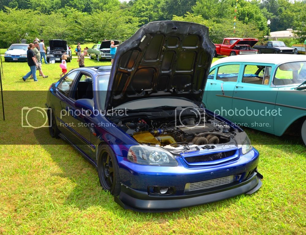

So after this I applied some plasti dip just to see how it would come out then cleaned it up for a car show the next day.

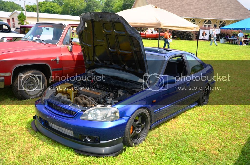

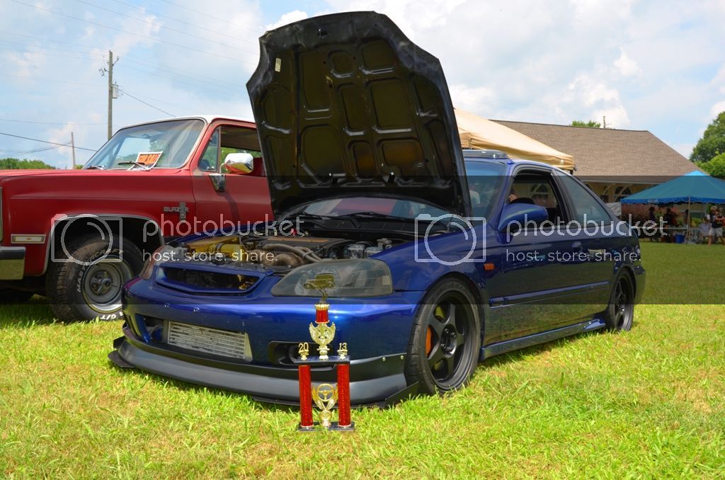

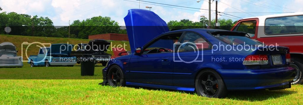

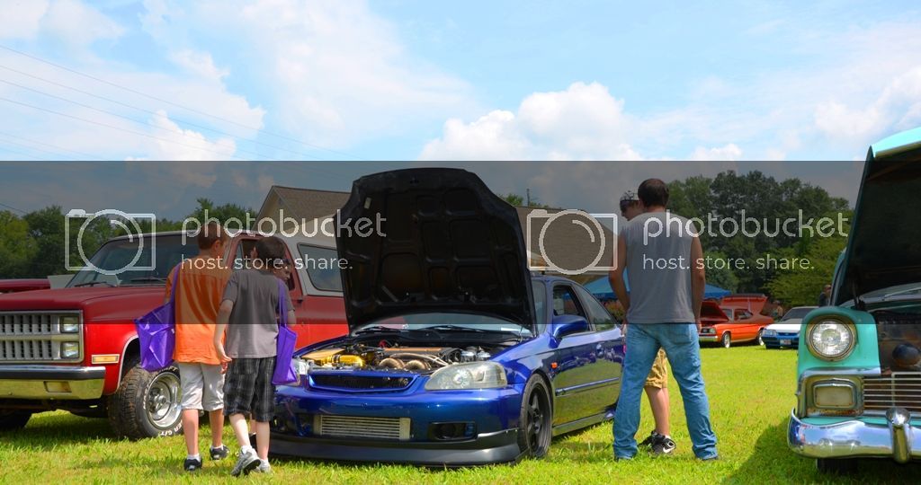

The next day I went to the car show that was intended for muscle cars only. I still entered my car because the money raised was for a good cause. Anyway I ended up placing in the top ten and took home a trophy. Got a lot of respect from the muscle car guys which was surprising.

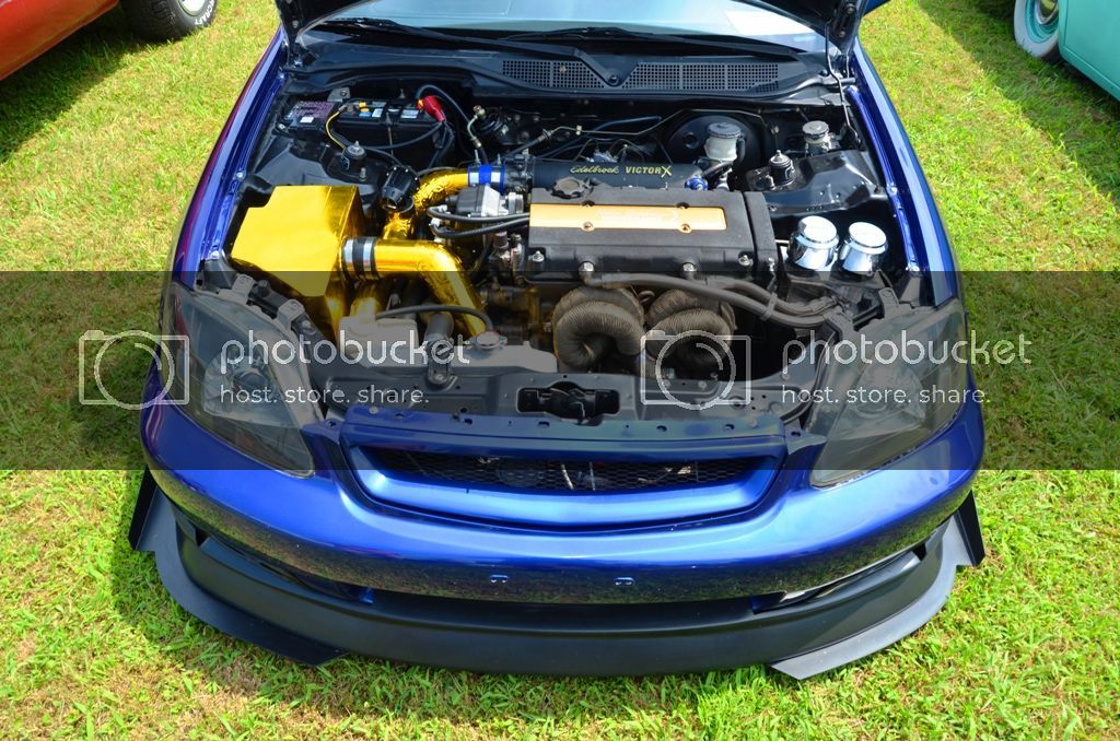

Ok now the next order of business was to have Mainstream fabricate me a valve cover ventilation/catch can system for the boost to come!!
Lines and catch can mocked up:
Valve cover stripped and prepped for some welding:
Ok now that the ventilation system was taken care of it was now time to swap the Skunk2 intake manifold for an Edeldbrock piece:
End results:
Next up was mounting of the intercooler and some modifications to the intercooler piping to get everything to fit snug. I got the intercooler off of ebay and the dimensions are 28x8x3.

Next was the tune which Scotty @ Mainstream did for me. Setup ended up making 360hp @ 14-15lbs. The turbo responds very quickly and was at full spool around 4k rpm. The boost comes in real smooth and has a very broad power band. We tried to go higher (19psi) but the waste gate spring (6lbs) said hell no. No worries because very soon I'll be purchasing some cams, valve train, throttle body, equal length mani and some other crap that I can't remember then I'll retune and see where I'm at. I am very happy with the power output or hp per dollar spent. At 300hp (9-10psi) the car is a beast (ripped the welded driver's side motor mount 3 times and counting). So don't hate on the egay to bad, when this turbo decides that it wants to take a poop, I'll replace it with a 60-1 Garrett variant FTW!! I don't have any pics from the dyno but as soon as I'm done posting this thread I'll upload them to Youtube and edit in a link.
