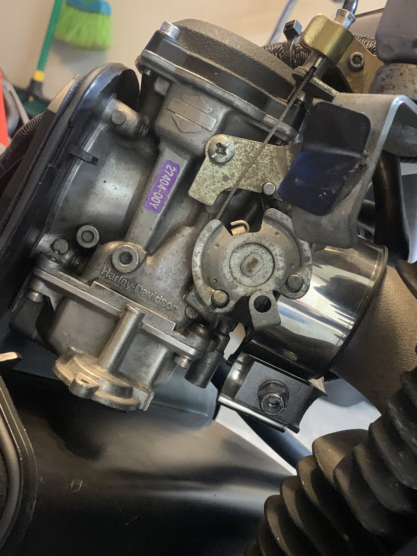

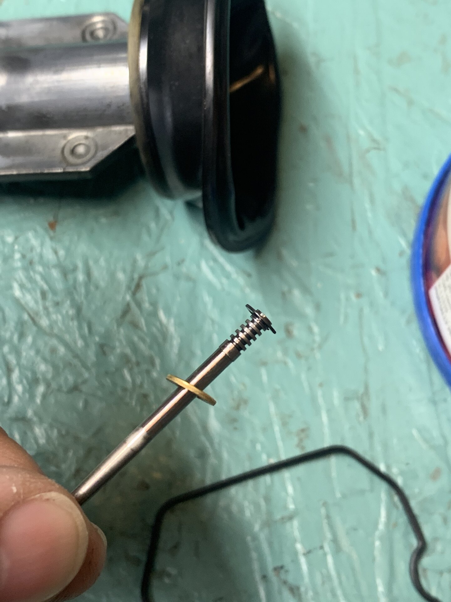

my father said the same thing. but there are like 30 different cv40 aftermarket needles. i cant see why it had an aftermarket needle and no jets, with mods.

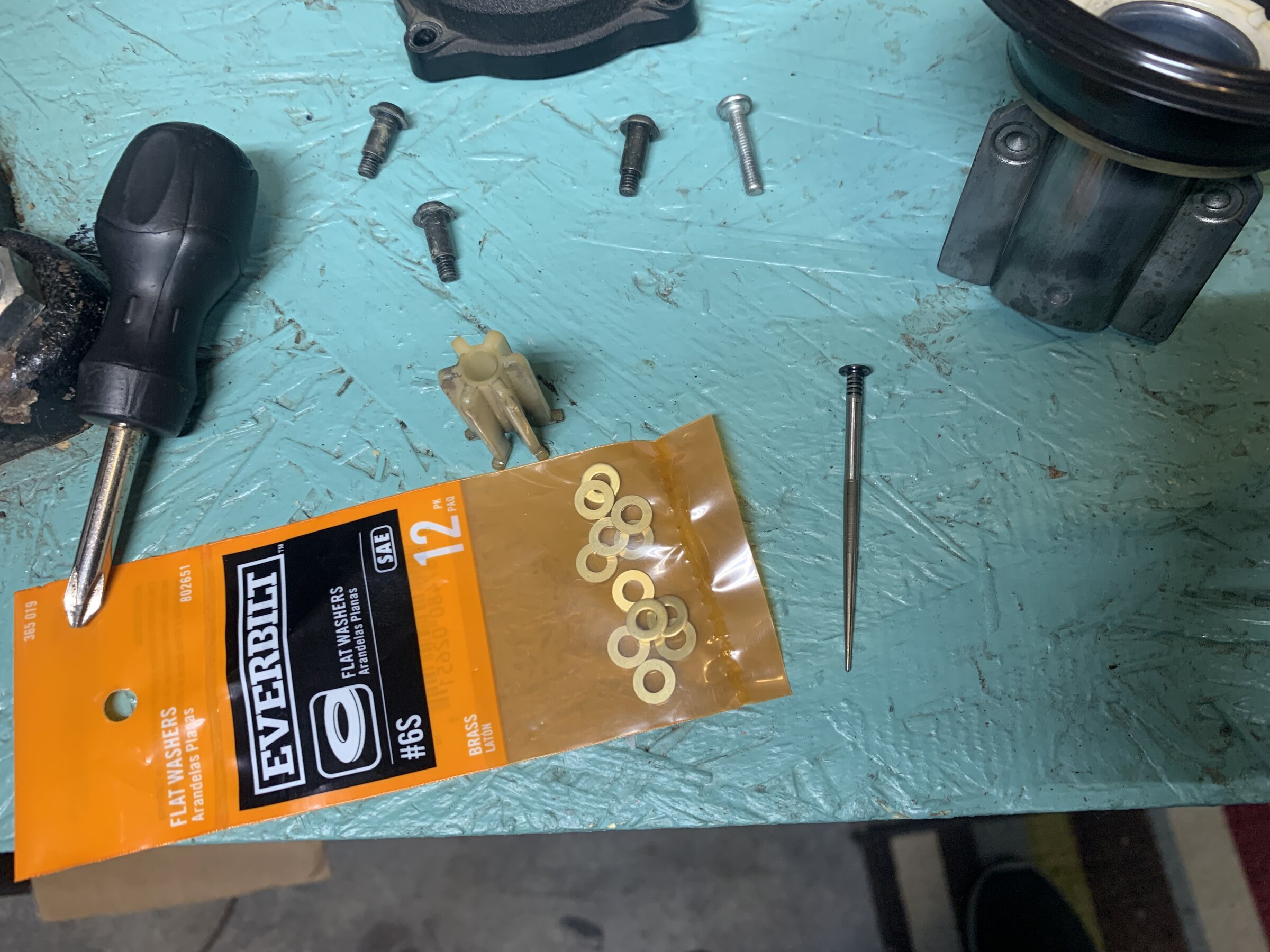

it was just easier to return it to zero and shim it lol i was trying to measure the graduations, i think they were .06 each. i needed .05 at max. i got .03 .
There's more than 30... Lol.
It had an aftermarket needle because that's standard off-the-shelf parts for a cv40. I would have put it on the second clip and checked it. I bet it'd run slightly cooler. :P
that may make total sense for you, but most of the stock harley carbs dont have an adjustable needle.

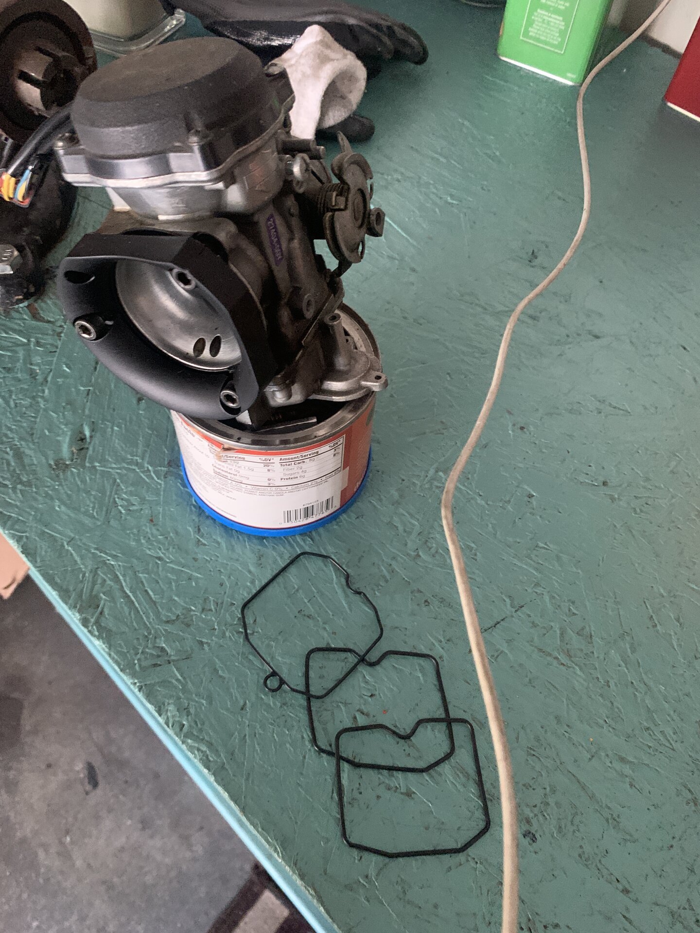

Well we are good to go! I buttoned this sucker up. The tach works. No fuel leaks and the throttle tip in stumble is gone. After the first startup I let it sit a bit and t started right up. Before it would take some time to get going.

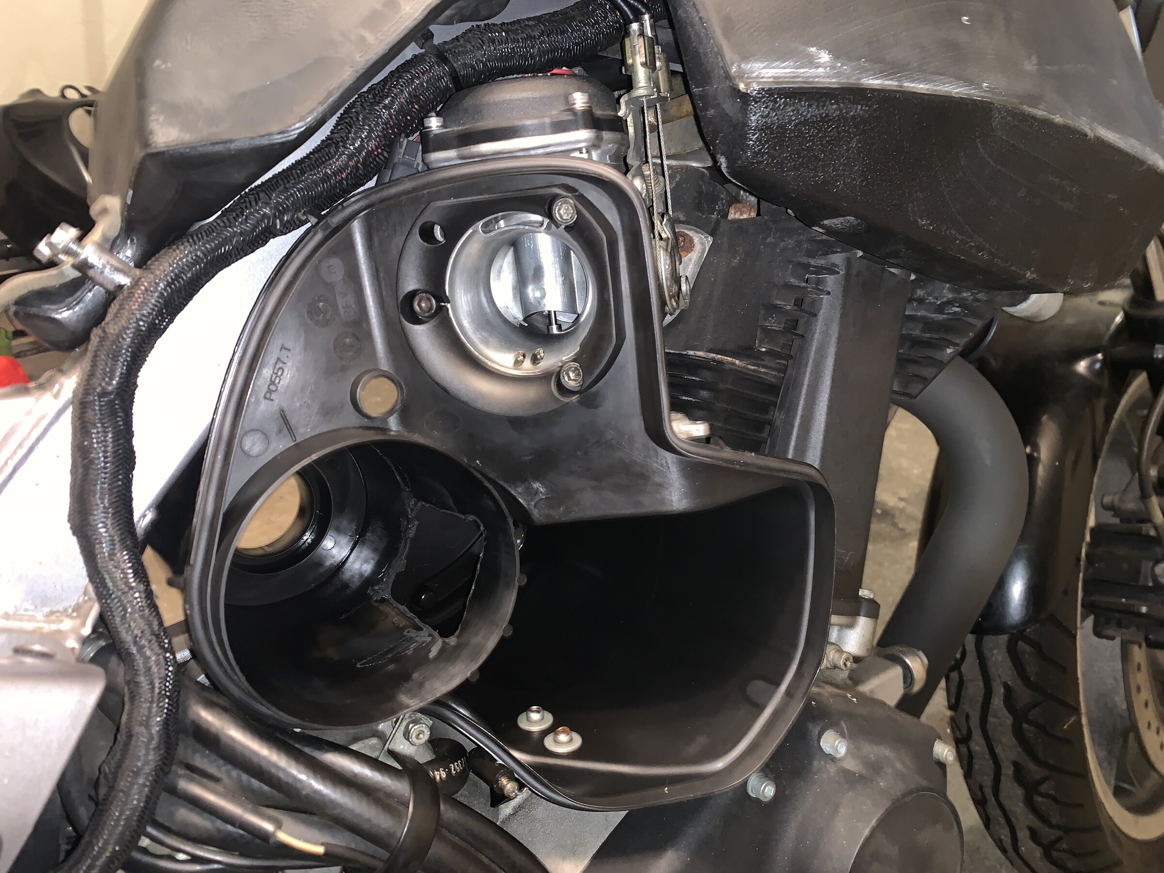

then I had to take it apart again since I forgot to put the air filter back in. The new airbox gasket makes it really hard to get the clips on and off !
