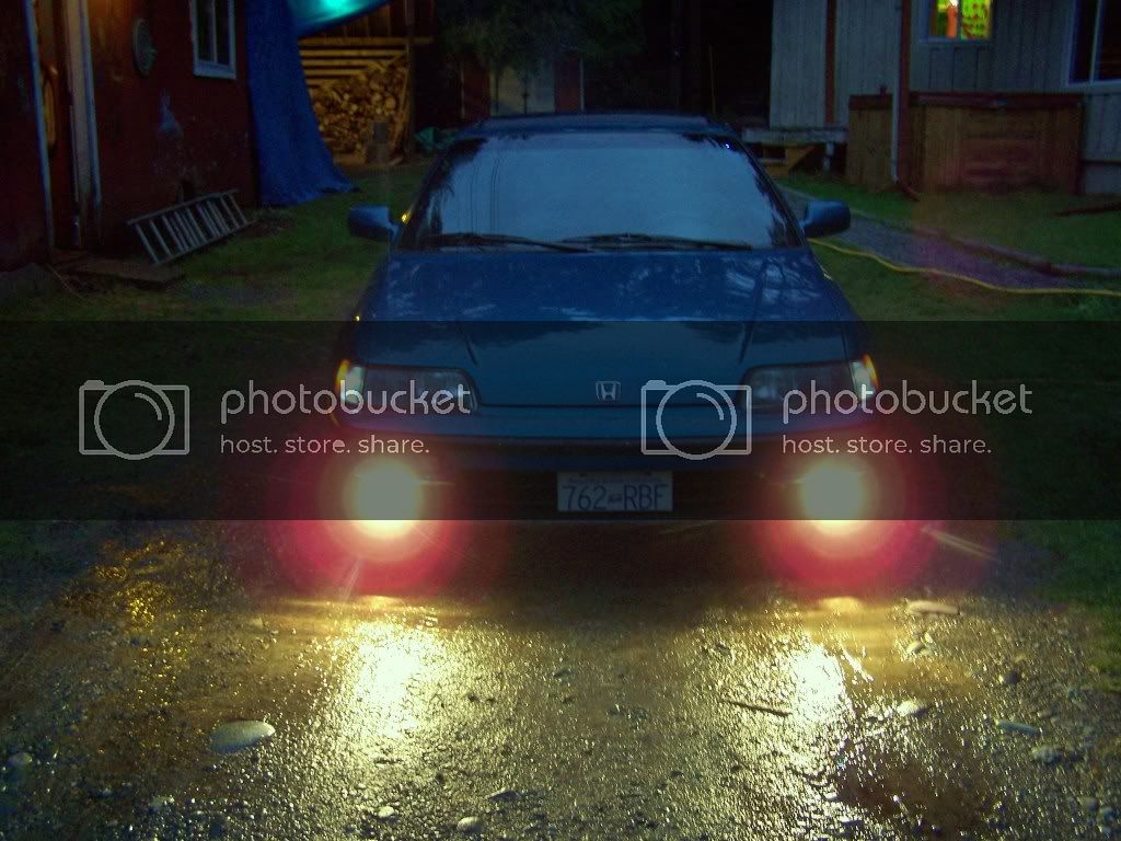

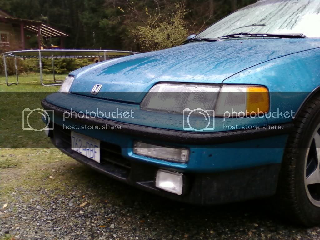

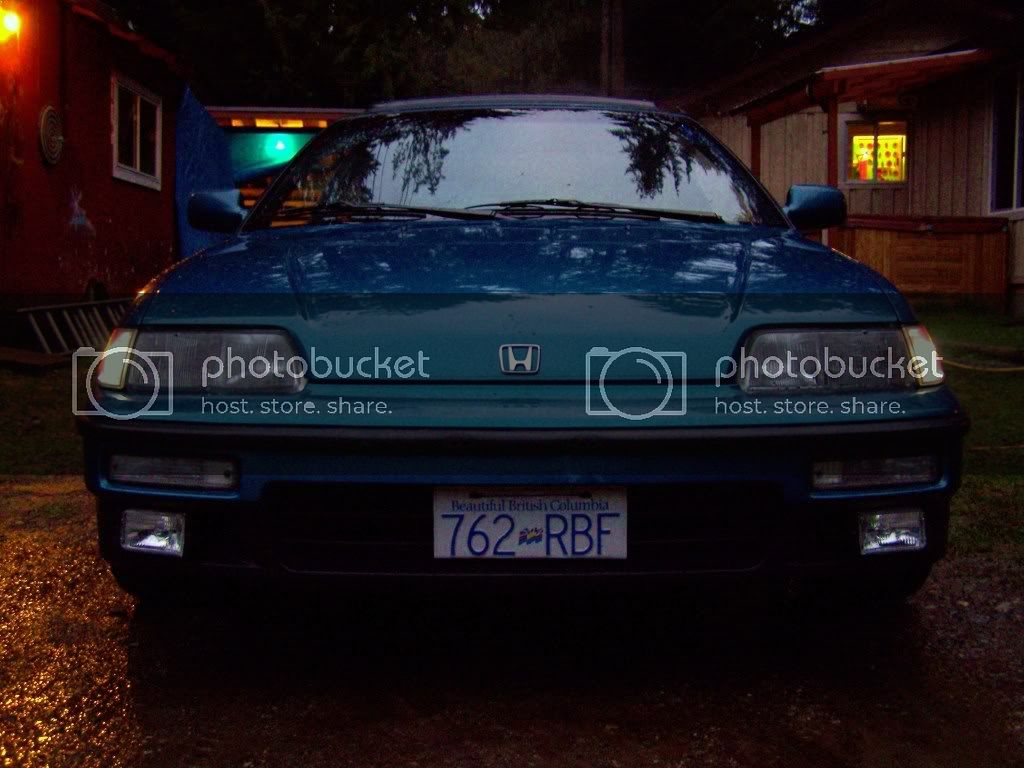

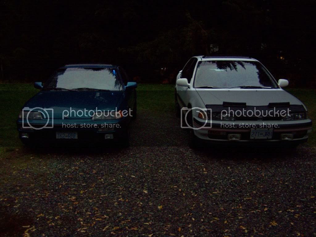

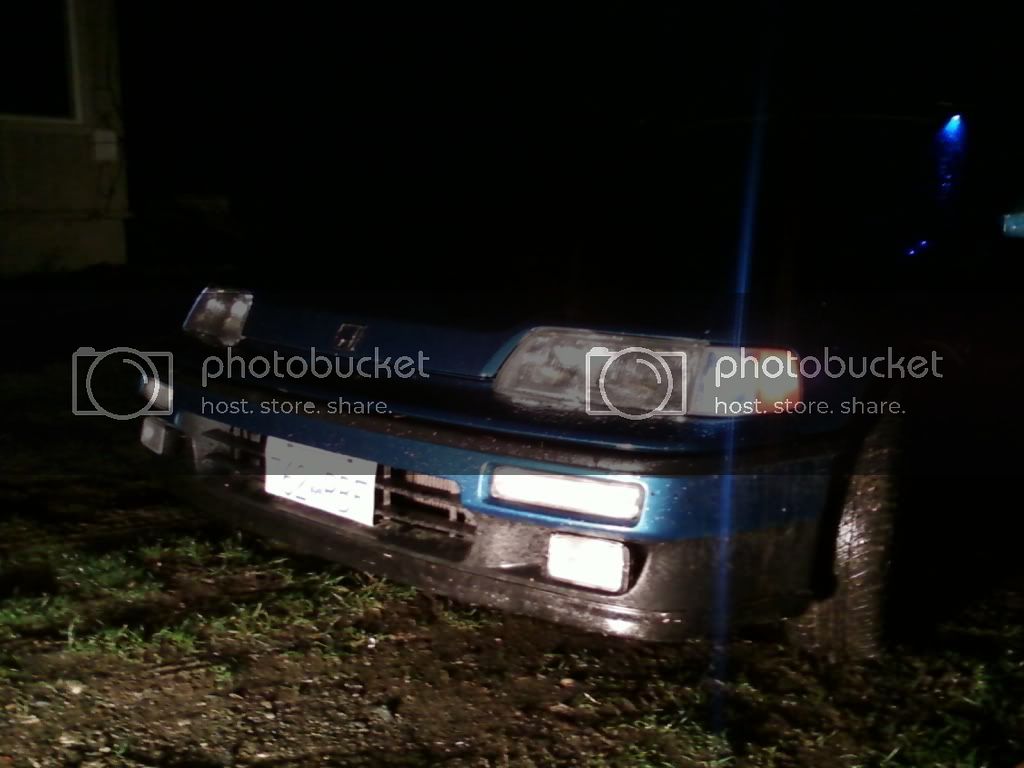

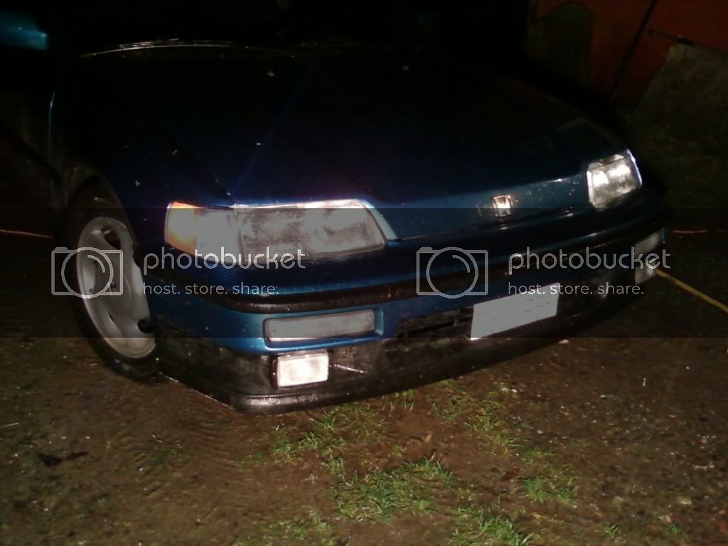

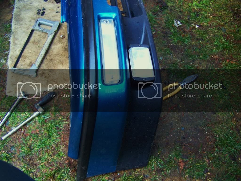

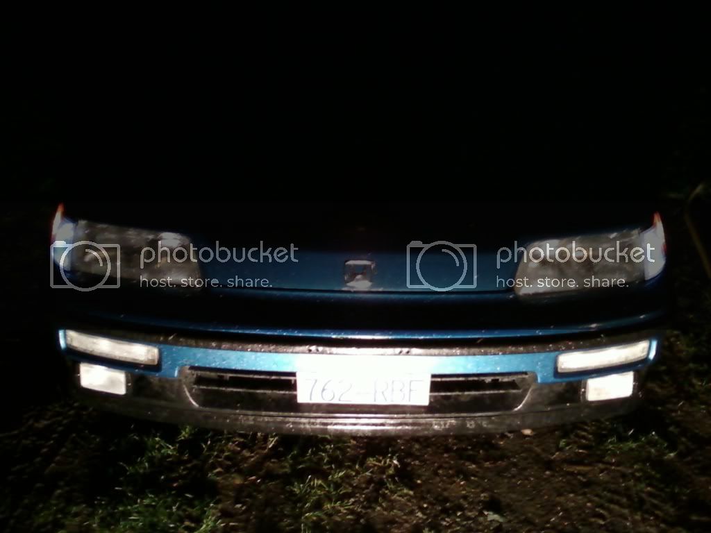

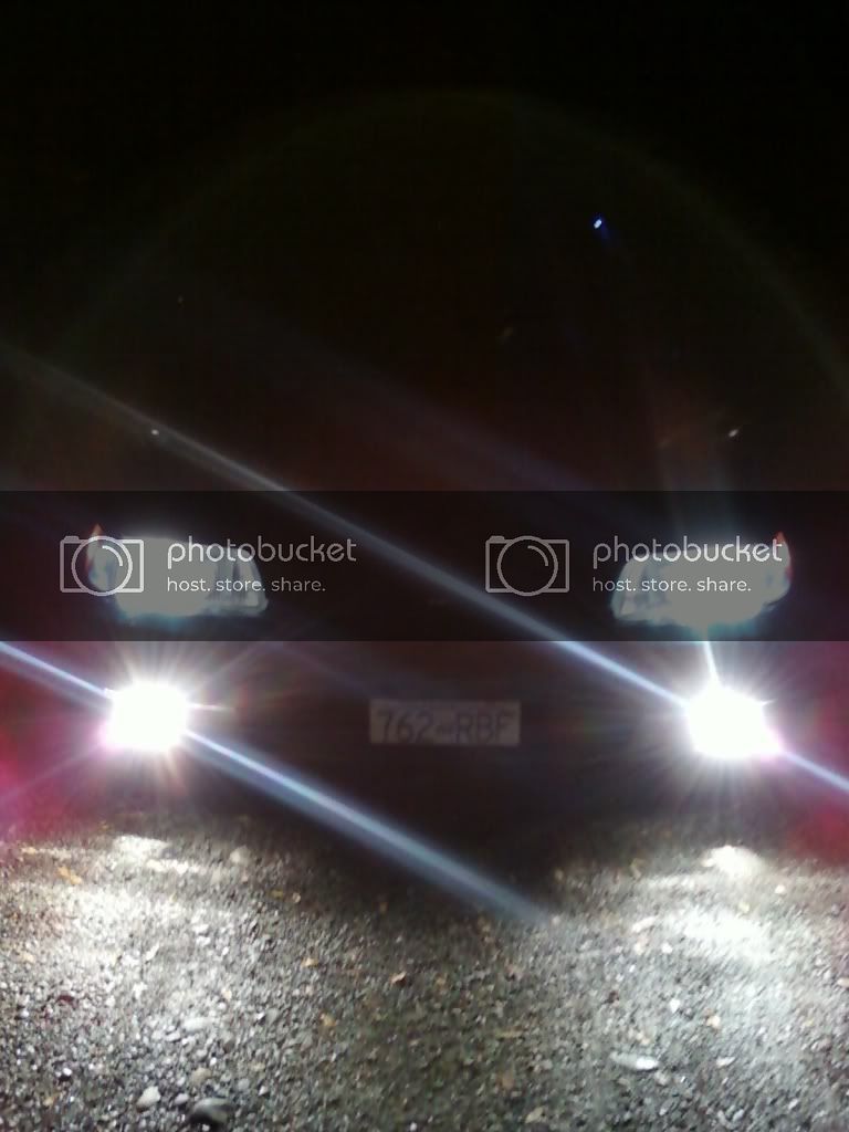

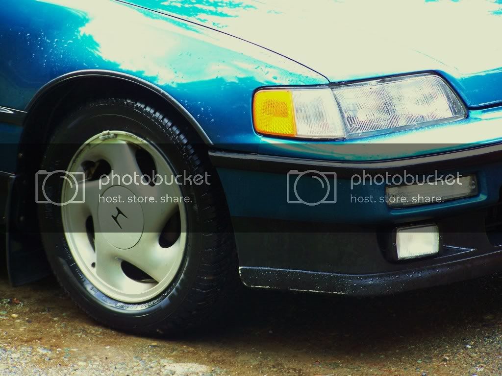

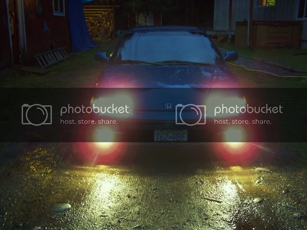

I installed some cheap-o (free) fog lights today. I drilled a hole in the back of the light and in the bumper pocket then put a bolt inbetween. When I find some nicer fogs I'll probably cut out the pocket and use a bracket. We did the Accord too.

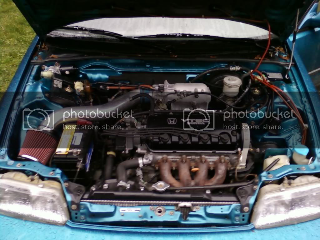

My B16 was doing that when I first got it, idled at 1500 and if you plugged the bottom hole it would idle fine, I got some gasket material and made a gasket that blocked that hole off.
