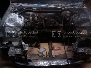

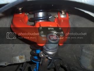

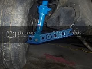

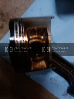

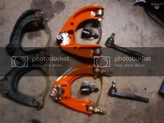

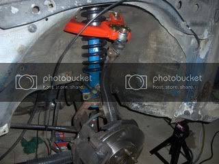

Hey guys, been awhile again, but been doing some moving around at work and havent had a lot of time to post, but I have been working on the crx lately. Got a lot of new parts in and a lot of work done on the suspension and the motor. As far as the motor goes, I have it all the way stripped down to the bare block and is ready to be shipped out to get sleeved (I am going to have to do some saving before I ship it out though), and then its off to a local machine shop to be bored. When I pulled the pistons out of the block the groves where the piston rings sit actually fell apart, is that caused by detonation? Anywho, the suspension is basically all done, only thing is I havent quite learned how to replace the lower ball joints yet, so I still need to do that ( I have them, just not installed). Also, I can not for the life of me get the tie rod ends to break loose, I have new ones of those but cant get them off.I also started sanding the engine bay so I can get that sprayed and start the wiring process, too. Aaaaand....pics :ph34r:
You can see in this picture the cracked piston dome.

Looking good. :thumbsup: Hit the tie rod ends with a little heat if need be.

w00t, got the tie rod ends off and replaced thanks to some crows feet.
