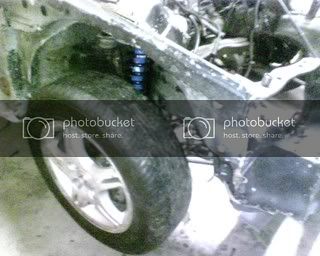

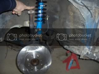

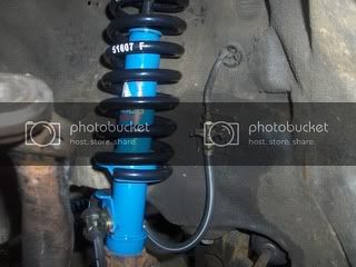

heres a little teaser for the driver side: new brakes,brake hoses,pads(not pictured),H&R springs,Tokico Blues

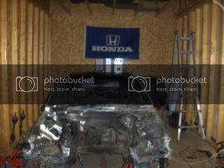

And a shot of the shop...
:thumbsup: on the Tokico Blues. They're nothing spectacular, but for the price, they get the job done well...

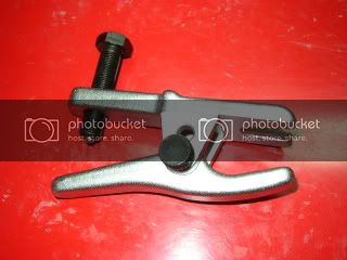

Finally got those bastards out! I ended up going to a store and looking at what they had to offer and found this!
Worked like a charm, only downside was that it shot the ball joints at high rates of speed at stuff in my garage.

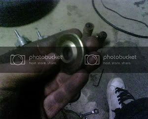

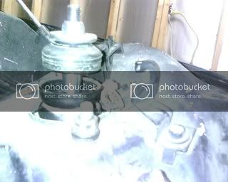

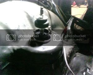

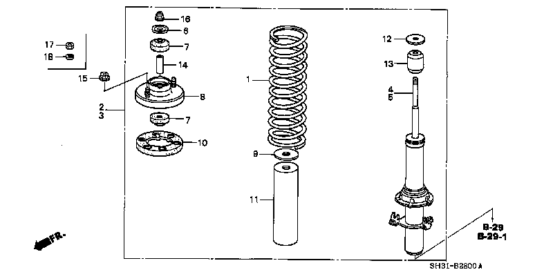

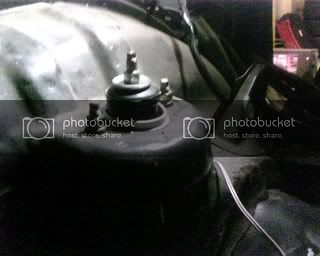

Heres a newb suspension question: Is this a result of the bushing on the shocks/struts being upside down?
You either are missing a washer or put it in the wrong place. (#12 is the one im talking about)
ill have to look at it when I get back to the shop tomorrow. So is the bushing being upside down ruled out?
when i put new tokico's on my prelude i had to use the washer off my old shocks. took me about three times of install/uninstall to get it right......by the time i was do ne i could pull them off and put them on in no time at all......lol so you might have to get the washers off your old shocks......
Ah shitty, those old things are so rusty, ill try to get em off. I wonder why they dont send the washers with the kit. Oh well, I have been super busy lately and havent gotten to work on her since then, so Ill keep ya guys updated.

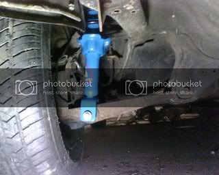

Alright guys, finally got some work done on the crx. I got a new truck and have been busy working on the brakes on that. But anyways, I figured out what was up with the suspension mess-up. It was in fact washer #12 so thanks for the pic. And heres some pics.
WEEERRRDDDD. Wish I had more money to do some more stuff :(
There we go...mucho better. :thumbsup:
