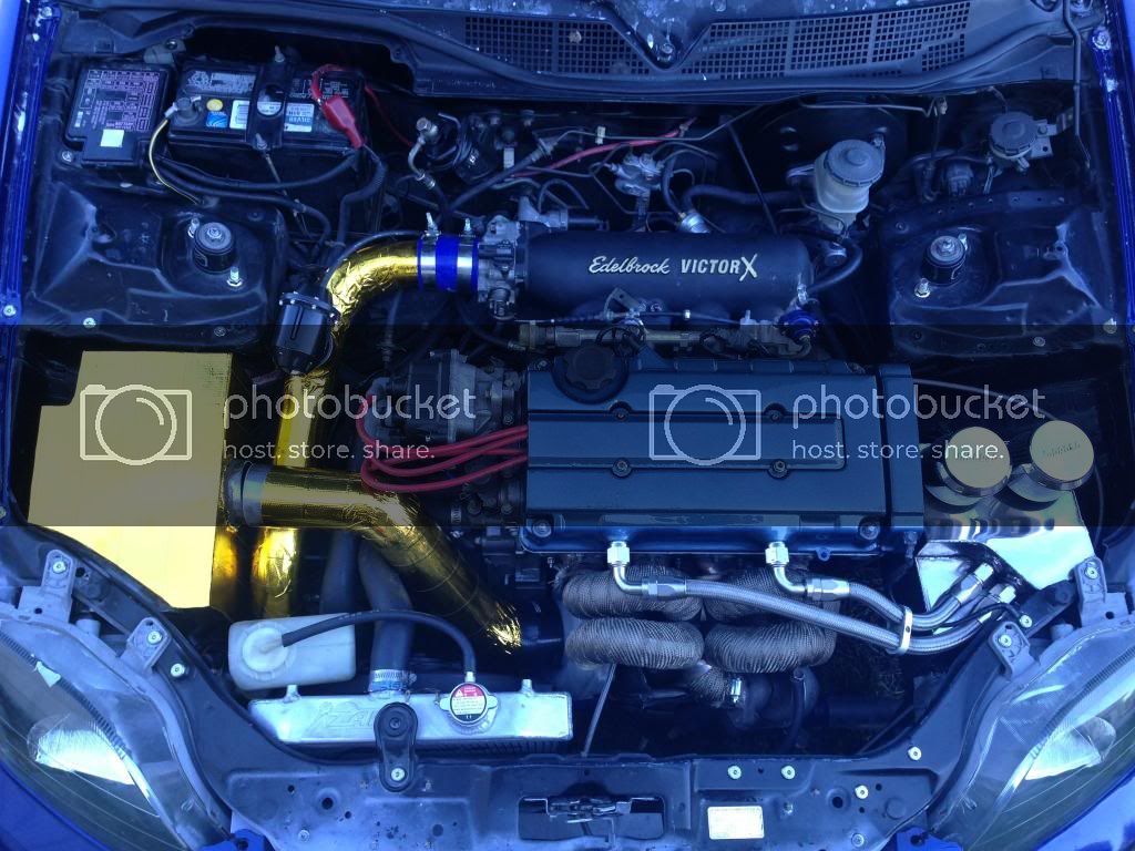

I'm going to be doing some testing on heat management to try and lower the overall under hood temperatures and reduce intake air temperatures using the reflect a gold, heat wrap and turbo blanket (thats still in the mail). I purchased two digital/cordless heat sensors with probes today so that I can do some before and after analysis. I'm going to start a totally different thread for this and I'll post a link in this thread. Anyway on to a couple of photos
BEFORE:
AFTER:
Got a couple goodies in the mail NRG quick release hub, turbo blanket and Phearable.net 70mm throttle body. Should have it all installed today, but have to do some testing for my Heat Management thread first.

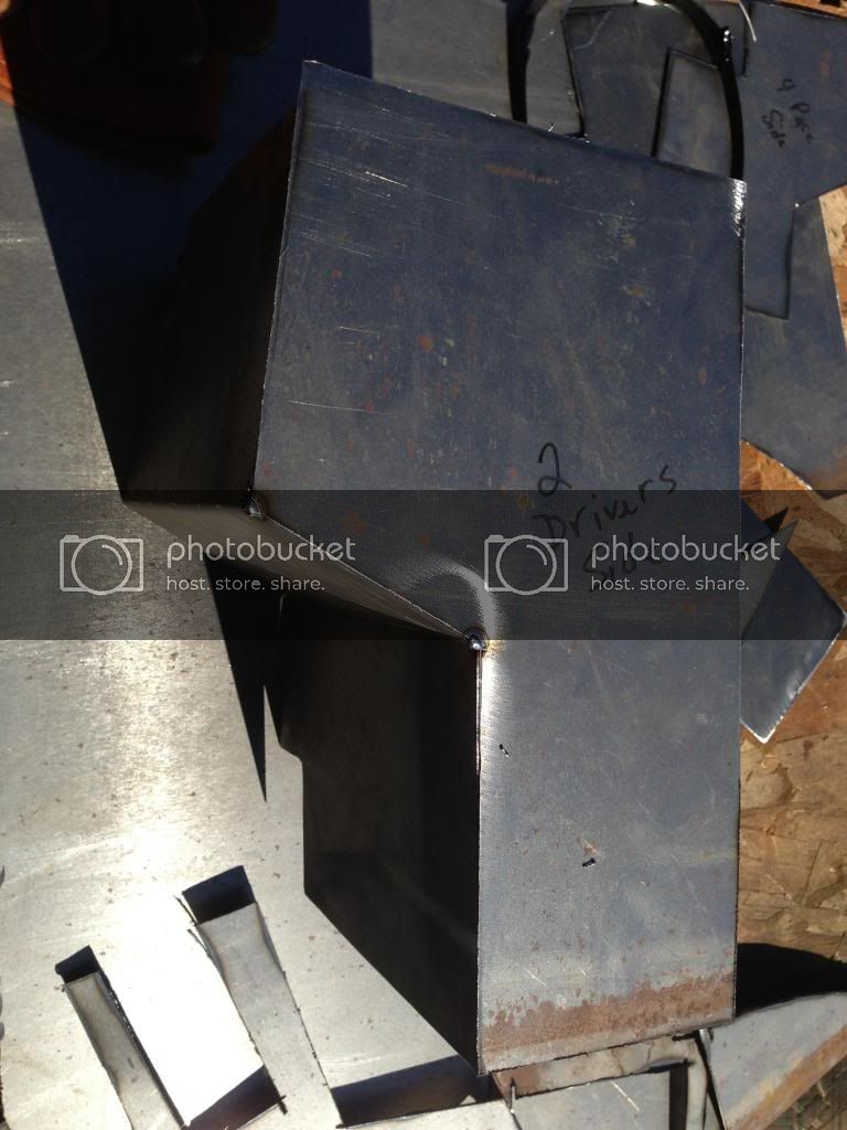

Have a few updates. I was able to build my Cold Air Intake box for my turbo this past weekend. Came out pretty nice. I made a template out of card board and then went back and transferred the template to some sheet metal that I had. All I have to do now is purchase a 3" hole saw and weld some tabs for mounting. I'm also going to fab some 3" piping from the intake box to my turbo. This should lower both my charge piping temperatures and intake air temperatures for sure! The intake box and pipe will be wrapped in the reflect a gold heat tape after more data is taken.
Keep checking back for more updates.
Got the cold air intake box done today, forgot to take a picture after I ran to autozone and grabbed another coupler, but its on there. Not really sure if my mind is playing tricks on me but it does feel like the car pulls a little different. I'm pulling fresh air from the frame rail right now, but I'm eventually going to run a pipe to the existing fog light housing for even colder air. On to the pics (oh yeah I ran out of the gold heat tape) and don't laugh at my crappy welding. Will have some data very soon to document any changes in my IAT's.
