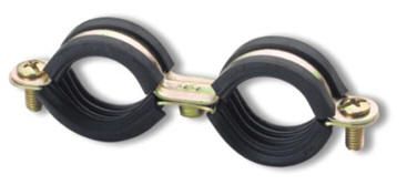

Be sure and strap all the lines down REAL good and shielding them is a great idea. Cuz ya never know.
im not going to use hard lines. i am going to use steel braided lines so no need to cover them. the brackets i have for them look like this
